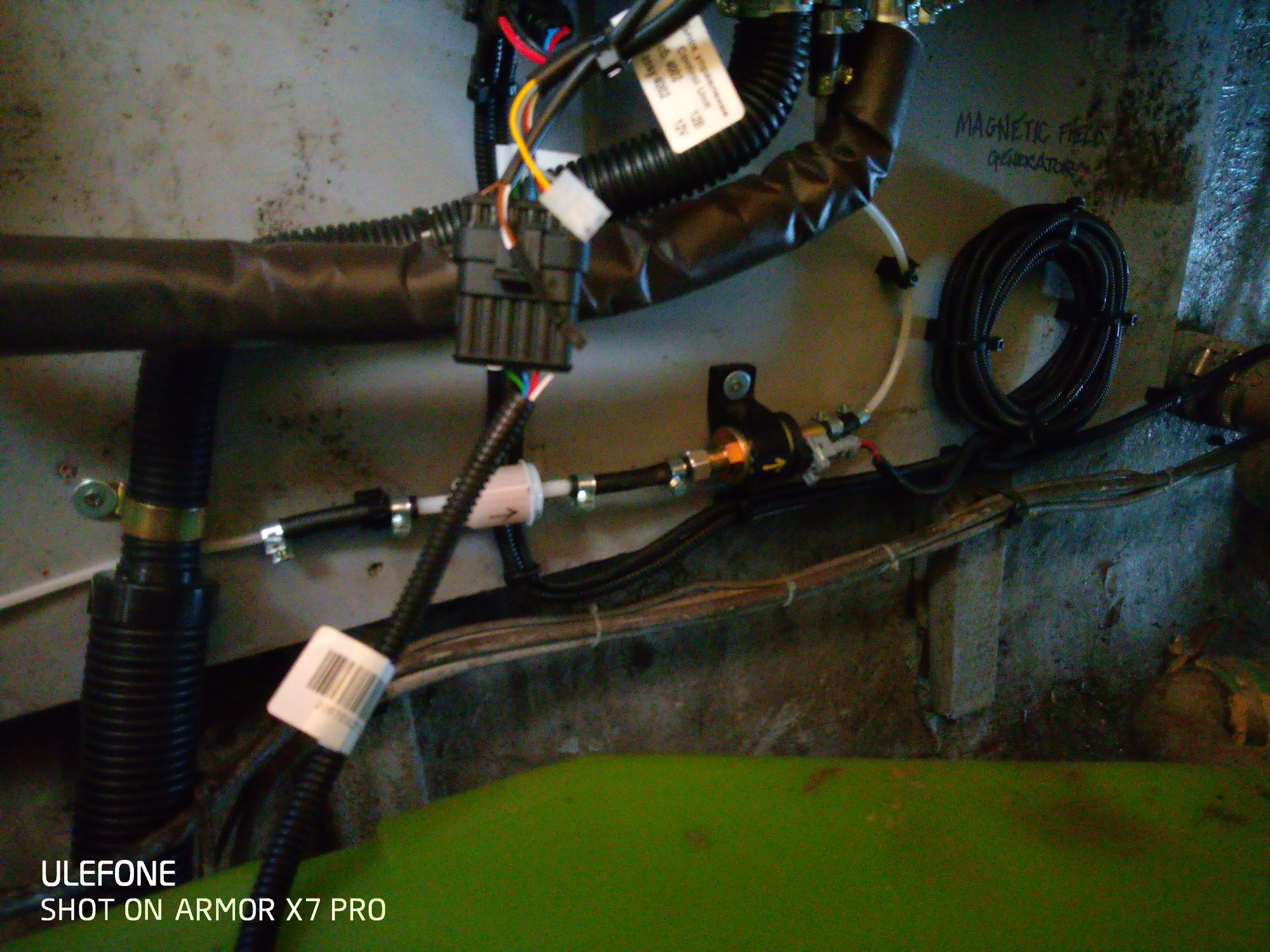

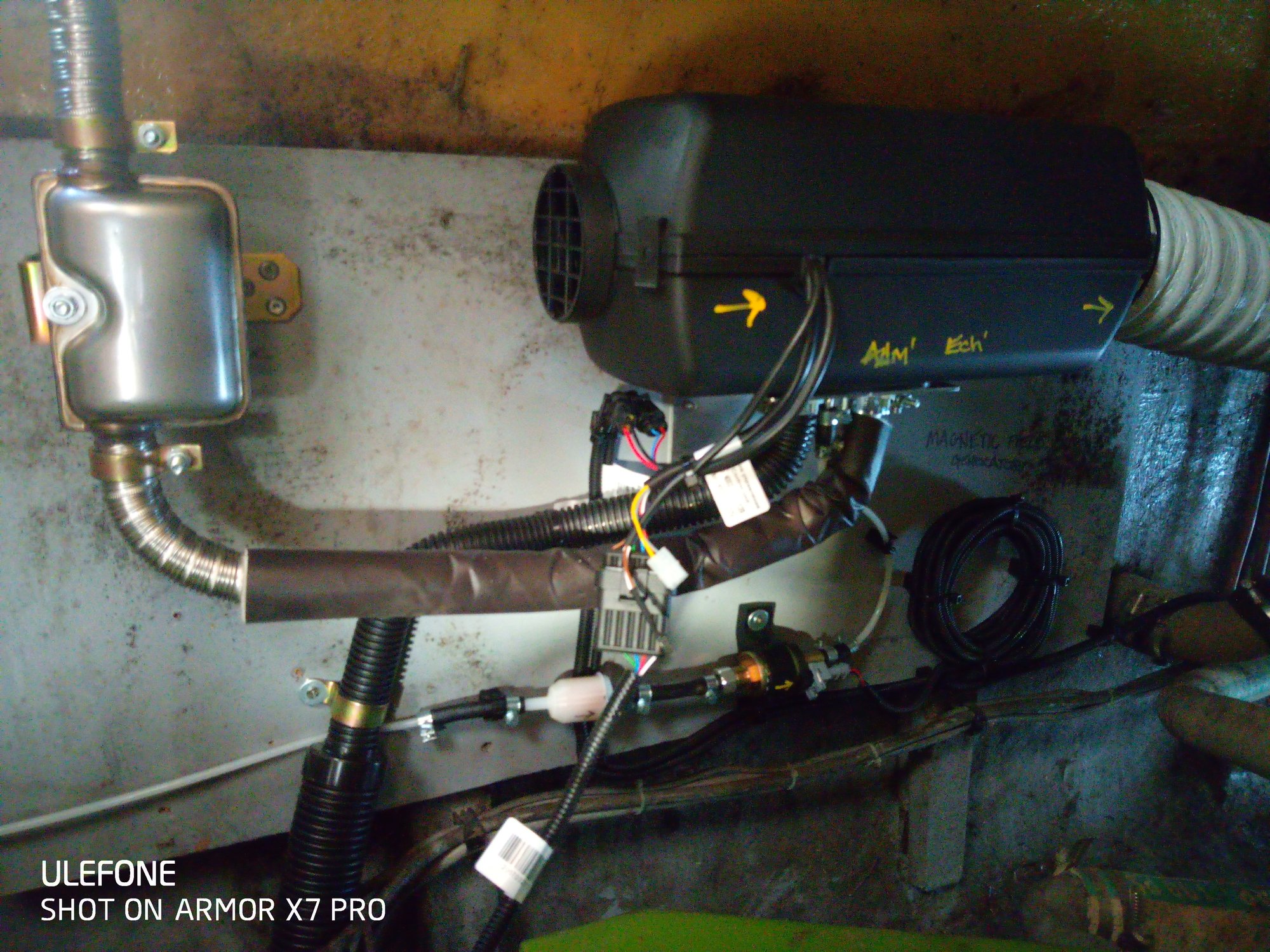

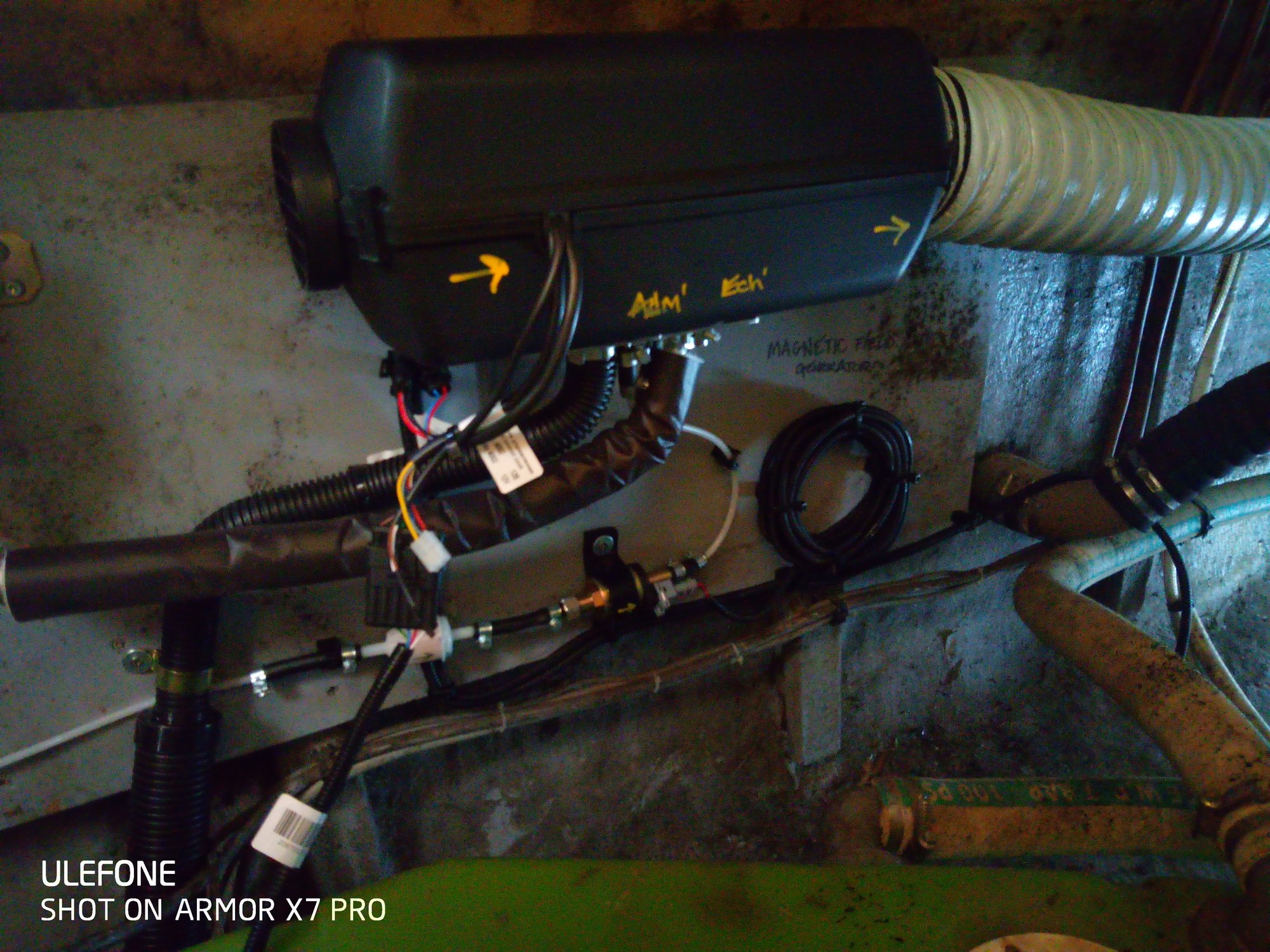

you shouldn't have the silencer either orientated that way or inside the work area. it has a bleed hole for the condensation to fall from so the side you have to the left should be pointing down. and because of said weep hole it will leak exhaust gases, so it should be outside.
