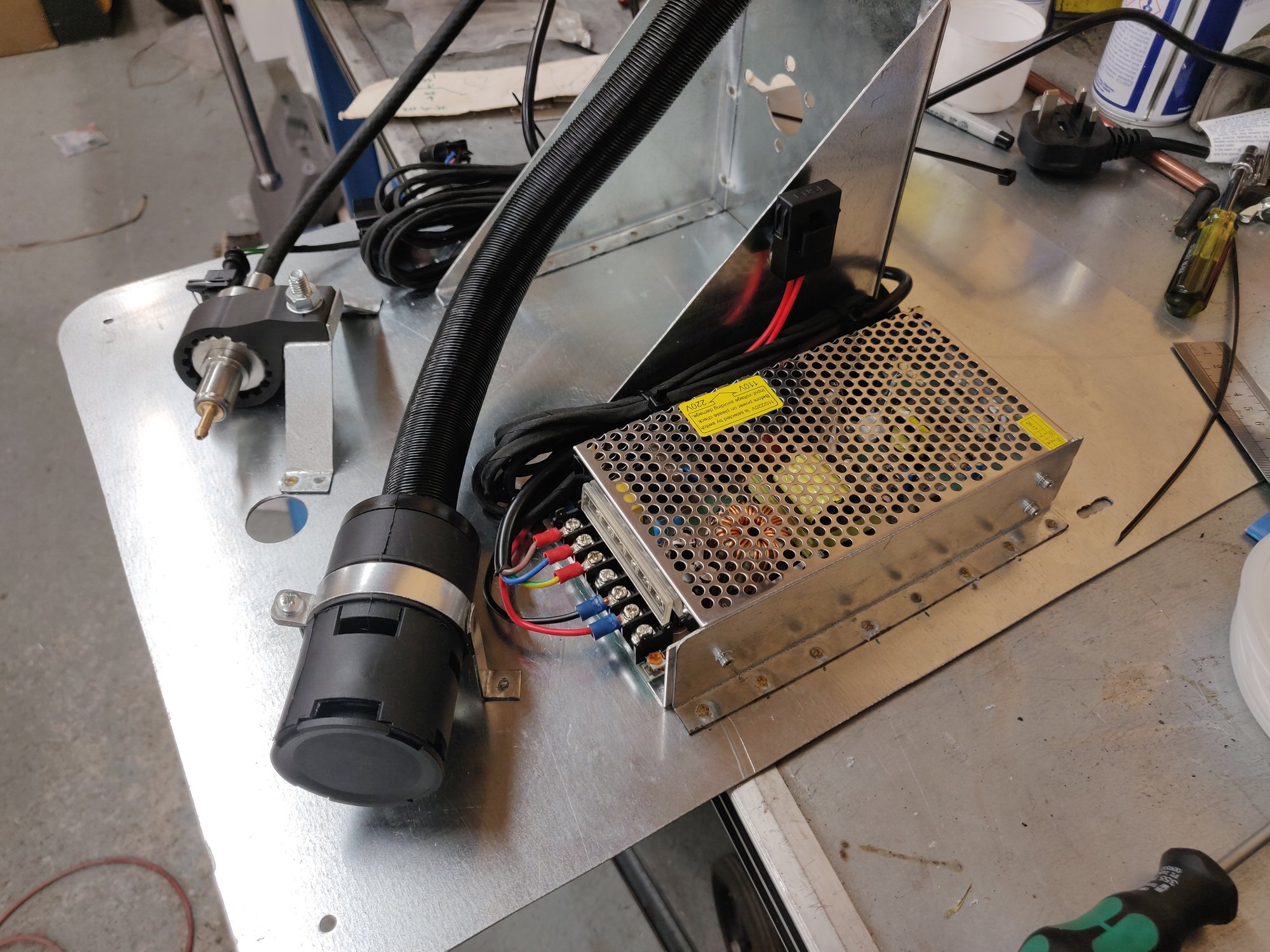

Nicely done but rather unnecessary, the only part of the heater that gets hot enough to worry about is the exhaust pipe and that should be lagged. I've fit plenty of these on boats at work and we've never needed anything more than the standard L shaped bracket they come with and we usually fasten them to the wooden structure of the boat.The heater will be mounted on the timber garage wall so I wanted something that would give some heat protection, construction is folded and spot welded.
