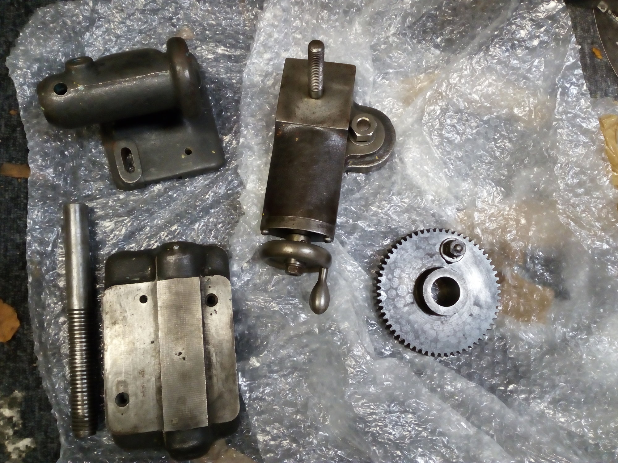

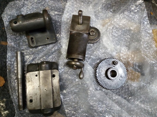

Machine the boss off. Machine s new boss slightly bigger and fix it to the gear with tapped holes in the gear would be my method I think

"Yer but No but" the difficulty is needing a working lathe to fix the broken lathe.

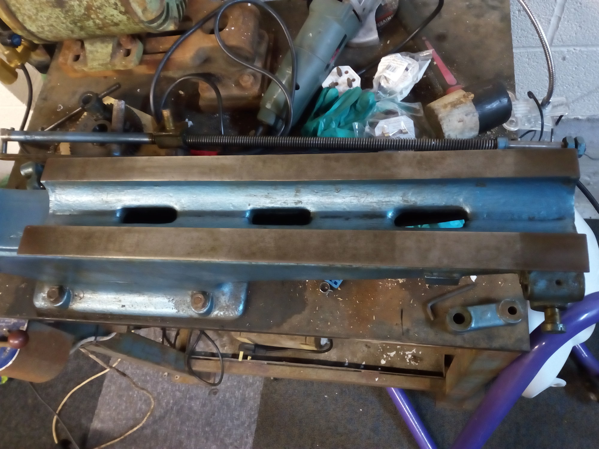

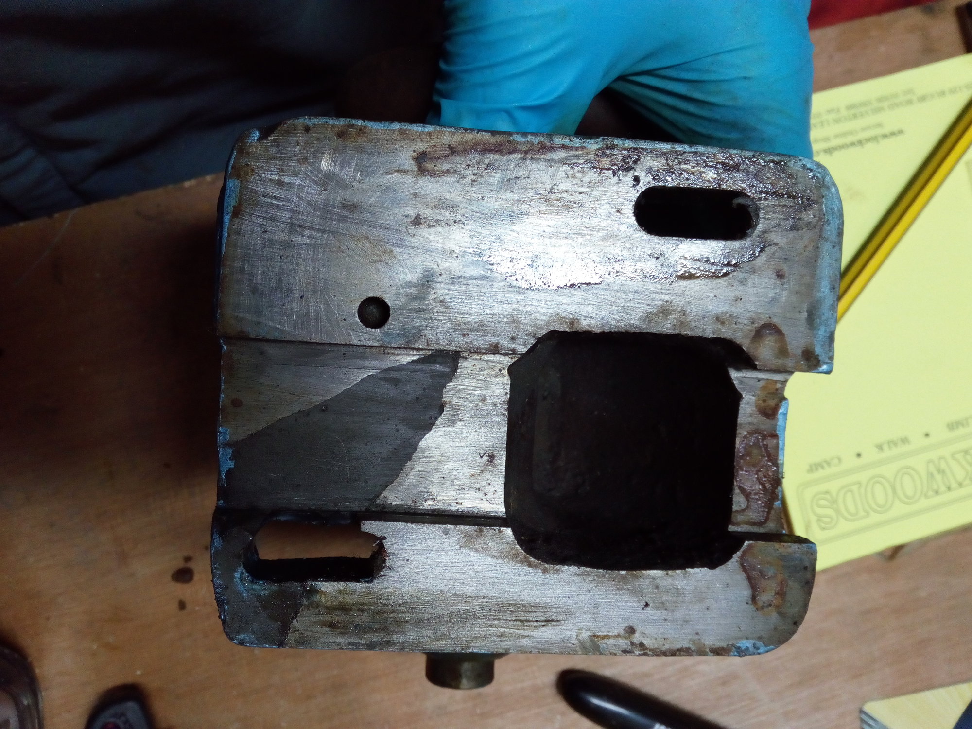

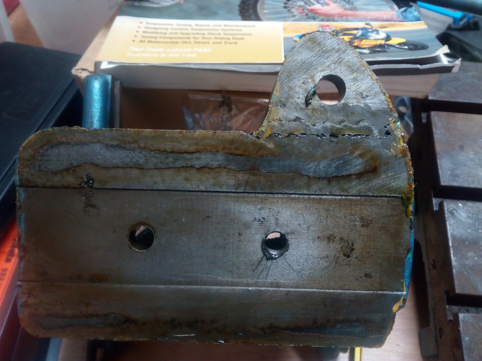

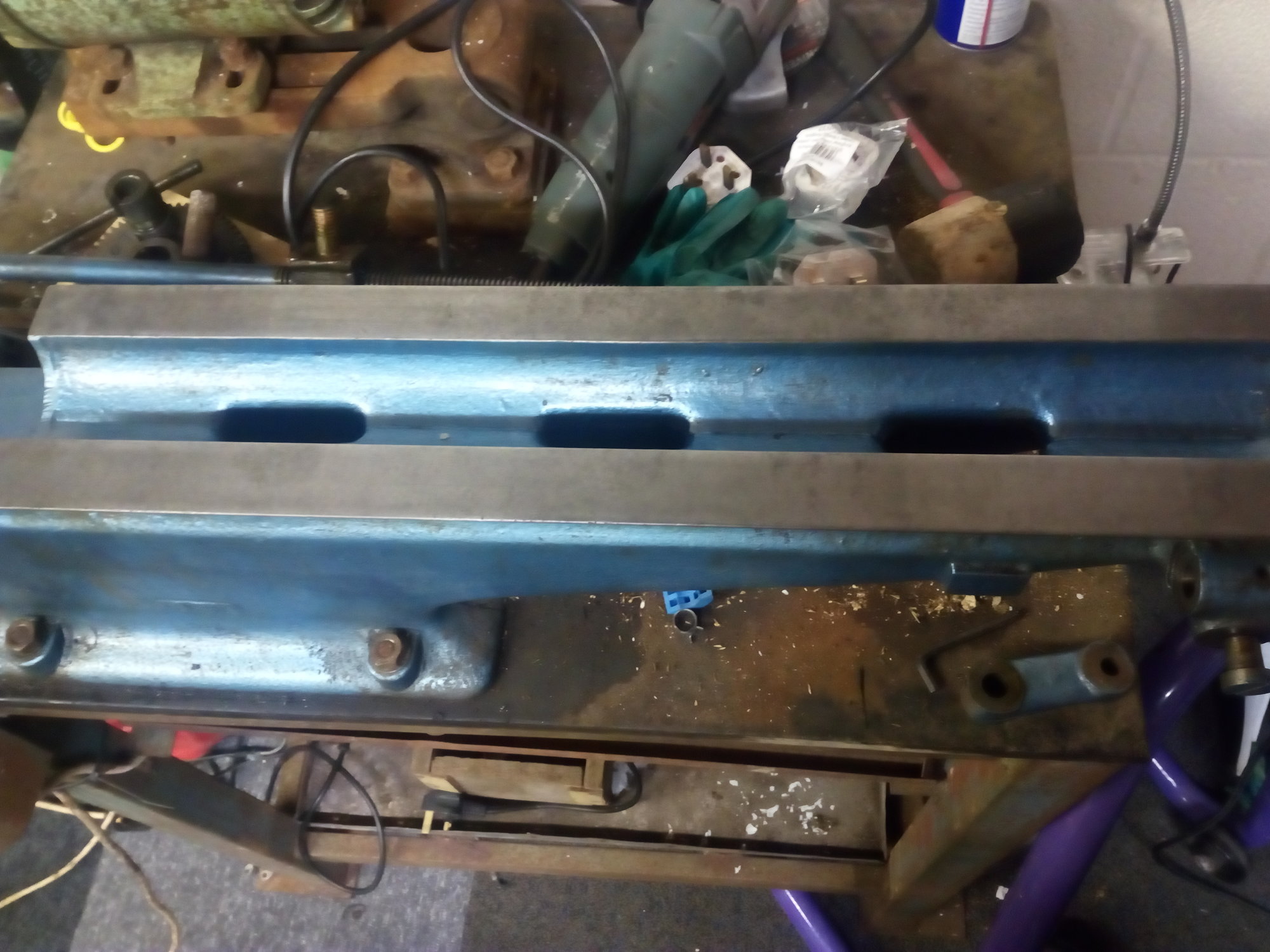

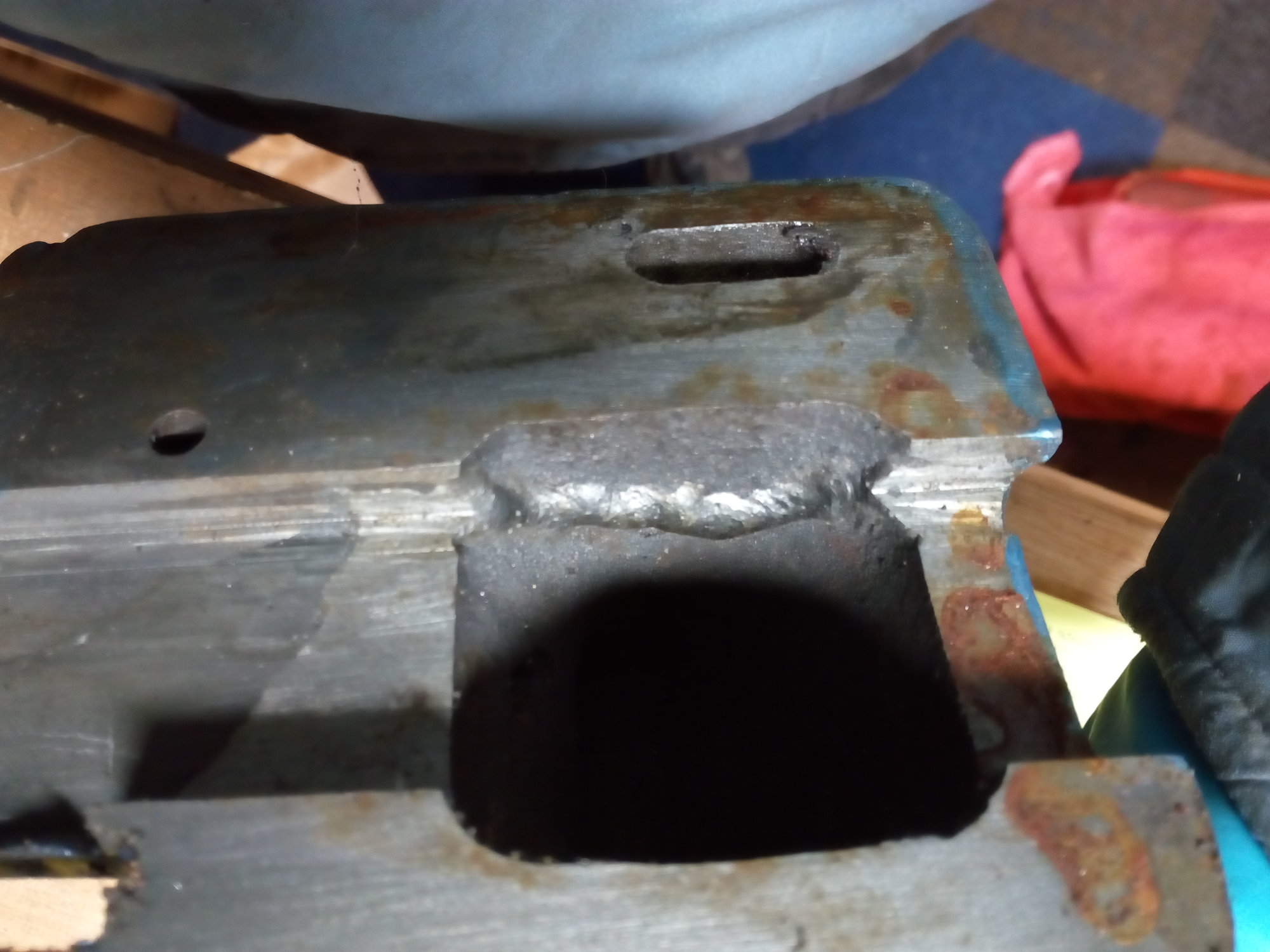

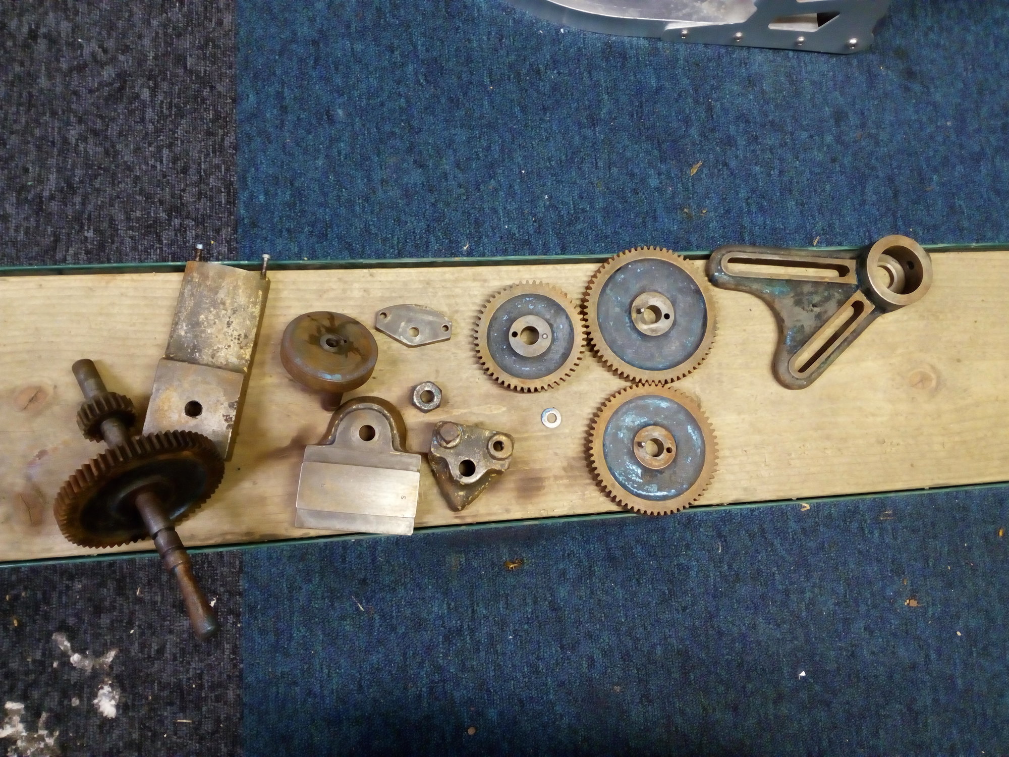

That's the fun of restorations.The progress on this restoration is definitely glacial but did get a bit more done this evening. Have removed the tailstock and found that it has been welded and repaired with filler in the past. Definitely a lot worse condition than I hoped, at least it was cheap. Next job will be to figure out how best to remove the main leadsrew and carriage/cross slide.
After that I can start cleaning up and refinishing parts, and source a few replacement parts before reassembly.
View attachment 210357 View attachment 210358

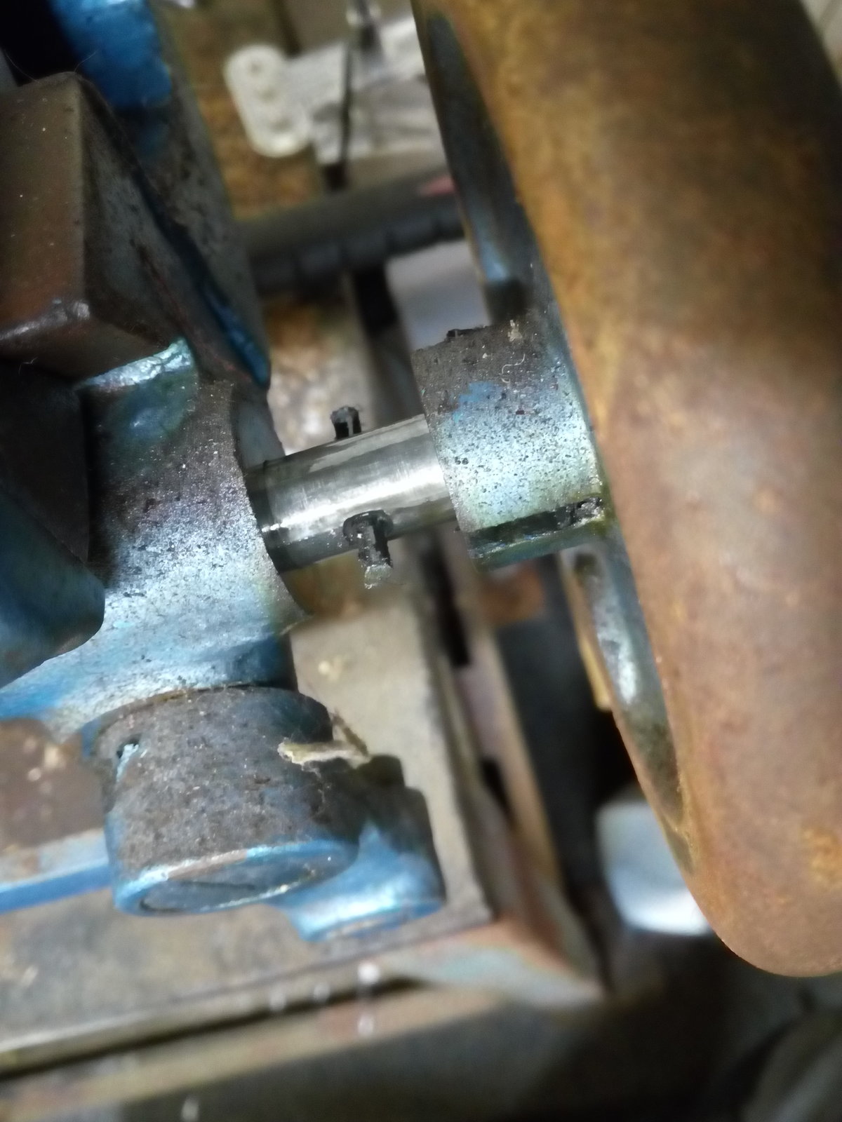

Sorry in a bit of a rush at the moment.
Un do the nut that holds the top of the half nut, then the two bolts that fix the top of the carriage to the front of the carriage, withdraw the front gib screws and the two screws clamping the back of the carriage. It might take a bit of effort but the top of carriage slide off in the direction of the headstock. I will try to post pictures if that was not clear.
I gather the lead screw is retained with a taper pin but I have not removed mine (Drummond M) so not sure of exact procedure.

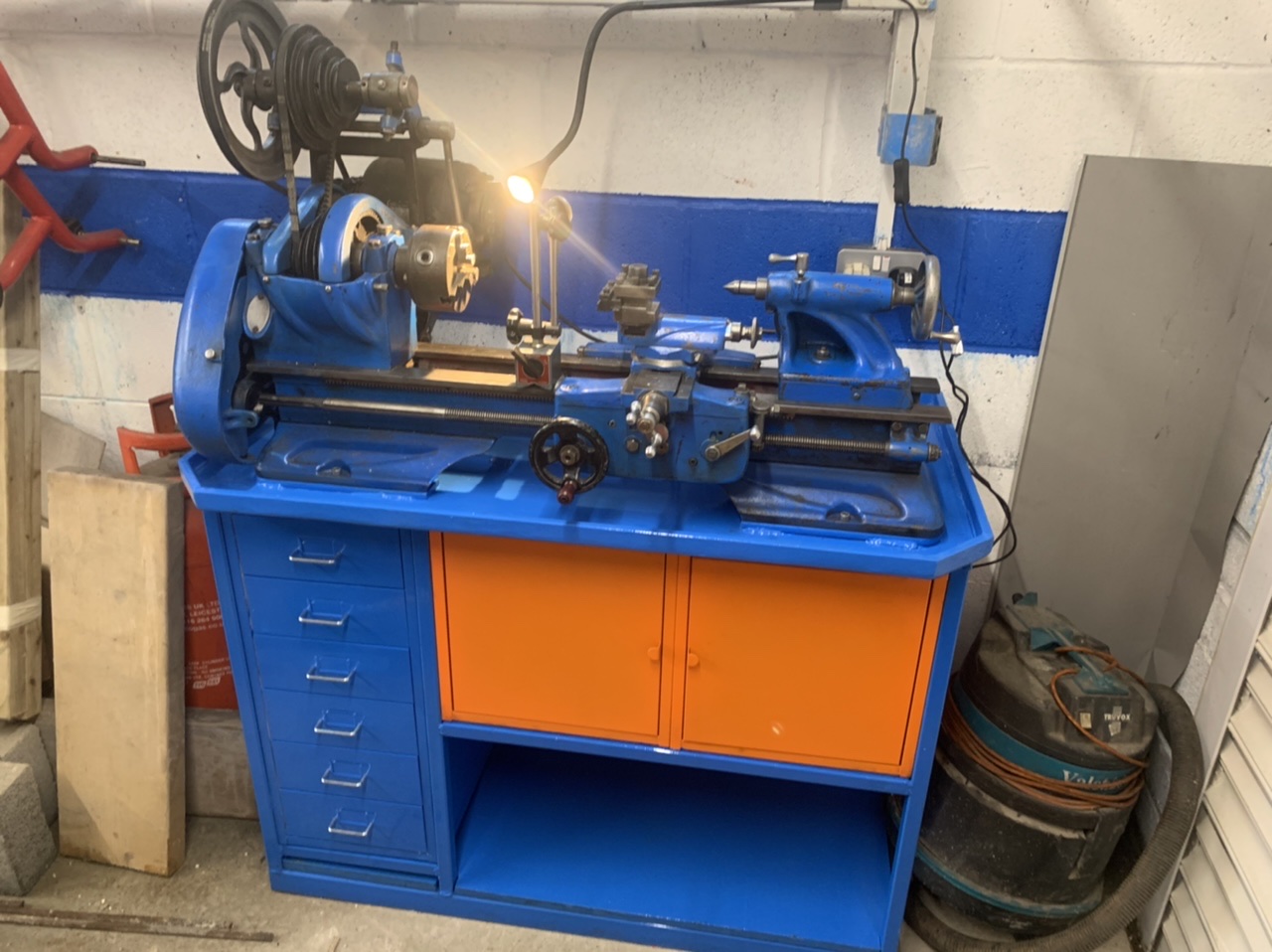

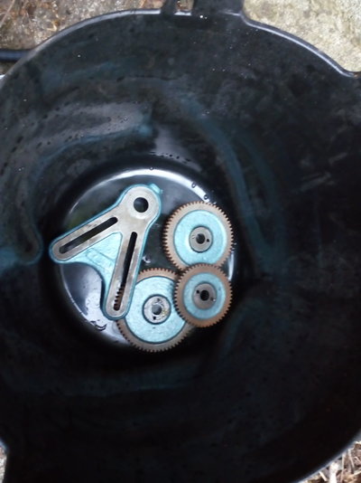

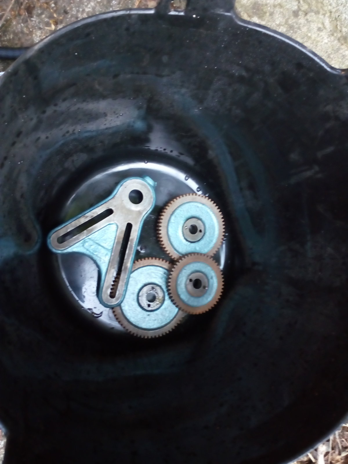

the stripper you used, worth the expense? I've a Colchester Bantam from around the same year i'm starting to renovate to a usable state and the paints quite chipped in places so thinking of stripping it back and reapplying the correct shade. just wondering how you got on with it considering the age of the paint you stripped.
looking good so far. interested to see how you get on
