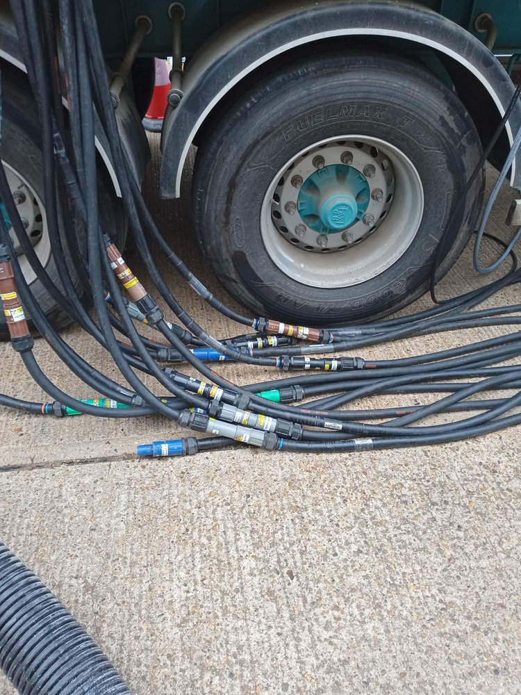

Anything bigger than that we normally use sets of 5 seperate single core flex with single pole plug/socket connectors known as powerlock.
One of the many things I get up to is doing temporary power for events, music festivals etc.
