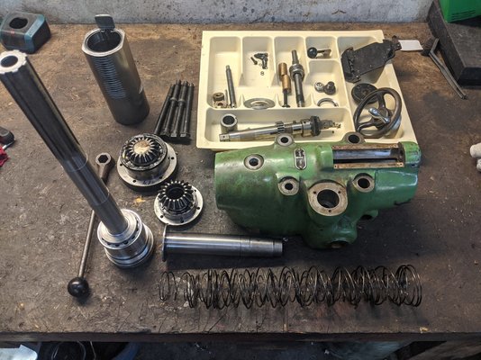

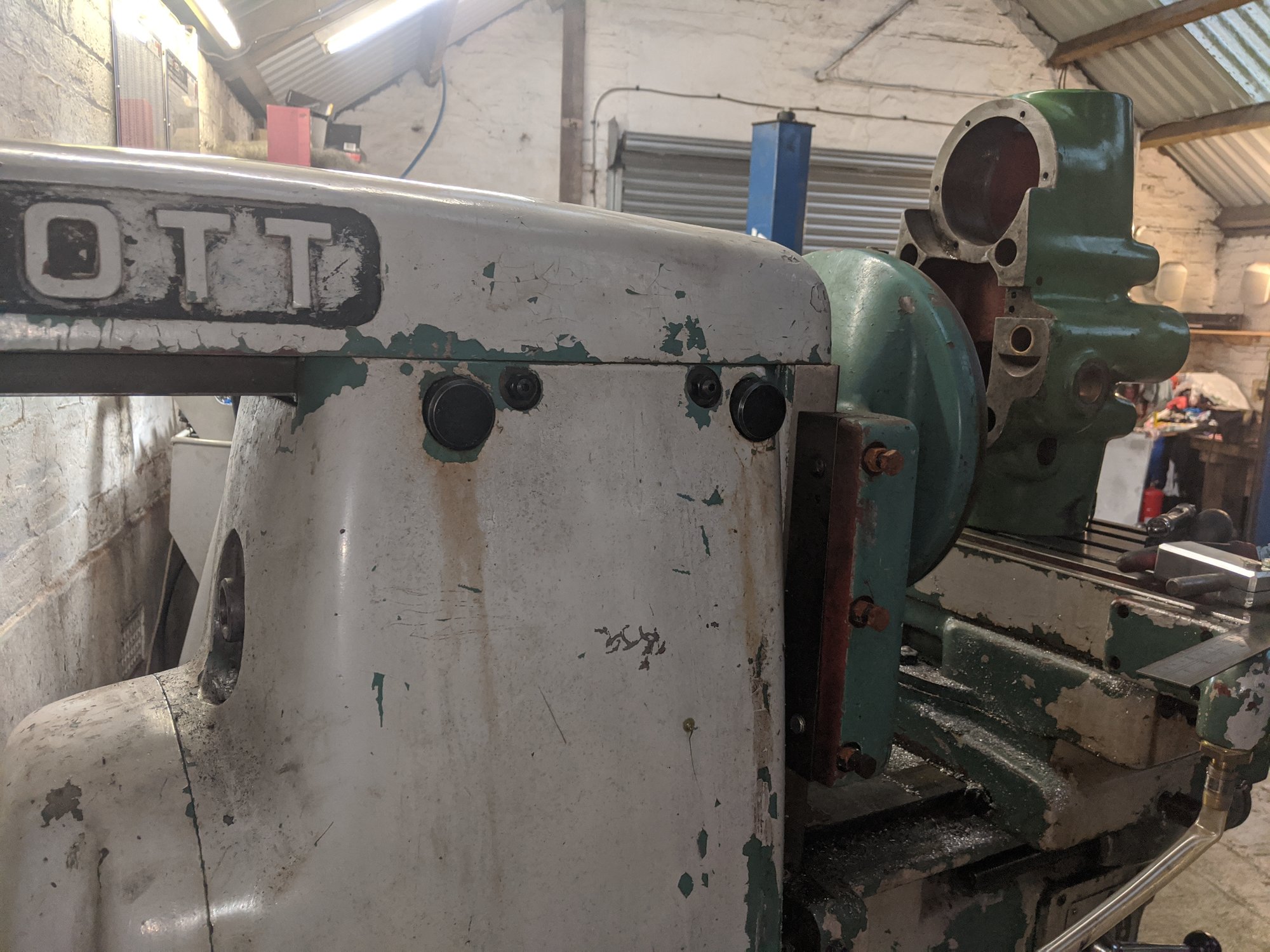

Not on this there's not, no clockspring, the only thing left in it now is the quill itself, I've even got the spindle out.
Must be a compression or extension spring.
It's actually a return Spring too, unlike a Bridgeport where it's actually a balance spring.
There's a circlip I think will reveal its mysteries bit I didn't have time tonight.
It's a couple of big compression springs.
I've got 3 stitches and a mild concussion to prove it.
