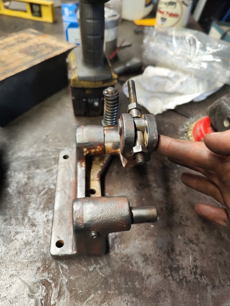

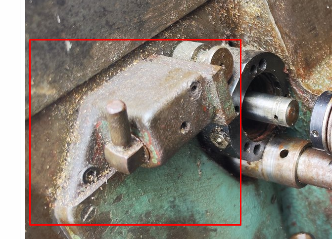

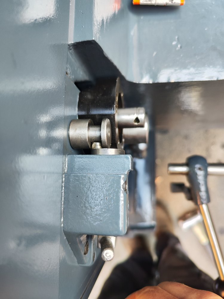

As you can see, the quick change tool holder (on its lowest setting) is sitting slightly higher than the original tool post
When you show the picture of the rusty original toolpost above, there are shims under the tool in it. For that tool, you need to compare the top of the shim pack to the bottom of the Dickson holder.

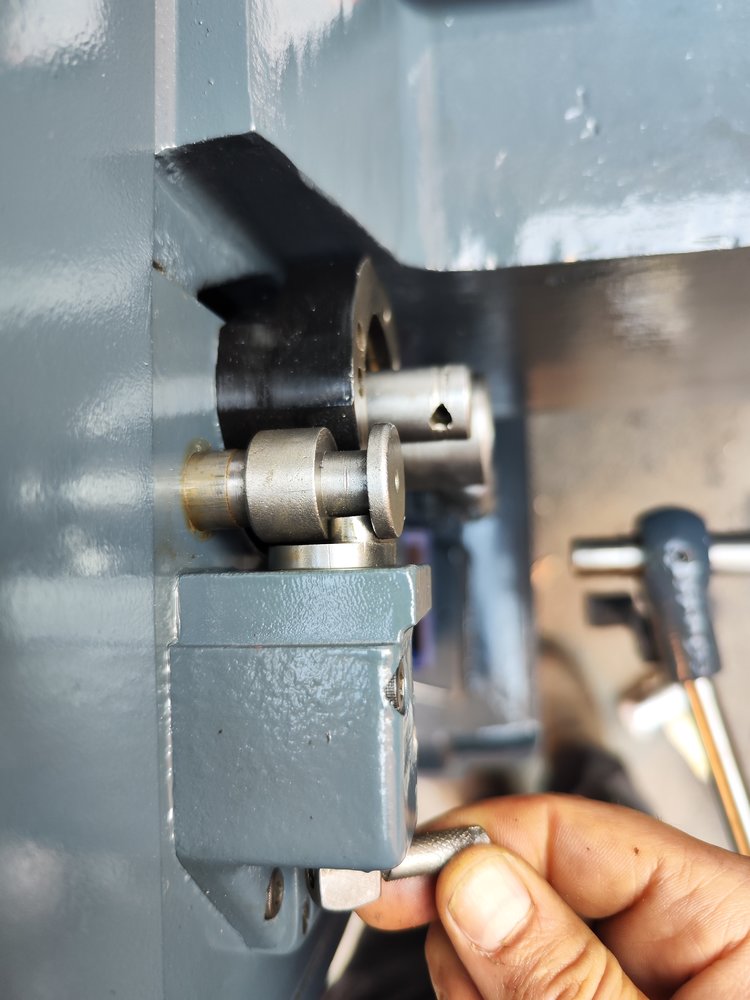

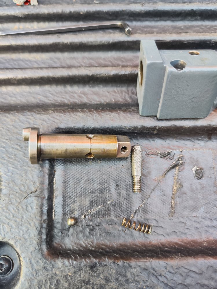

When/if the bolt fails I will remake the bolt and the female insert part.
You would not need to remake the whole bolt. Cut off the projecting male thread, dril and tap for a female thread and loctite in a stud.
