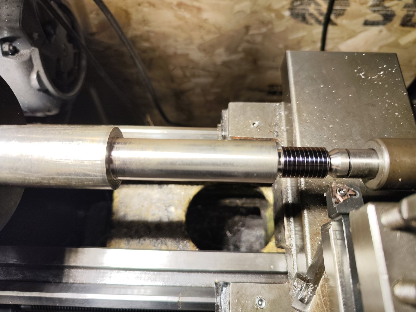

Sorry for double posting but I couldn't edit my previous post somehow. Anyways I think I figured out what happened. So it is the 6th gear from the left that is the incorrect one, which maps to no 7 on the wheel selector knob. If my calculations are correct, by setting it to a 25T instead of a 24T you get a thread pitch of around 1.734mm which is very close to 1.75mm which the Elliott does not support out of the box. Although I plan to cut mostly metric threads I think I'd still prefer to have the 24T gear so as everything matches with the chart. If I'm not mistake I could also manage to get a 1.75mm pitch if I change the outer gear which drives the feedbox (nornally it's a 56T) to a 48T and use the numbered wheel on 9. Not sure if that will work but one way to find out. So anyways now I need to machine a 24T gear.Hey everyone, I started dismantling the feedbox and I found a 25T gear instead of one of the 24T gear. Can anyone confirm if I'm going crazy please? It is the 6th gear on the top rack of gears (the solid pack) from the left if looking at it in front.
Edit: to be honest I'm not sure if it's the 6th gear or the 1st gear from the left. They are very similar in size but one of them is 25T. If I read the manual correctly there should be 2 24T gears. What's strange is that the previous owner said that he never had any issues with the thread pitches and they all matched with the chart...
Pawcu, sorry I somehow missed your postsSorry for double posting but I couldn't edit my previous post somehow. Anyways I think I figured out what happened. So it is the 6th gear from the left that is the incorrect one, which maps to no 7 on the wheel selector knob. If my calculations are correct, by setting it to a 25T instead of a 24T you get a thread pitch of around 1.734mm which is very close to 1.75mm which the Elliott does not support out of the box. Although I plan to cut mostly metric threads I think I'd still prefer to have the 24T gear so as everything matches with the chart. If I'm not mistake I could also manage to get a 1.75mm pitch if I change the outer gear which drives the feedbox (nornally it's a 56T) to a 48T and use the numbered wheel on 9. Not sure if that will work but one way to find out. So anyways now I need to machine a 24T gear.

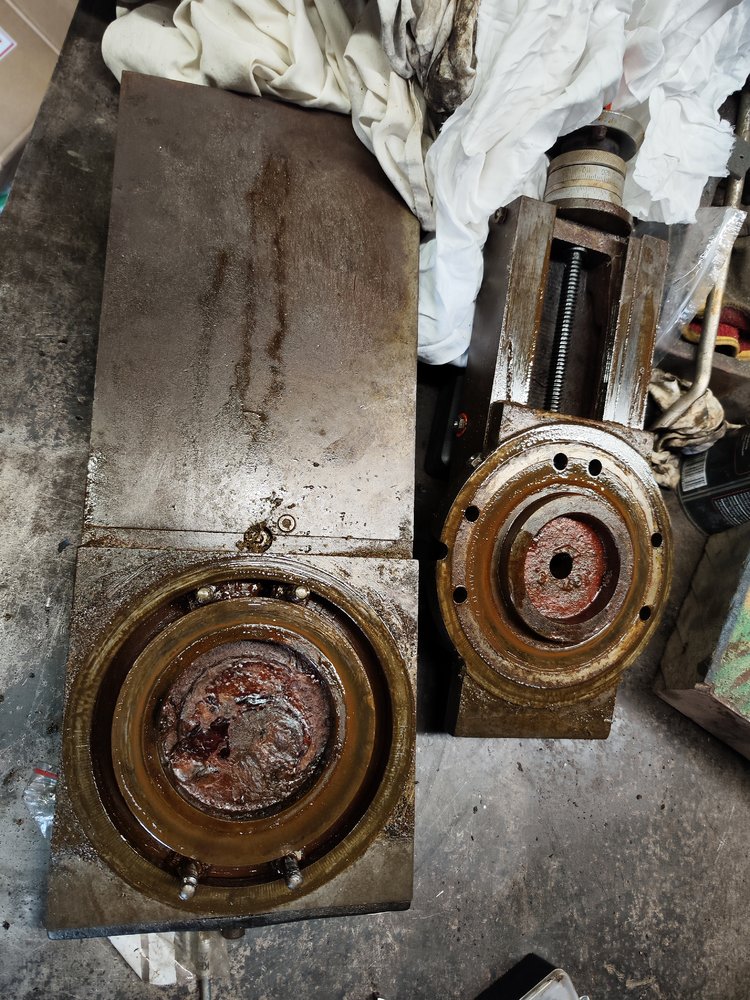

I cleaned it with a combination of a grinder with wire wheels, drill with wire wheels and hand brushing. It is very tight in there and not easily accessible.Smouser, I wanted to ask you, how did you clean between the ways? There are a lof of triangular support material, not sure if best to use the grinder or the needler gun.
If I am perfectly honest, everything in there was not completely back to bare metal, it was just too much of a pita and time consuming.
I did not have a needle gun when I cleaned mine (got one now) so I have not tried that.
I did the same with the inside of they ways. Cleaned as much as I could then cleaned with white spirit. Whatever was left, got painted over.No worries - I understand people are busy hehe
Yeah I think I'm sorted now - I ended up cutting a new 24T gear and last weekend managed to fit it back in - just filled up the oil this morning and currently waiting to check for leaks xD
i'm currently in the process of trying to clean inside the ways - most of the work im having to do by hand which like you said is very annoying xD
In the end ill give it a light wipe with some white spirit - what doesnt get removed will get painted over - if it didn't come off with all the elbow grease i hope it won't come off after painting :P

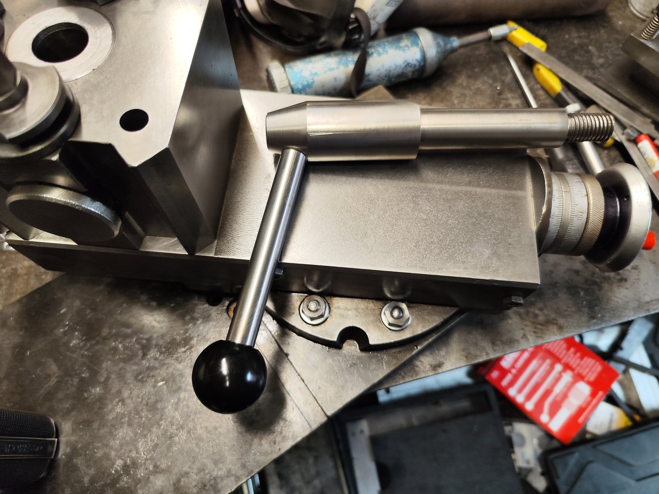

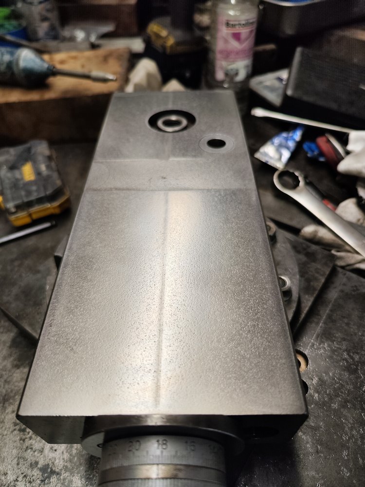

Also very good process on the compound and tool post! Very good thinking about cleaning them up on the milling machine - you know that thought never occurred to me to do that xD I just cleaned them up with some rust remover and a paint stripper wheel (just the outsides though not the ways) Keep up the good work

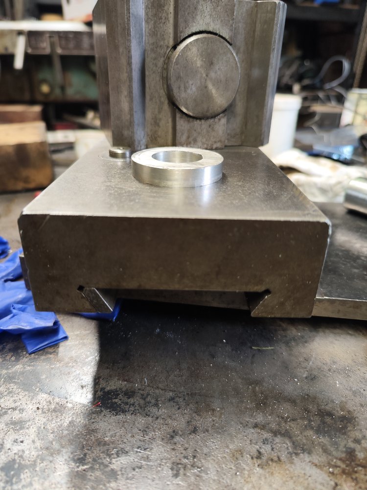

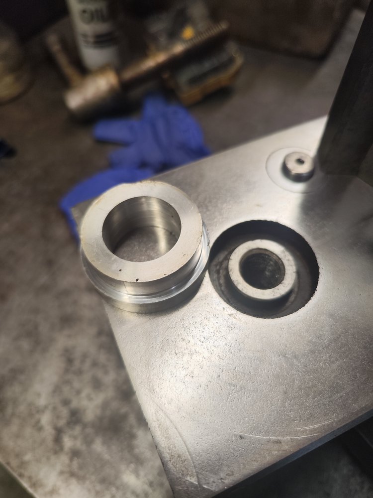

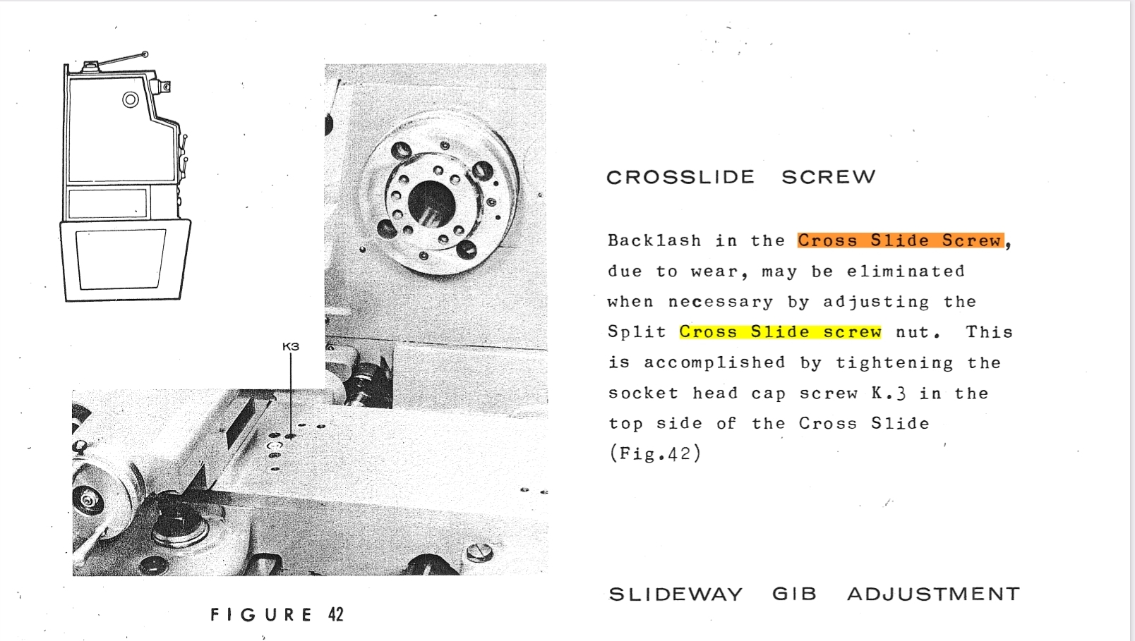

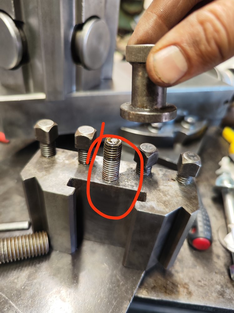

1) did you remove the cross slide screw and nut by any chance? In the manual it says that there is a screw to adjust the nut backlash from the top but in my case the actual bolt to tighten the nut is actual from the underside

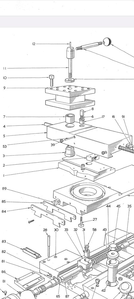

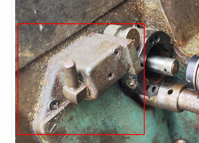

2) Did you happen to remove this piece or have any more pictures of it by any chance as mine is missing
Thank you once again and looking forward to seeing more picture![]()
1) Is it this you are referring to?
I have not re assembled those parts yet so it should all still be accessible for me to check. I am not home currently but will see if I can establish what is going on there.
2) I did have that part off to clean and paint but do not have any more photos of it, sorry.
From memory, it is a simple little lever with a spring and ball bearing that helps to prevent it from moving once it is in one of the two positions. Again, I am not at home currently so I can't check but will hopefully get a chance on the weekend.
Luckily, there is a replaceable 'insert' part where it screws into so it is not directly into the top slide.Is it screwing down into a thread in the topslide casting or a separate part in the topslide? If the former I would make a new one.
