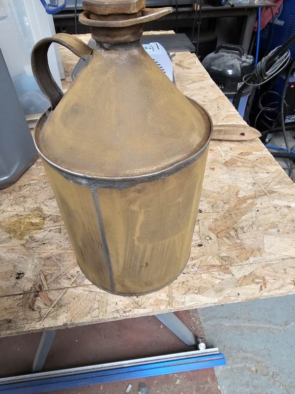

The jar wants to be covered with a thin layer of tin, through fire.I've been doing a few bits of derusting while working on other workshop jobs. I found this tin of my dad's while tidying the barn and thought it could do with cleaning up and putting to use. It was well rusty, this is after cup brush and scotchbrite pad.

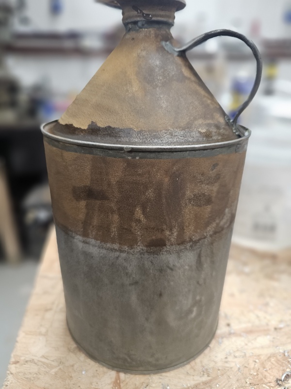

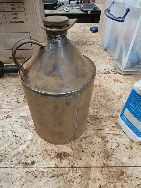

I had some Bilt Hamber Deox C Gel knocking about, it would have done the job but takes a while, and gets quite messy, I have better results on cast iron tables with this stuff. This is after about 4 hours of deox C Gel, giving it a bit of a move around every hour.

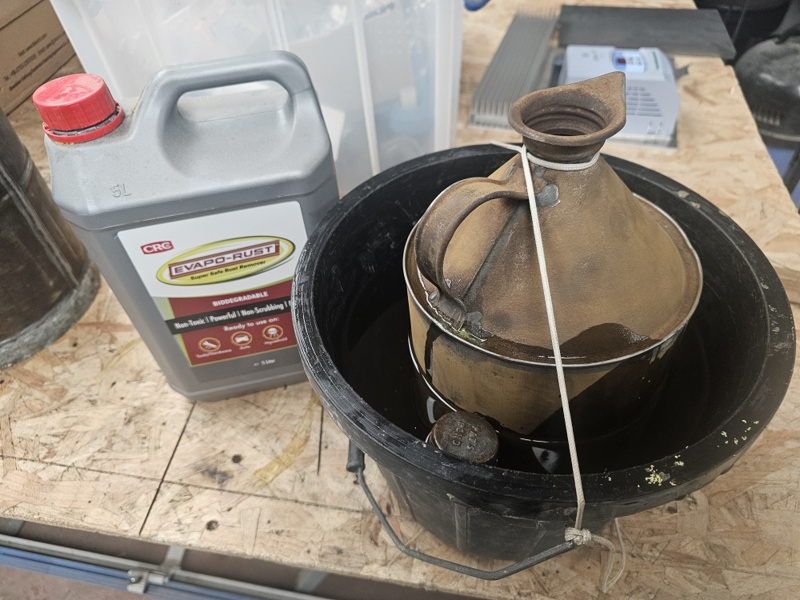

Then saw this thread so I thought I would use some Evaporust to see how it goes, I had half a tub left.
About 4 hours later, looks well.
The trouble is, the conical part doesn't displace as much when I turn it upside down so will put a couple of bricks in the bucket to raise the level a bit, or find a slimmer container

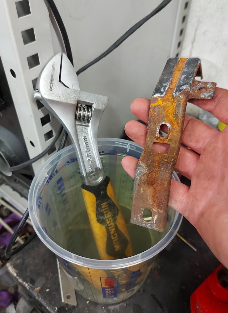

I use both citric acid solution and electrolysis on occasion too. They all work. Citric works best warm so putting an aquarium heater in the tank is something I occasionally do.

I have had excellent results with Evaporust. You do need to read the instructions carefully, or you can kill the solution. Can’t remember the details, but it involves whether or not you cover it etc.
If Evapo-Rust® has not been used, shelf life is extensive and it can remain bottled. As Evapo-Rust® is a biodegradable product it will compost if starved of oxygen once used. Once used, Evapo-Rust® is best stored in a plastic container with a lid that does not contain a seal. Utilizing a lid will limit evaporation and extend the life of your product. Partial quantities of Ready-To-Use Evapo-Rust® can be removed from the original bottle at any given time but MUST NOT be returned to the bottle once used. Doing so will degrade the unused product and eventually ruin it completely.
