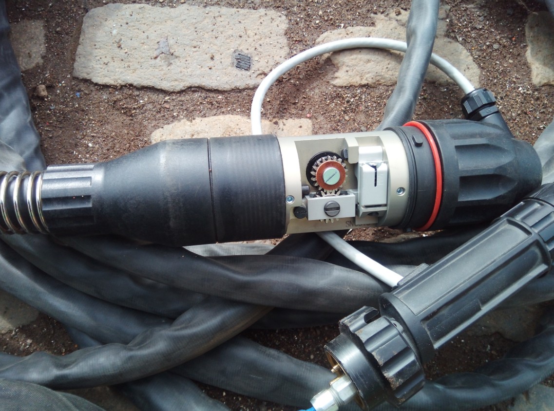

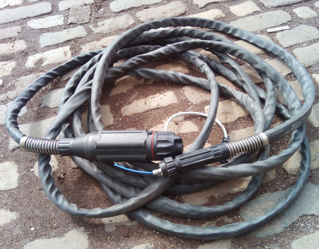

The feed unit is doing the pushing the mini drive the pulling. Then you stick a mig gun on it. Same as kemppi super snake.
They mainly use conventional 3metre MB501 mig torches but they do use push-pull guns as well.
If you look closely at the mini-drive there is s 19 pole socket on the front do you can use a push-pull gun on that too. It really is a little gem of a feeder.
It might be but I haven’t seen many super snakes in use without a few silver tape repairs in that orange sheath. It might not grip to corners and edges but it does seem to tear.the sheath on the Kemppi snake is more like what they are after
Just to clear it up, it’s not more than two feeders. It’s a Phoenix power source, with a 15 metre interconnection cable to the standard Drive 4X feeder, then from there it’s the 15 metre (which is the max they recommend for alu wire) from the feeder to the mini-drive. From there forward you can either fit a standard torch or a push-pull if you really need some extra distance.
