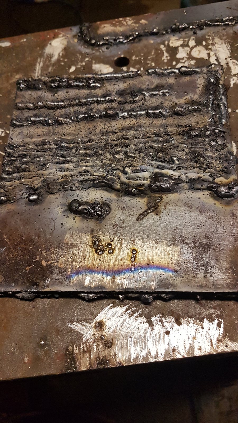

you need to fix the earth clamp to something bright steel unpainted your welding with no proper earth and you will struggle like hell with it
you also need your dial set somewhere between 2 and 2.5 on the welder
if that dial appears right your set at 5mm rods way too high your rods will melt like hell and not really weld to anything
