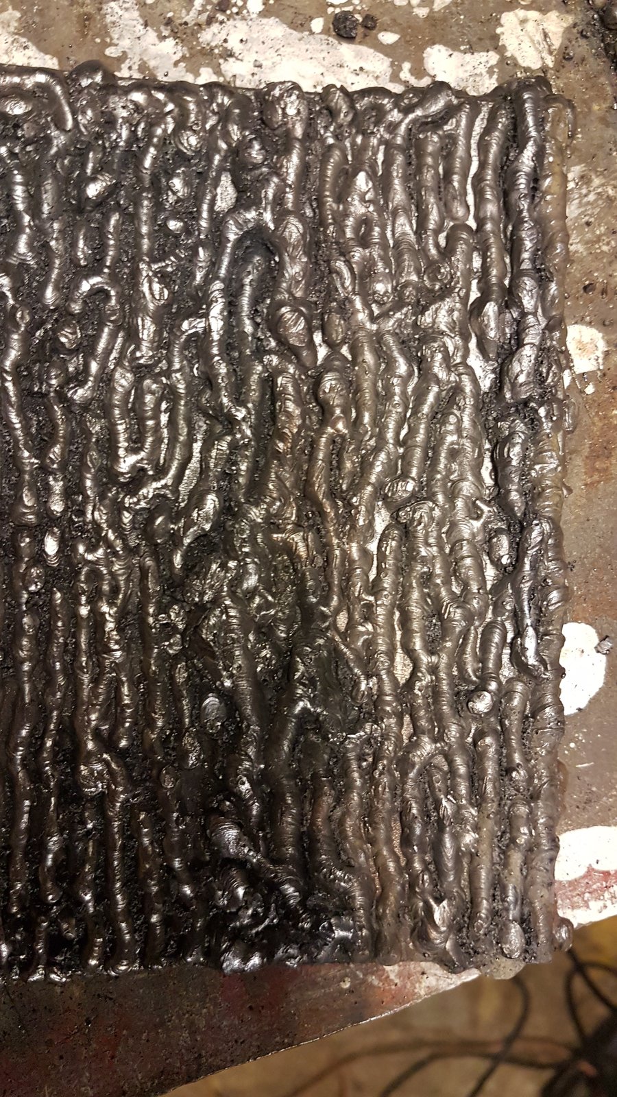

And todays attemps lol
I think from the pic that you've made an effort at cleaning your test piece, but try to get all mill scale, dust etc off and down to bright metal before you start - also ensure a good, strong earth [ground] connection.
I don't do much MMA, but really ought to get in more practise as I have to weld outside [wooden shed
] and it'd mean I could swap to that from mig if it's breezy and I want to get on with a job.
How very dare you!
I only switch from mig because of weather outdoors, I find it easier to work with.
