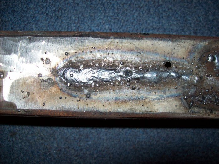

I agree with malc think of the weld pool, which you can see and if you notice you`l have a little dark spot rising from it that is your slag, its then you should move your pool foreward keeping that dark spot at the top of your rod/arc as it were, if that makes sense.
