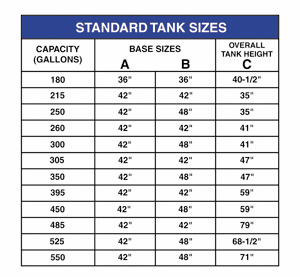

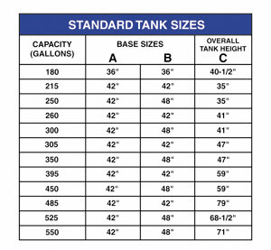

i had to go and look this up so ibc container full of wood contains in cords of wood
There are a few choices.
Take A x B x C / 1728 to get Cu ft. Then take that divided by 128 to get cords.
ex. for a 300 gal tote 42x48x41=82656 in^2/1728=47.83 ft^3
47.83 ft^3 /128 = .374 cord.
If you heap it you can probably get just under 1/2 cord in it. All of this assumes you stack it neatly which will probably necessitate cutting one side off to allow for uneven wood.
