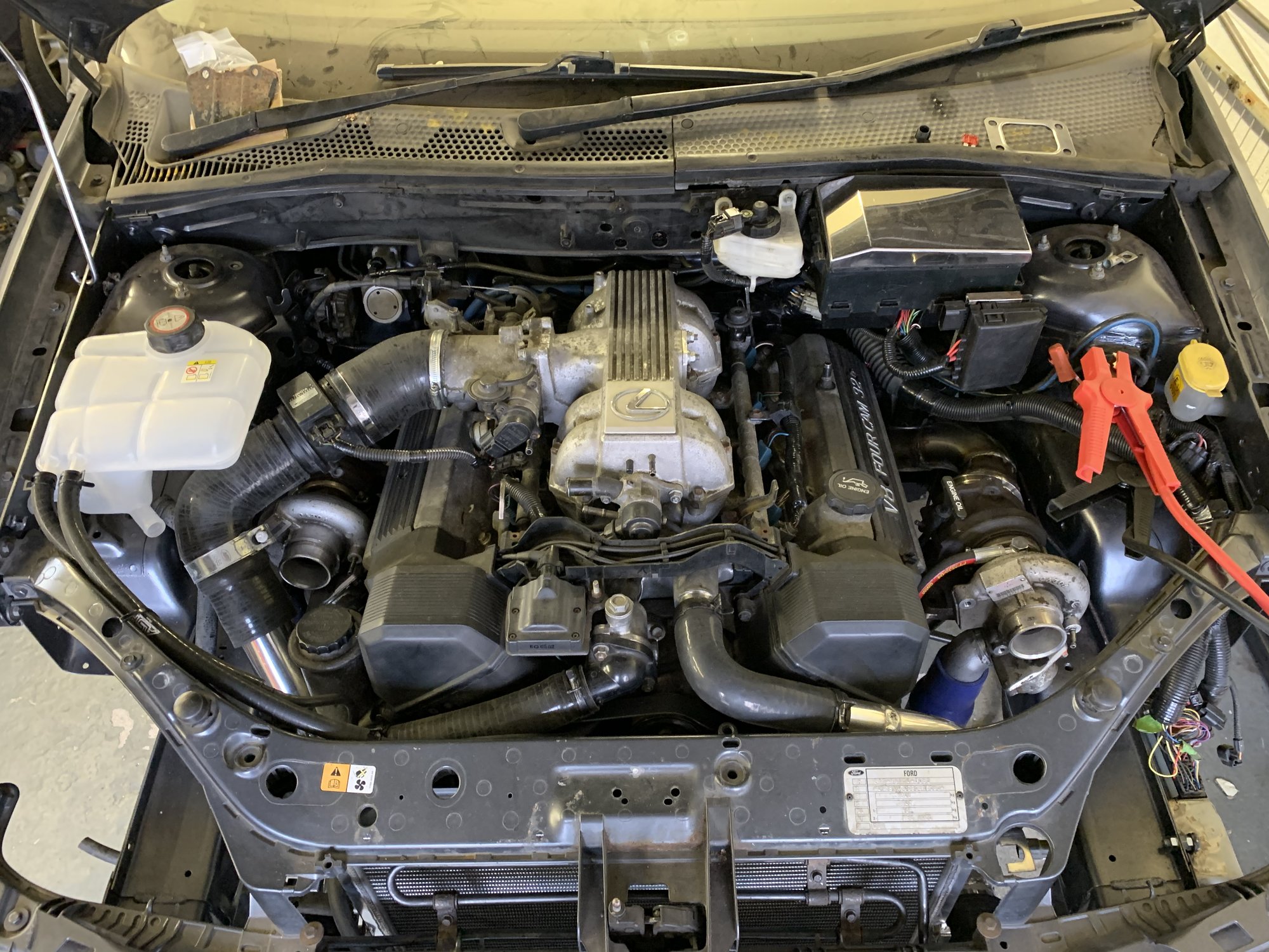

Yes, I’m not entirely happy with them tbh. I think they will be far too wobbly.
plan it to change them for something a bit better when they meet their inevitable death.
I’m hoping the angle that their at will help but I’m not convinced

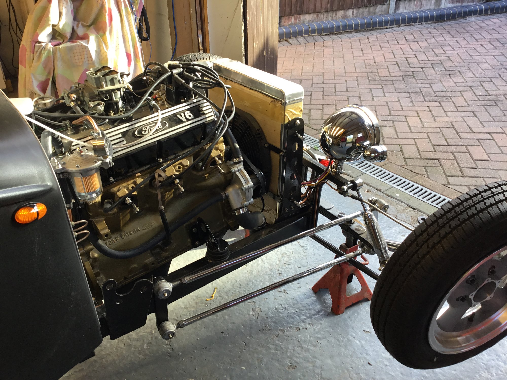

I have a pair on my hot rod, not been run in anger yet but I see all the sloppy movement is sideways, and i can push the motor sideways 1/4” easily, so yours are probably in a worse situation being aligned to shear sideways with the rotational forces that will be on them.
surely I’m in a better position as the pull of the engine is gonna pull up on one and push down on the other under acceleration?

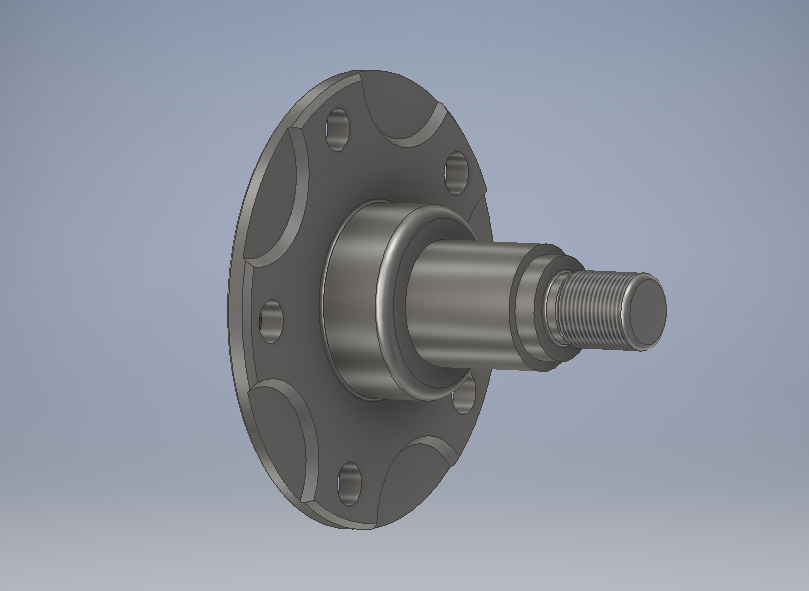

What's that a front hub conversion from focus to lexus PCD?
Looks weird due to the thread on the inside rather than using the cv cup and nutting the outside like a normal driveshaft.
I’d think mine is going to act like that, as my mounts are flat, but yours will be trying to rotate in a circle, around it’s crankshaft and will thus be shearing the engine mounts.
Ive already done it to some s2000 hubs but they’re not long enough for me to safely fit my brakes. So I need those made above. Bit of a game stopper if I can’t find someone soon tbh.
they are a little weird, not many cars have them this way, they always go the conventional way with a blank behind instead of a cv boot
Not sure I follow, under acceleration your flat engine mounts will pull up on one and try to tear the other one as there are no lateral supports to these mounts. So quite likley your near side mount will tear in half before your off side mount gets pulled in half.
mine should compress one side and try to pull the other side in half under acceleration as I have some lateral support from the angle at which they’re sat.

first thing that needs to be done is those hubs!!
Someone help please? Lol
I see what you mean now, mine wobble easily from side to side, but I never thought about the actual mechanical bond holding rubber to steel. I might fit a torque bar, with rubber bushed ends.
