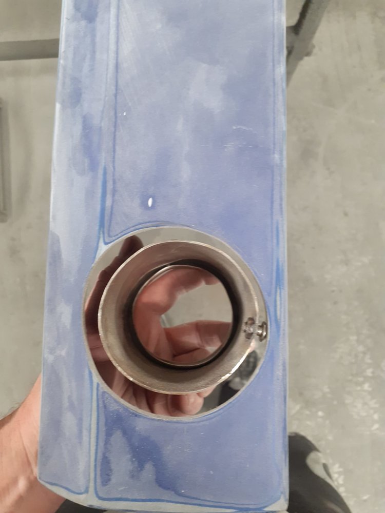

not really, its not attached to the exhaust and ii have a plan to direct the flow a bit better

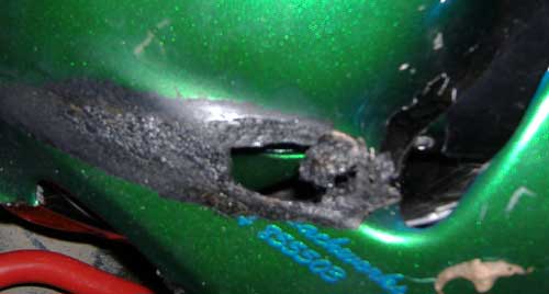

Heat is worth considering lest this happens (and this wasn't even the main exhaust, just the wastegate dump):
I thought that the exit velocity from the pipe would make the hot gases flow outside the fairing, as well as getting diluted by the cold air rushing past a 215mph bike.
Turns out, I thought wrong
