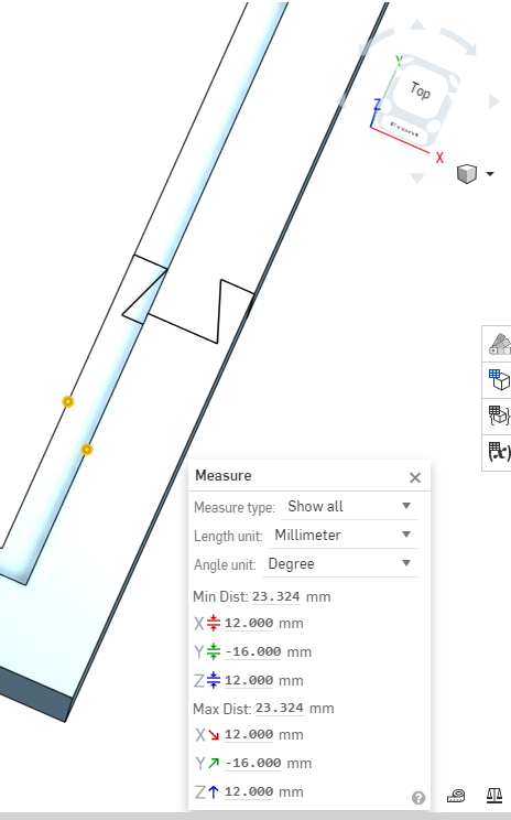

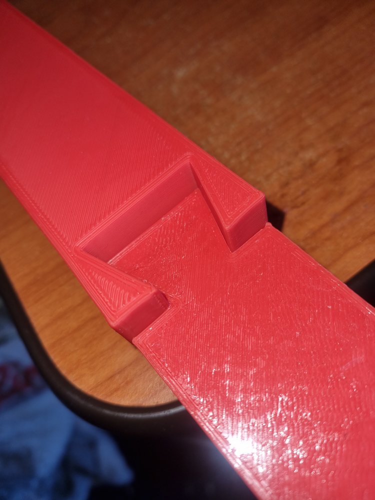

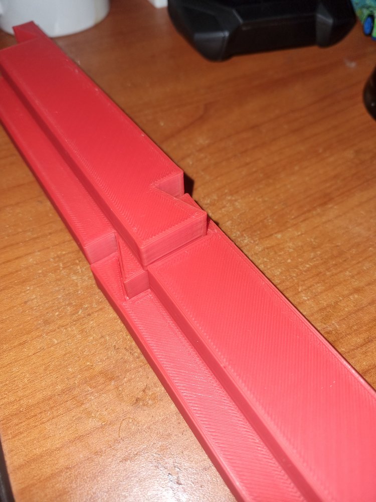

Hmm... Interesting. I guess there's a difference in bed size - I picked the location of the slices rather arbitrarily to be honest, so the model probably does need a bit of tweaking.

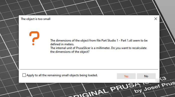

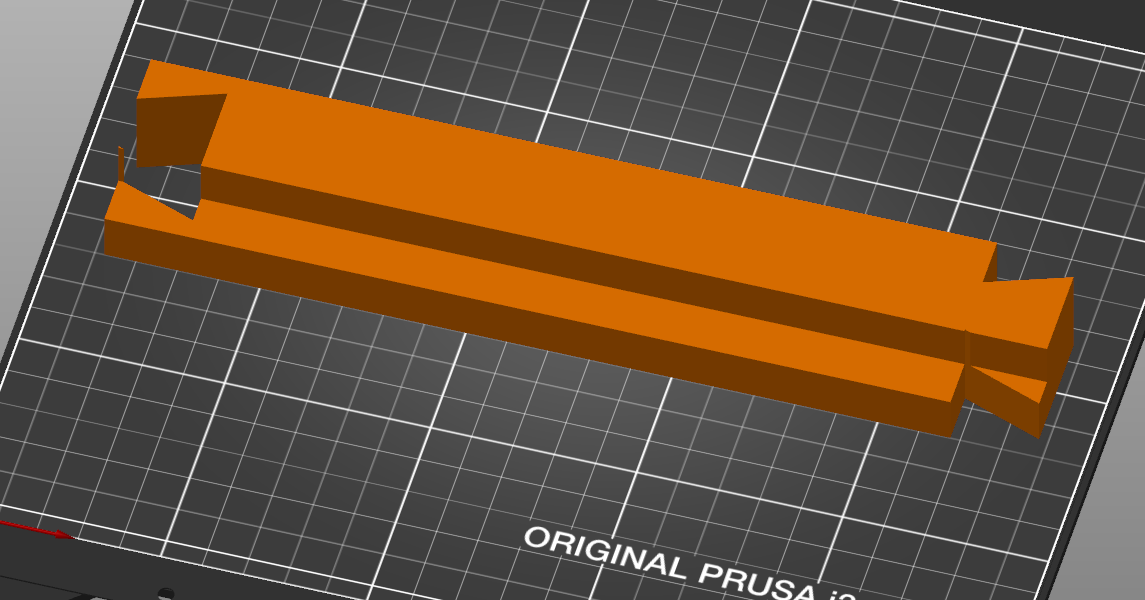

When I imported it to PrusaSlicer, I got this message (which I've never seen before):
After clicking Yes, it looked like this (which also shows up that my rather arbitrary choice of dovetail size wasn't ideal!)

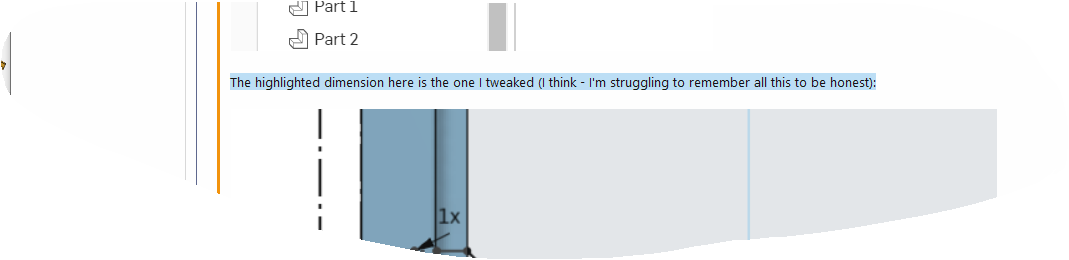

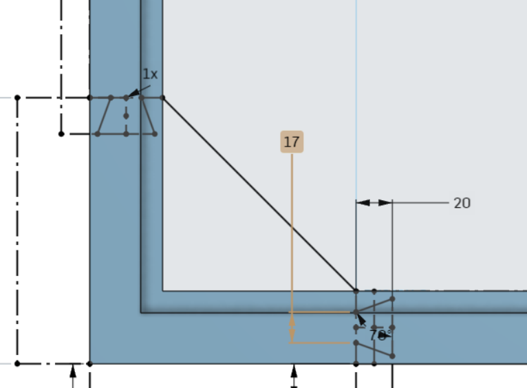

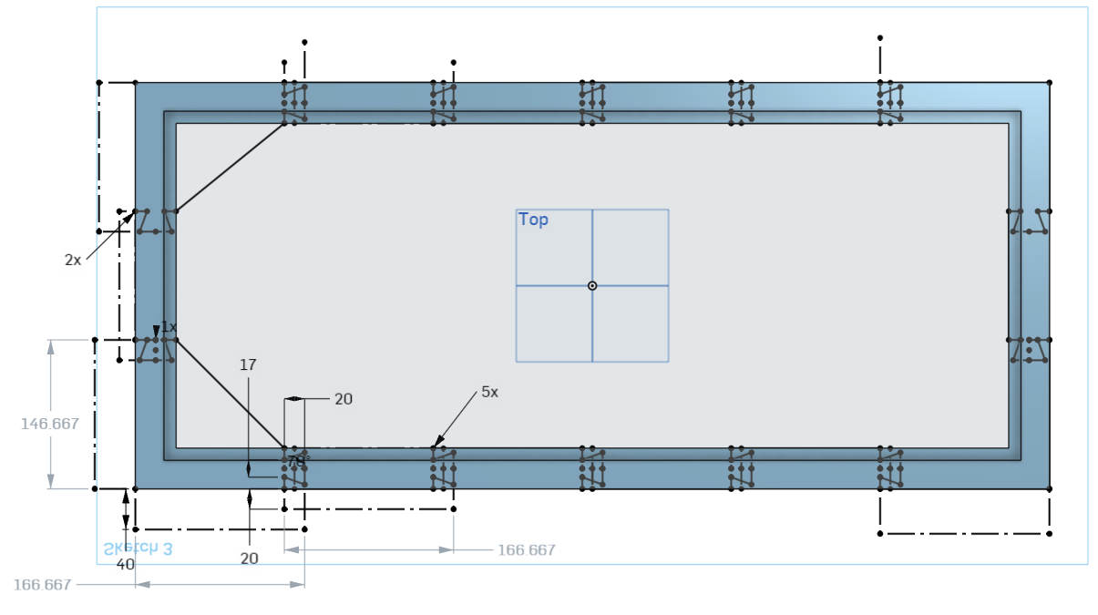

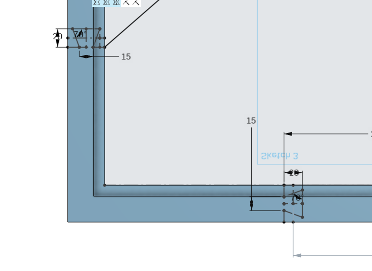

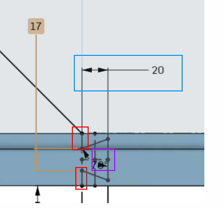

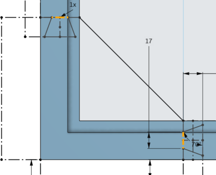

To fix the dovetail issue, I tweaked these two 15 mm dimensions to be 17 mm (in Sketch 3). If I had been more rigorous in the design, I would have drawn some construction lines where those dimensions are set, put an equal constraint on them and then set one dimension to 17 mm, but I was lazy and dimensioned them both.
To make the segments shorter, there were two things that needed to be done. The horizontal lengths were split into 3; to make them shorter, I split them into 5. I also changed the verticals (split into 2) so they were split into 3.

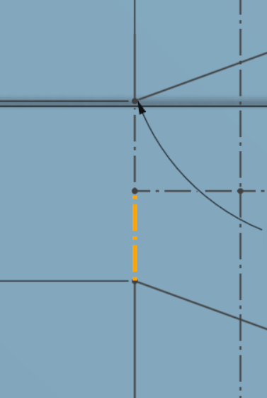

While I was at it, I added a few construction lines so I could make all the horizontal sections the same total length. This sort of thing takes a bit of getting used to, but once you've decided what you want to do, it's not too hard to get it to work.
It's a bit tedious drawing the lines that join the various different segments together, but it saves a lot of work splitting the parts up as you can do that in one operation.

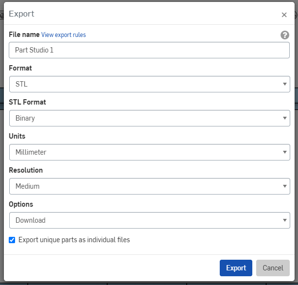

These are the settings I used to export:
Note the millimetre unit.

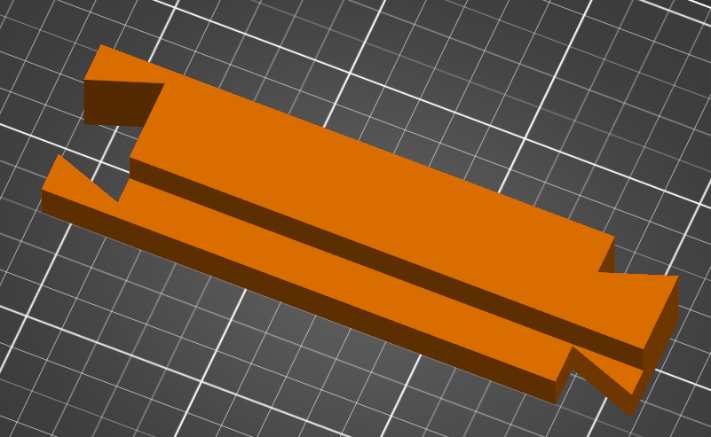

One part in prusaslicer:
