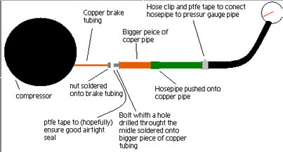

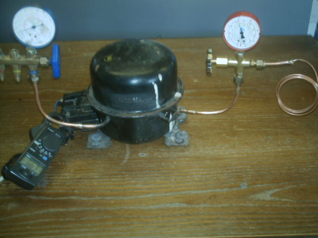

I got this out of a little old ladys fridge, should have seen the size of her fish fingers
..........I like to make things needlessly complicated...
You could try the thin nylon pipe with push-fit fittings, I've seen one setup where the guy threaded the output pipe and screwed (by brute force) the nylon pipe onto it. Watch the temperature of the nylon pipe though.
You can put a thread onto nylon pipe as we use it to supply cooling water to spot weld tips inside the toolholder, so I suppose it would take an internal thread as well but don't know how much pressure it would take.
oh by the way nobody here would take a comp off a fridge that hasent been de gased by a competant refrig person
How long does it take to get up to heat?
.......it pumped up towards the 500 psi on gauge ......
