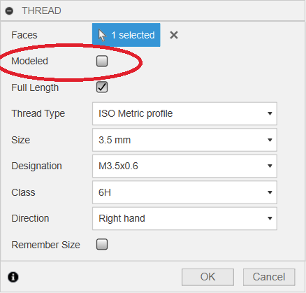

Did you select the 'Modeled' option when you created yours?On the fastener (brown) that I created from scratch, the thread is present. On the Fusion "insert fastener" screws (yellow) it is missing. Why?
Generally, threads aren't modeled as physical features in F360, there's just some sort of graphical clue. I guess this is to reduce the processing needed to display models that might have dozens of threaded fasteners in. If you want physically modeled threads, you need to select the check box above when creating them.
I don't know if it's possible to add modeled threads to imported fasteners - probably not (sensibly, anyway).
