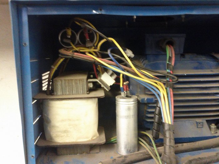

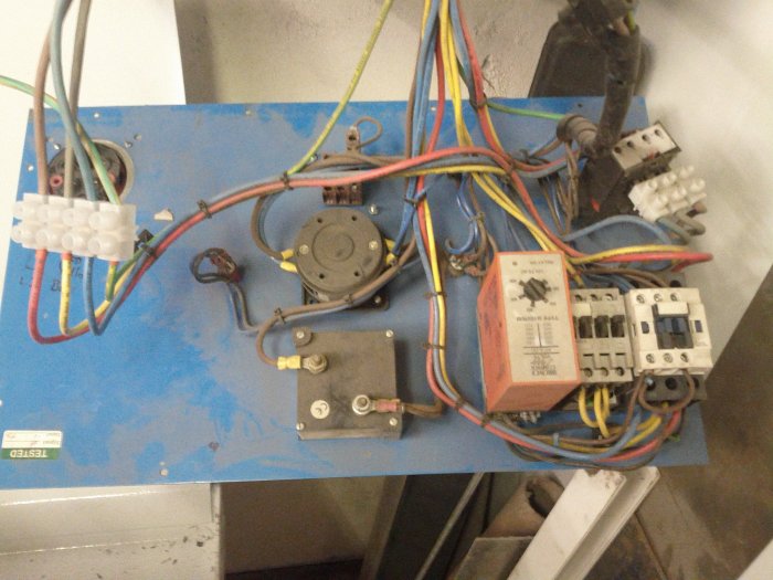

Sounds like a run capacitor is on its way out in the RPC. Does the RPC start ok? Have you checked the phase to phase voltages coming out of the RPC - if one of the run capacitors is failing one of the phases might have little or no voltage. If the motor is running on 2 phases that would account for the tripping and heat buid up.
Hope this helps!
