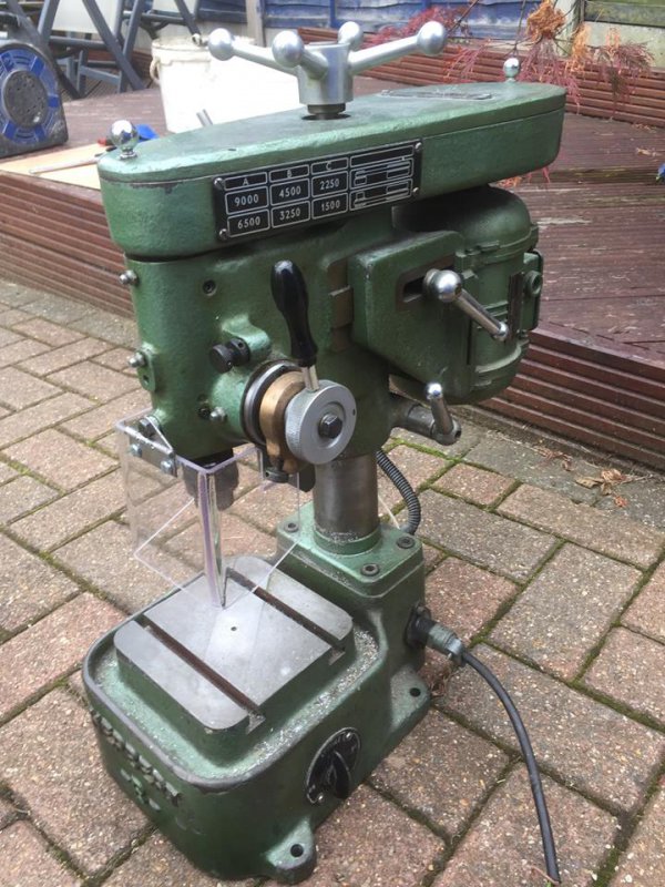

I'm picking this up on Sunday, it cost me £50. I haven't got it yet so all I've got to go on is the pictures uploaded by the seller but I can't see how the speed is changed, the seller told dad it was single speed but I don't really believe him as he seems to think (because it has tee slots) that it's a mill/drill.

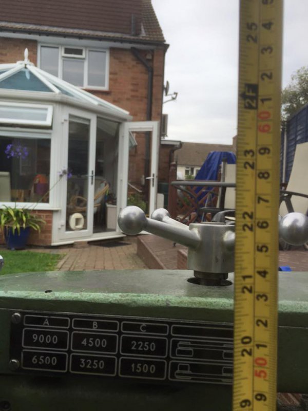

There's two steps on the pulleys to give two possible speeds but I can't see what the A, B & C refer to, any ideas?

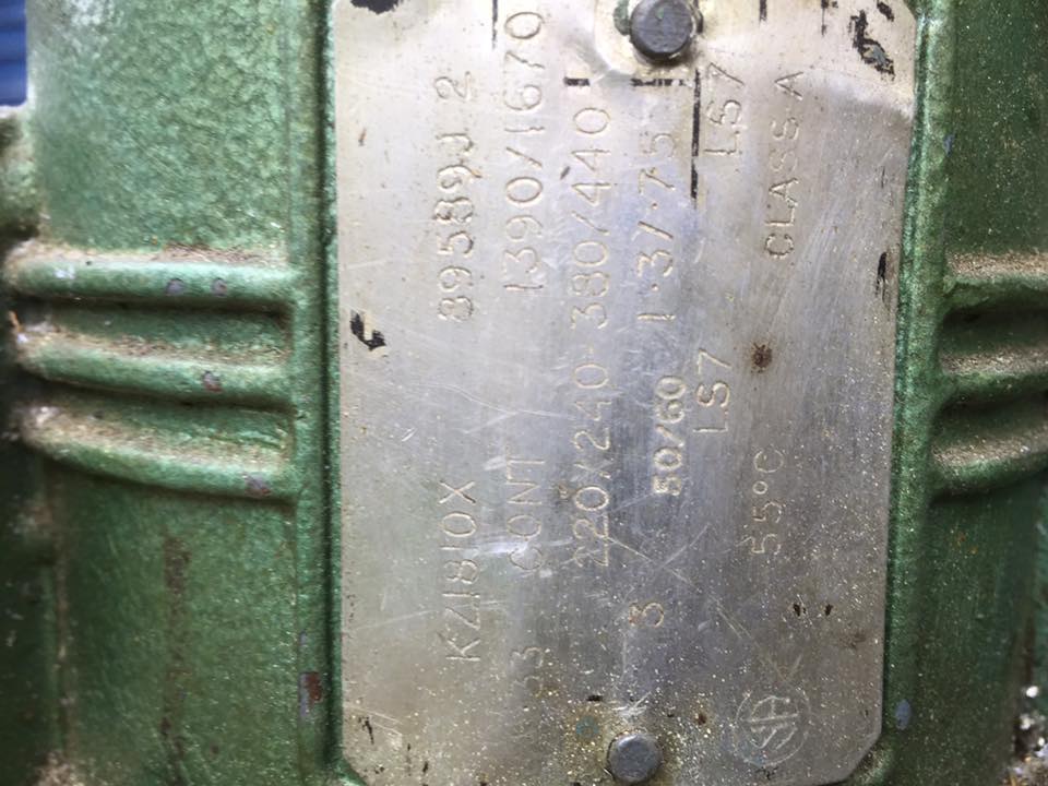

The motor plate is quite hard to read but it looks like it say 220/240/380/440, so I could wire it for 240v and run it off my lathe's inverter.
