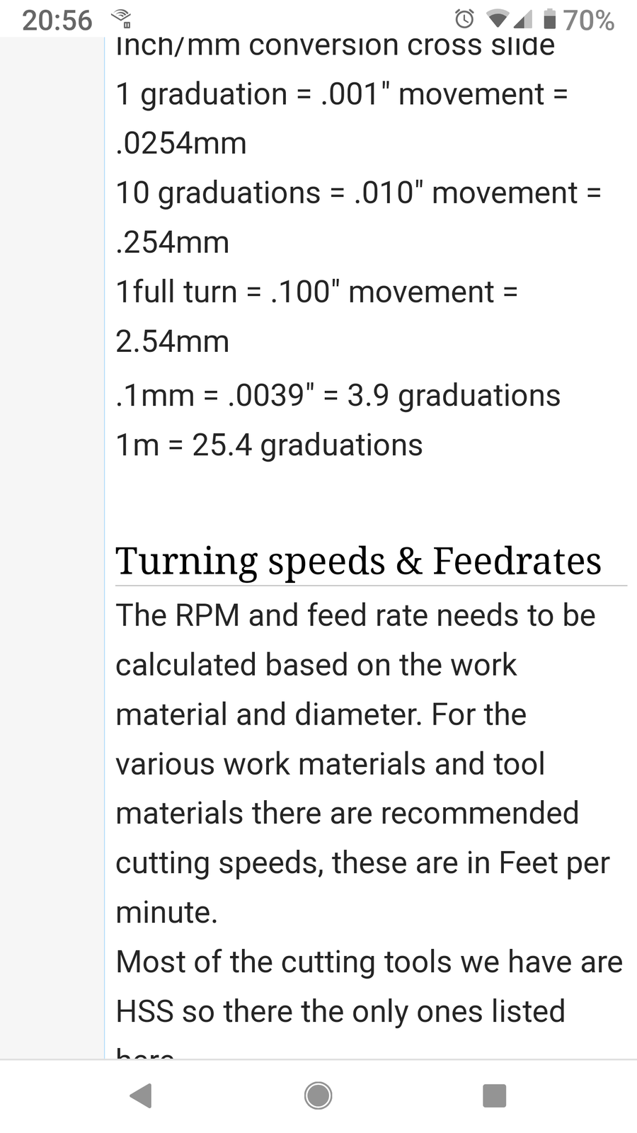

Inches, mm, it doesn't matter.

Yeah basically.so on my scale on the dial it is 0.1-0.9
0.1-0.2 is 0.25mm?
0.1-0.2 is 0.25mm?
