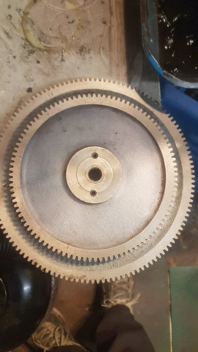

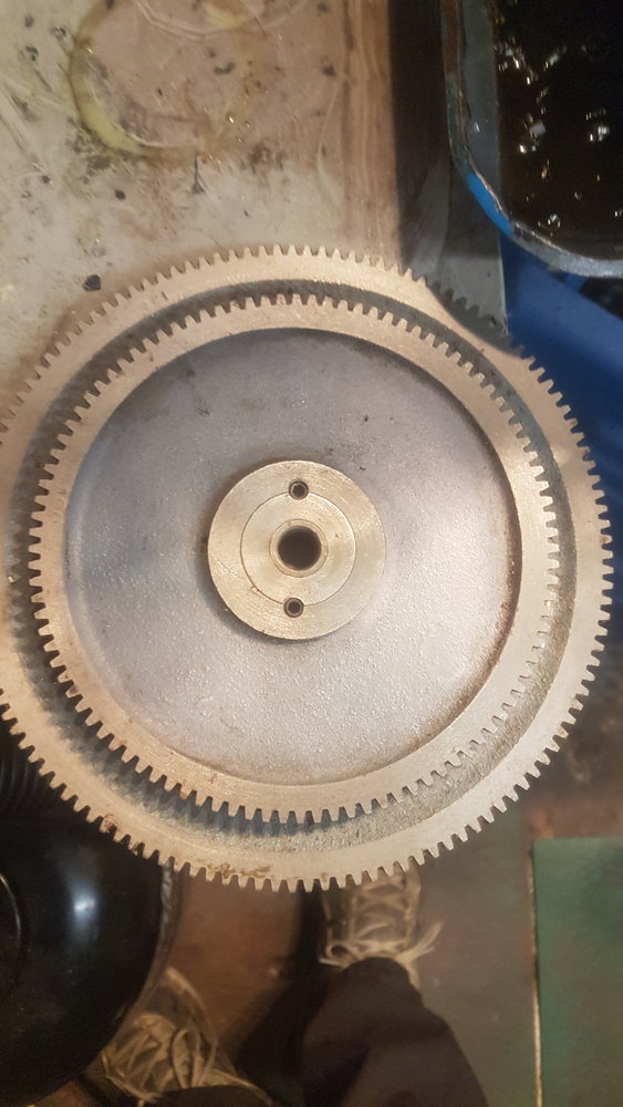

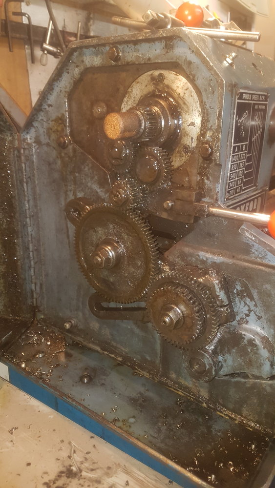

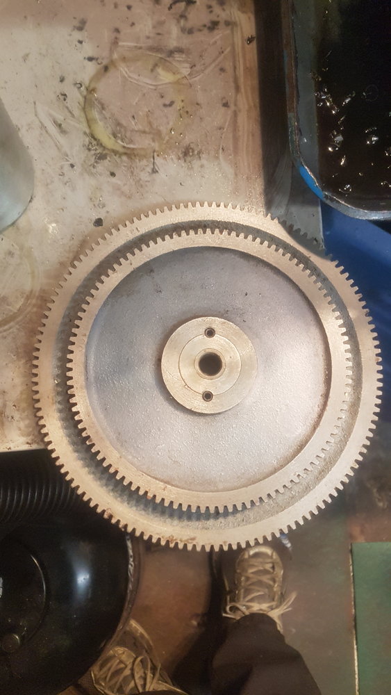

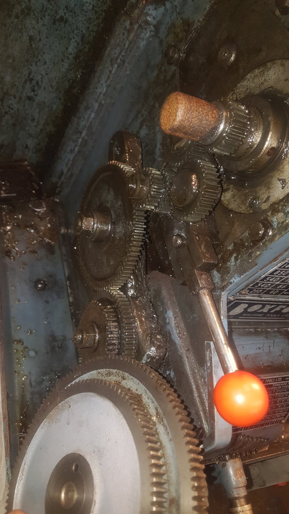

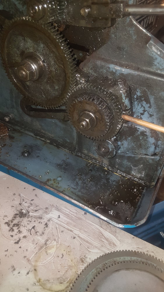

OK got it it goes in the middle in the sliding part. Why are there 2 gears stuck together?

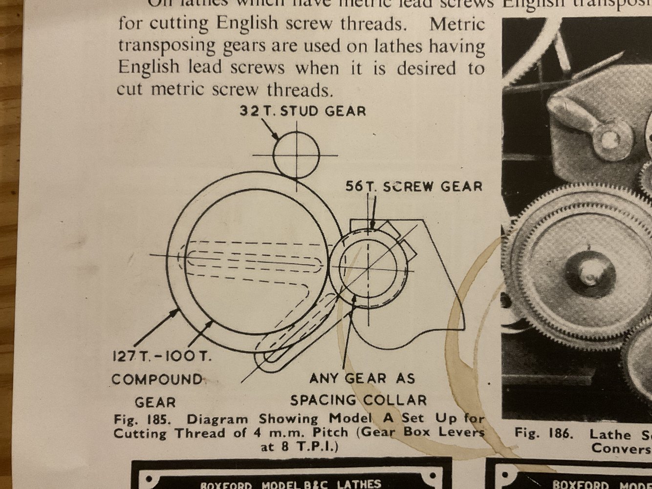

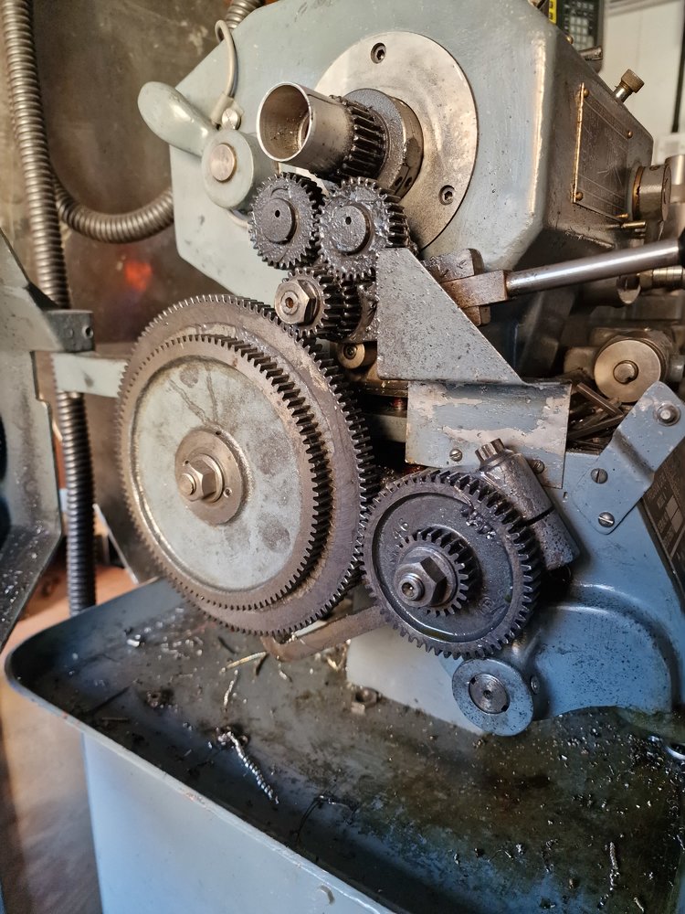

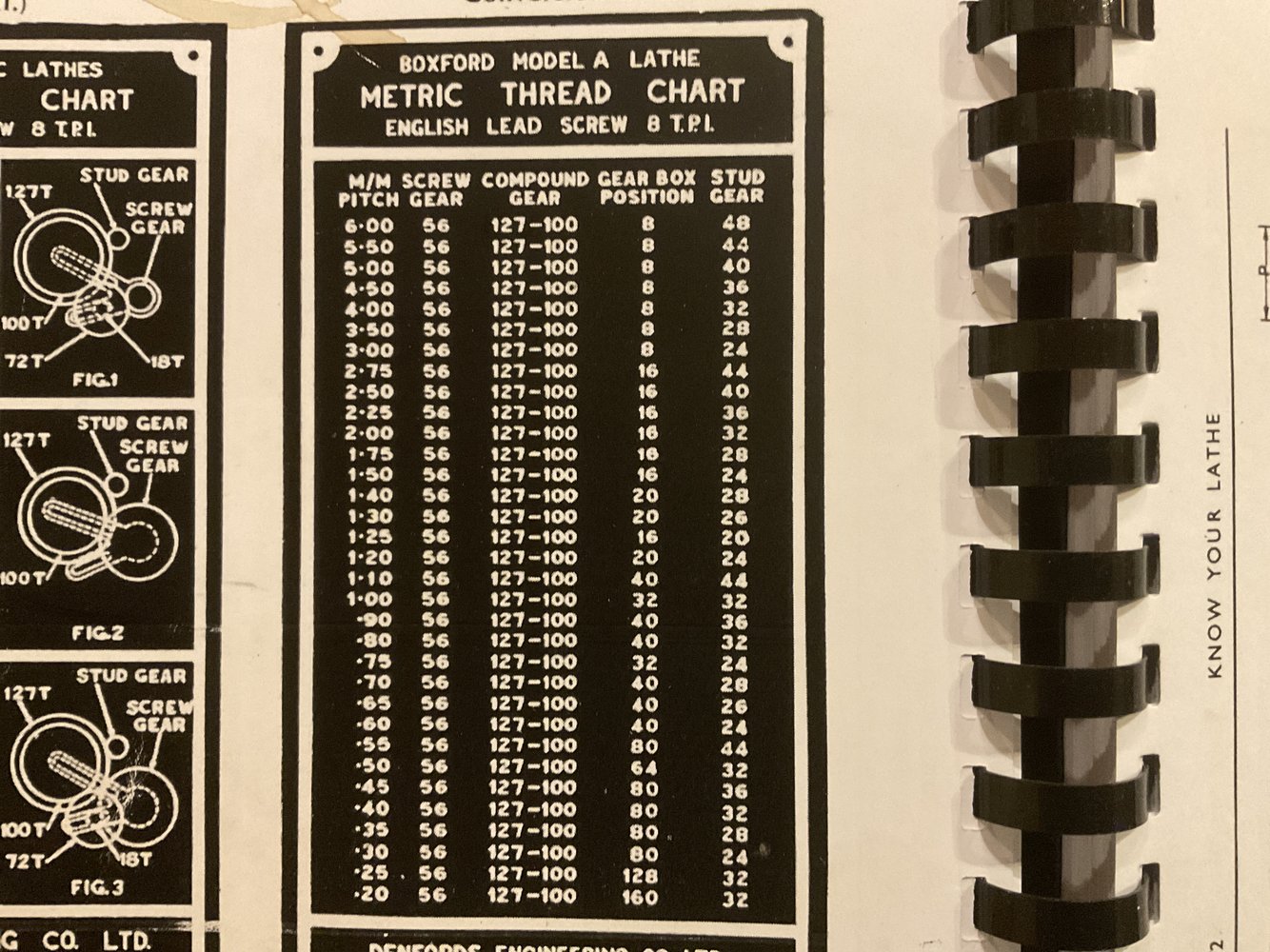

ok I see so you flip the double gear overYou normally mesh the smaller (100t) of the double gear with the screw gear (on the right). Pic above is not converting to metric.
No, leave the double gear as in the photo, but mesh the screw gear with the smaller of the two. I’ll try to find a pic.ok I see so you flip the double gear over
Mr Seadog's photo is Mr Seadog's lathe, if you don't mindMr Seadog's photo is probably a 'stock' photo showing the general principle, not one specific to your current need. In his photo, since only one of the gears is in use, it is only acting as an idler - not changing the ratio in anyway whatsoever.
As Mr Guineafowl says, for converting from one set of units to the other, both gears need to be used.
Nook I see so you flip the double gear over
I’m not in the pub, but am drinking homebrew. Together, we can explain itI'm in the pub. You flip the two gears around on the gearbox shaft.
