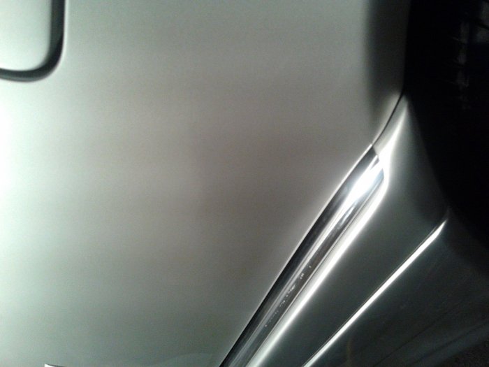

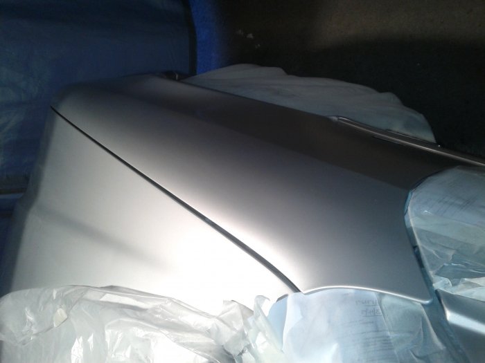

I used upol 1k ready for use on some mirror backs I painted, went on really well but did dry dull so needed wet sanding and polishing, I presume 2k paint with uni binder is very similar as it converts the paint to 1k. I am going to try my high build primer with normal hardener but roller it on see how it compares as with the unibinder you have to take more care when sanding especially dry as it picks up easy. I will probably use it on my top coat as I don't want to spray 2k. Another option with primer is use my compressor for a mask and a cheap earlex hvlp to spray the primer, which I may do after my trials with a roller.
The unibinder is ok but not as good as proper 2k, in fact for the ease of use I would probably use upol 1k clear in preference.
why use a hardener with your high build attall?
