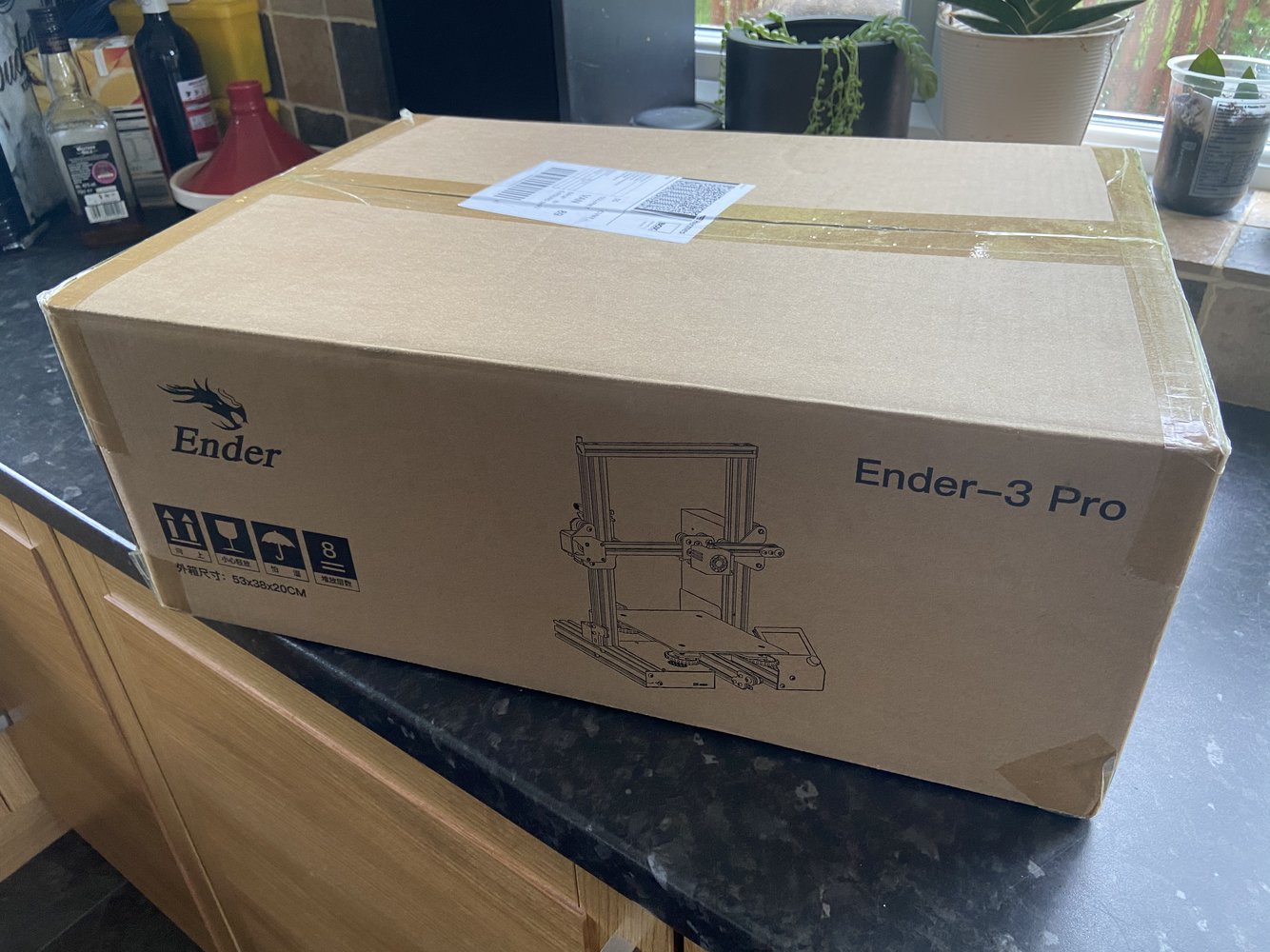

I thought some bright spark said it was easy to use!!!Ender 3 is a reasonable printer.
Main tip for building it, is have an engineering square handy for making sure you get everything square when you assemble it.
Rollers/belts need adjusted so things still run smoothly, without being slack or too tight.
Starting point for the bed height, is home the machine, then use a sheet of regular A4 printer paper as a feeler gauge to level the bed.
You may find you need to physically adjust the Z home switch, so the bed springs have a bit pressure on them. A common upgrade is to replace the springs with silicon buffers, but I've personally never bothered.
The included SD card has 3 example files on it.
Dog, Cat, and a Piggy Bank. Dog is the smallest file to print.
I'd recommend some 3DLac for helping with bed adhesion/part removal. 3DLac is just glorified hairspray, but given how long a tin lasts, I've never felt the need to experiment finding a cheap hairspray that works.
Once you've managed a test print, I'd suggest looking at slicing software (this is what takes a 3D model, and slices it into layers, before generating the g-code the printer runs on).
Ultimaker Cura: Powerful, easy-to-use 3D printing software is probably the most common.
You will need to configure it for your printer. I would send across my file, but I'm not sure I still have one for my printer before I added an all metal direct drive head, but the key settings are saved at the top of example files if you open them in a text editor.
Using the built-in mini-sd card is a bit of a pain, but I'd endure it until you get a hang of the basics.
I personally upgraded my printer with a Big Tree Tech SKR mini E3 board (direct drop-in replacement for the original control board, but is 32bit based, with silent drivers), and their drop-in replacement touchscreen which has a full size SD-card slot and is much easier to handle than the mini slot in the controller.
I am however considering adding a RaspberryPi with Octoprint, as I have been doing more production type stuff lately, where clicking send to printer would be easier.
As has been mentioned Thingiverse - Digital Designs for Physical Objects is probably one of the most popular sources for 3D files, but does have a bit of a reputation for being flakey.
