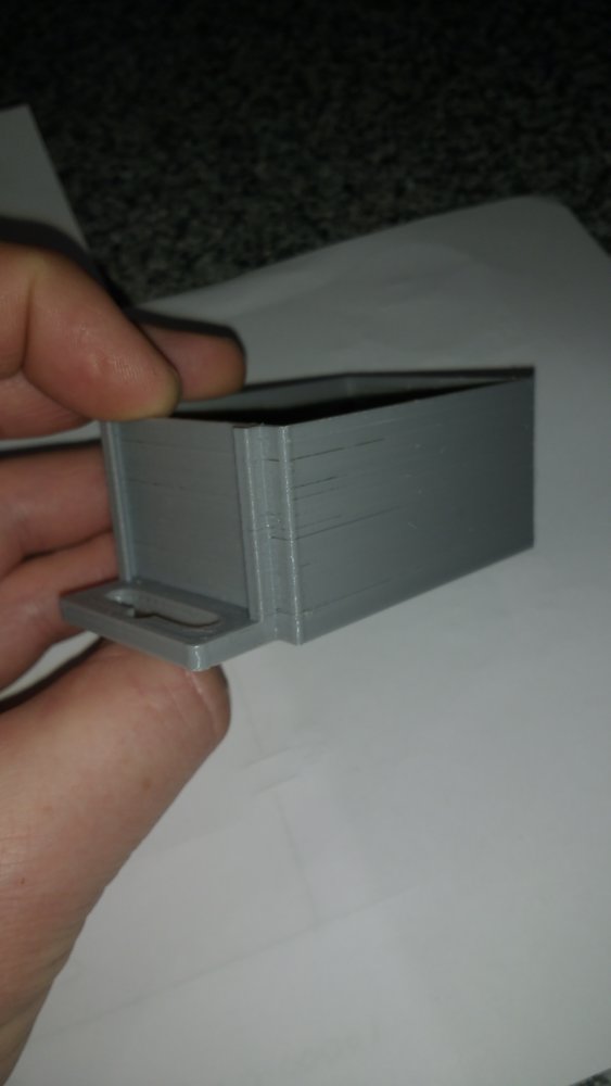

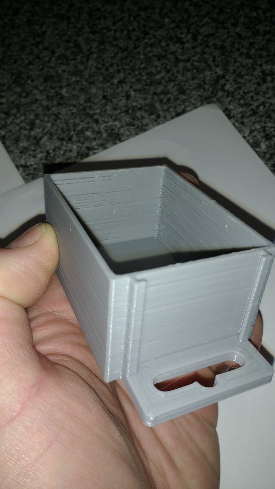

However, close up they're not perfect. I don't know what layer height he used but to my mind the layers are a bit open in places and the inside a bit rough / "hairy". Any suggestions?
Temperature a bit low I would say. I print PLA at 210 and 65. Send me the file and I will see how it prints here, if you like?
Certainly wouldIf you would be so kind, that would be great.

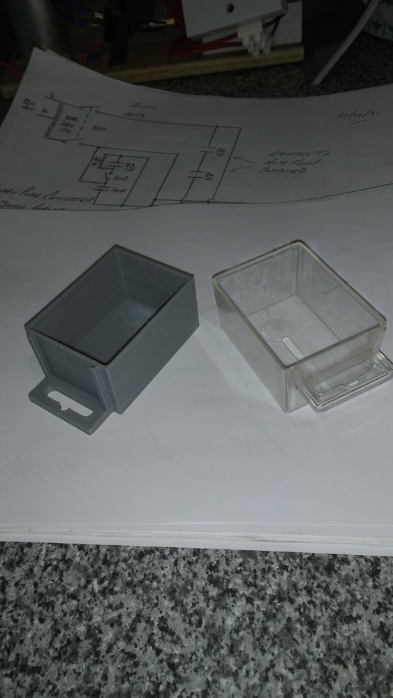

Send me the STL mate. I will run it through the ender 3 with Cheps settings.I commissioned No.1 son to draw and print some replacement small part draws. I've had so many of these cabinets, not bolted to the wall, fall over, spilling the contents and smashing draws I figured try this. In grey PLA.
My decision to drop the draw handle down low, means a bigger label and easier print.

File sent to @ukracer and @ajlelectronics . My lad printed the one above at 200 and 50 degC temps. Cheers for trying.

With the printers you have can you not change the temperature’s manually during the print process?
I have transparent PLA in the printer. The display is telling me that it is nearly a ten hour print, surely not?
Edit: Slicer says 3 hours 37 minutes.
I note that it uses 1.5mm wall thickness. I may be wrong in this, but I think that the best quality comes from a multiple of the nozzle size, so 1.6 would maybe be better.
