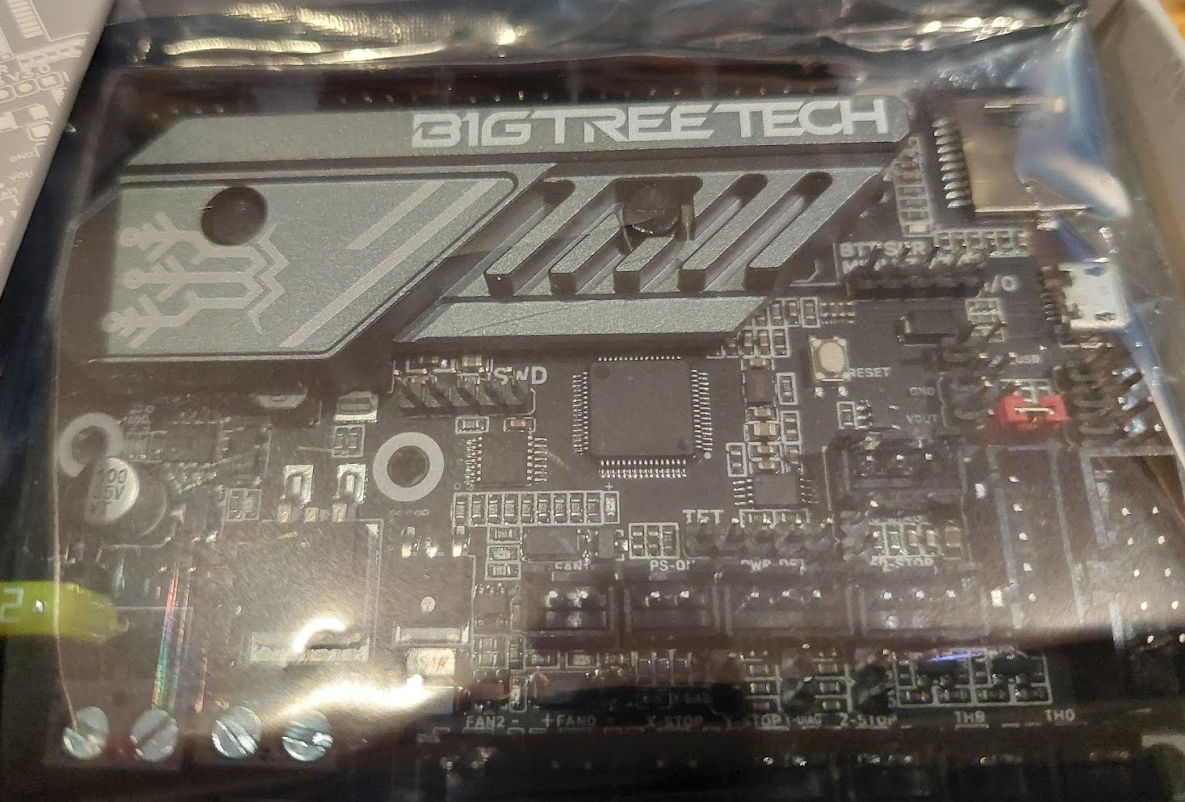

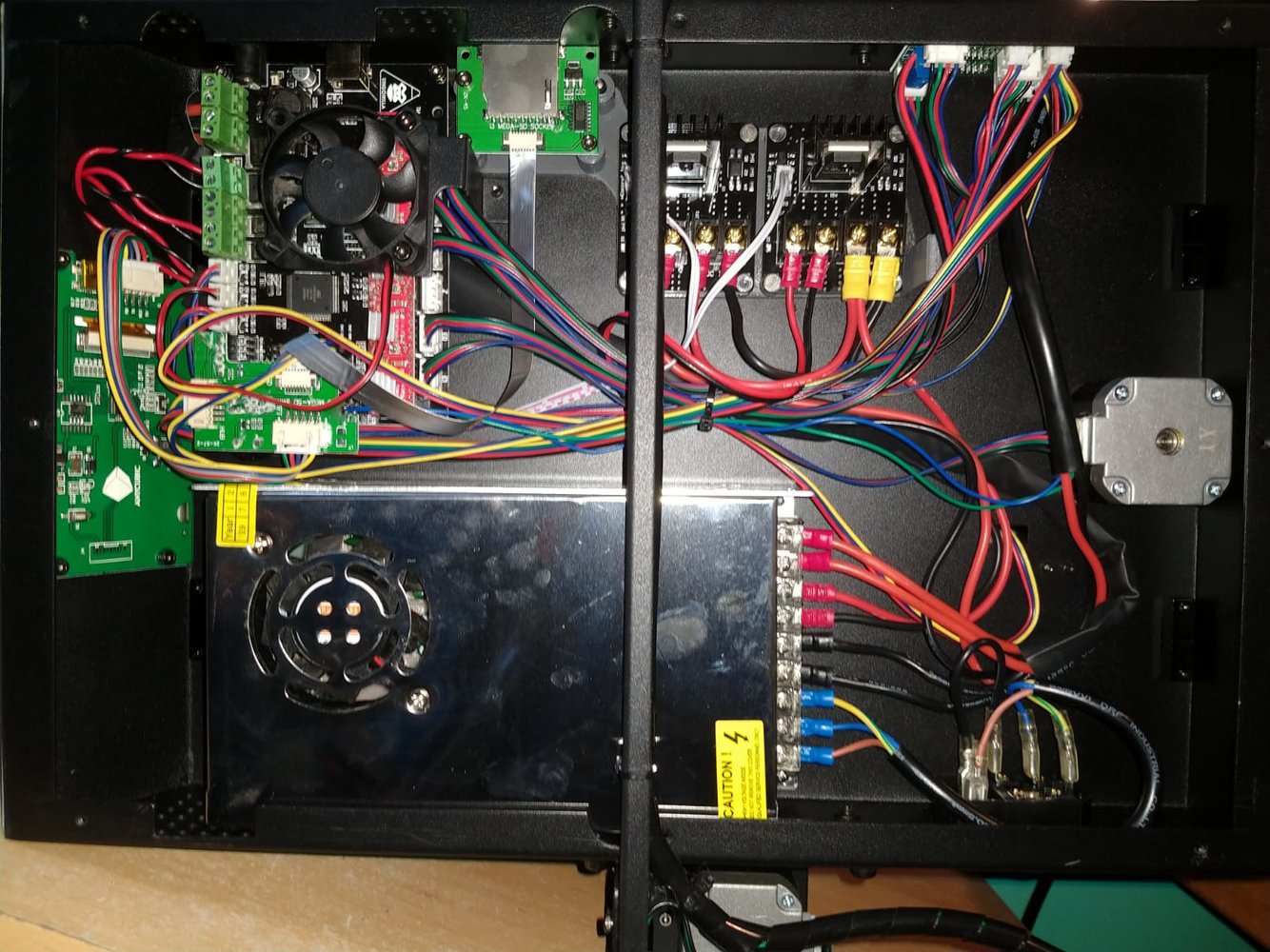

MOSFET boards fitted for the bed and extruder. Silicone cables and proper crimps where required.
On the mobo, the 3rd and 5th pair of green PCB terminals each with twisted red and black now signal the MOSFET boards rather than going direct to the bed and extruder. (It was the 3rd one down that burnt out):
These wires are soldered and heatshrunk over (to extend them) and plug into the MOSFET boards via the little white plugs.

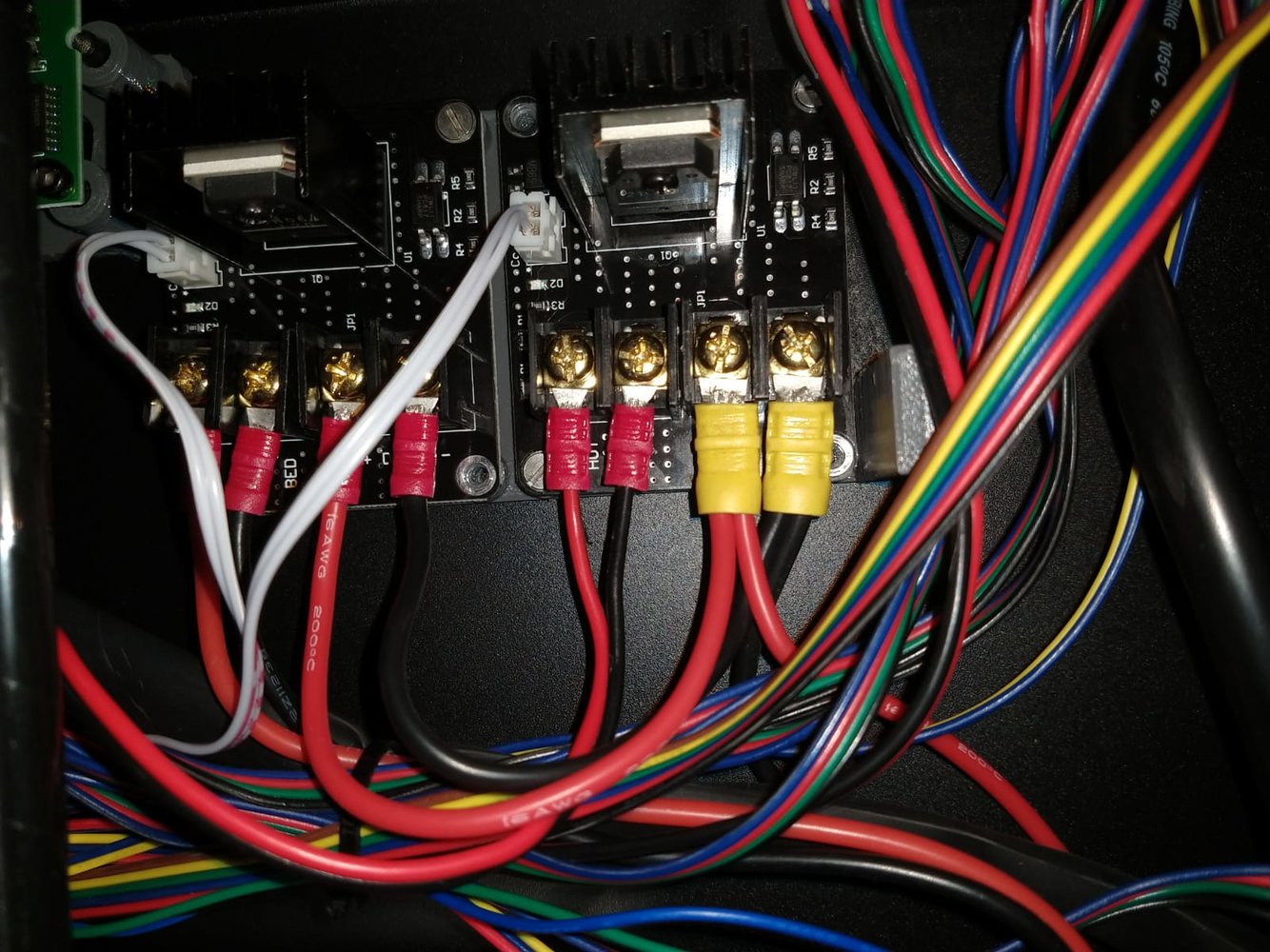

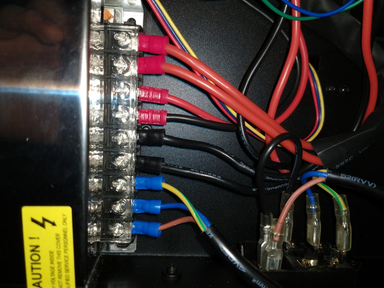

On the PSU there's a spare DC take off. The new red and black, silicone cables, come off where the 2 middle red crimps are:
These then feed the first MOSFET board via the yellow forks. Then daisy chain across to the other MOSFET board:
