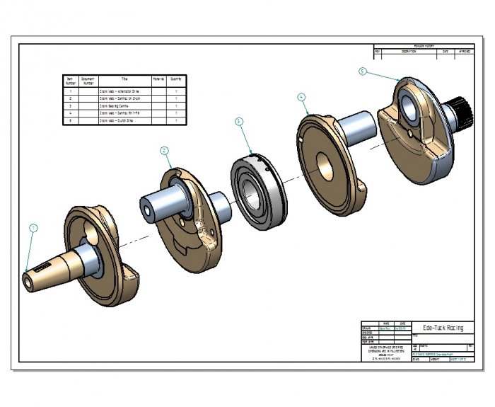

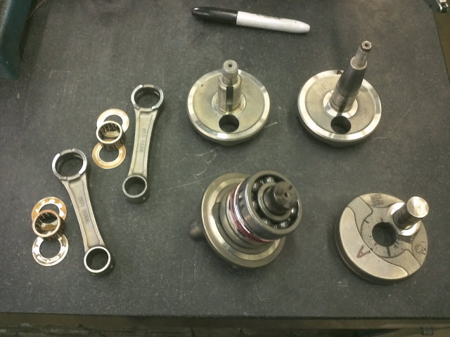

Manx norton crank ? I have only ever replaced the crankpin on a triumph tiger cub and that was simply pressed up , no crankpin nuts as used on bsa goldies for instance, but a low power engine, much as i suspect the two engines in question are.
A good few lads i know were having trouble with clutch centres coming loose on the mainshaft tapers on their bsa pre unit twins (a7 , a10) one fix is to make sure the centre is a good fit on the shaft , this being done by applying grinding paste to the taper and grinding the two parts together, just like a valve in a head, then finally assembled with one of the stronger grades of loctite.
for those interested
Well, it's not a Norton, but from the same era, though this is actually brand new.
Yes but meant for manx "replica's" ? I know for the bsa goldstars there are similar products, all greatly updated and strengthened for racing. When i win the lottery i'll have them all .............
This one's for an AJS though. Just as sweet.Yeah, me too. Dreams should come true!This one's for an AJS though. Just as sweet.
And that should convince the non believers!
With whatgettin fed up now
I put a few more pics and they disappearedWith what

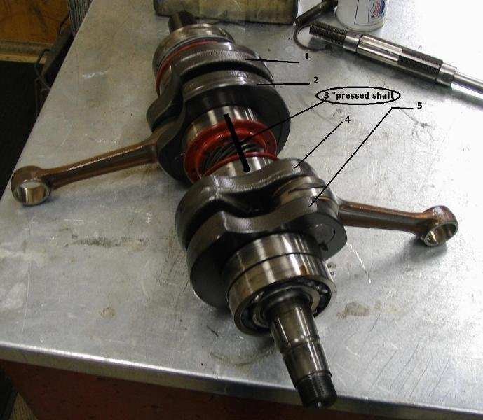

[Just another point , the norton commando cranks are three piece arrangements, a central flywheel with two crank sides bolted on. The bolts are very small in diameter 5/16" as far as i can remember, and looks like the whole thing would never hold up, but it does.
/QUOTE] Yes a lot of pressed cranks just hold with the force of the pressing mind you I have seen the ends of the big end pins tack welded for extreme power situations but never in standard form
Bit beyond the scope of a DIY build, but if you could get it done as a favour...Mowersman, you could have the pair electron-beam welded together if you can find someone to do it -Bit beyond the scope of a DIY build, but if you could get it done as a favour...
From the work we have done on this type of construction you would still have to machine the ends of the cranks to locate them, probably bore the ends out and fit a dowel to keep them square when welding. The welders would advise.
The weld finish is very good and you may get away with just polishing the journal after welding to remove any high points.
One point, and I might have missed your plan, how are you going to set the big ends to be in line or whatever you decide. I guess it will need a pretty accurate jig to be made?
Great job so far btw, enjoying the thread greatly!
