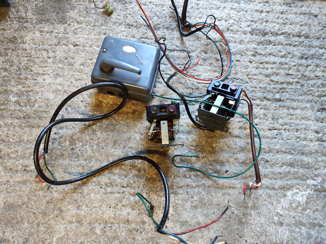

Good explanation. Thanks @Pete.Any stripped and serviced item will be easier to move but you have to ask yourself is the ease of moving the handle more due to the lubrication or is it due to the decreased magnetic resistance? It must take effort to switch that magnetic field.
At the end of the day if it holds the part it holds the part. For a person working at home not working to time constraints or with expensive mostly-finished customer parts then all it might mean is extra blocking or lighter cuts. It's up to the person doing the work to judge and as said above
One thing I will say is that it's not worth being naiive about whether there is any loss of magnetsm. The maker spells it out in plain black and white (my snips above are all from different generations of Eclipse official documentation). It WILL lose magnetism if it's dismantled. It could even be a benefit in some cases which is why electric ones have adjustable power.
@Smouser not seen one apart so thanks for that as never had mine apart, not that I have needed to, there is a reasonable bit of resistance from on/off and vice versa for good reason, wonder if your issue was more to do with the handle mech even tho it is better now? Be interesting to see what Eclipse come back with, if they do... Good work on the grinder![]()

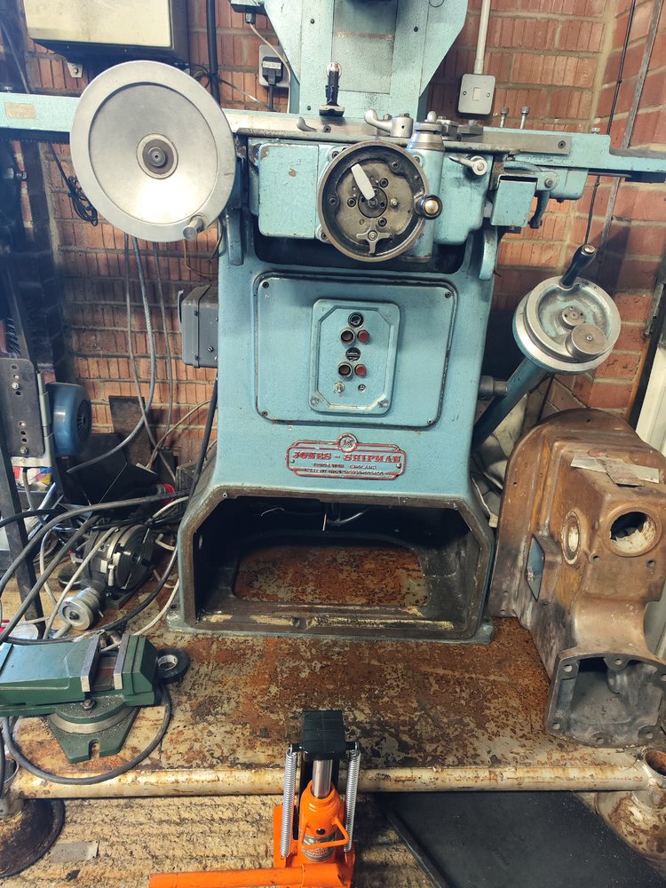

Secondly, I am not too sure what I want to do with the SG yet either. Will it just be a light strip down and clean to ensure everything is working or is it a complete paint stripping and repaint job? I will be the first to admit that I know next to nothing about surface grinders, the machine might be so worn it is not even worth doing anything to it![]()
This is true, I've never had one apart but the magnetism/resistance almost feels like a cam effect, hardening up and falling off - if that makes senseOne small benefit is that the handle can be put part-way round to give minimal magnetism for setting up.

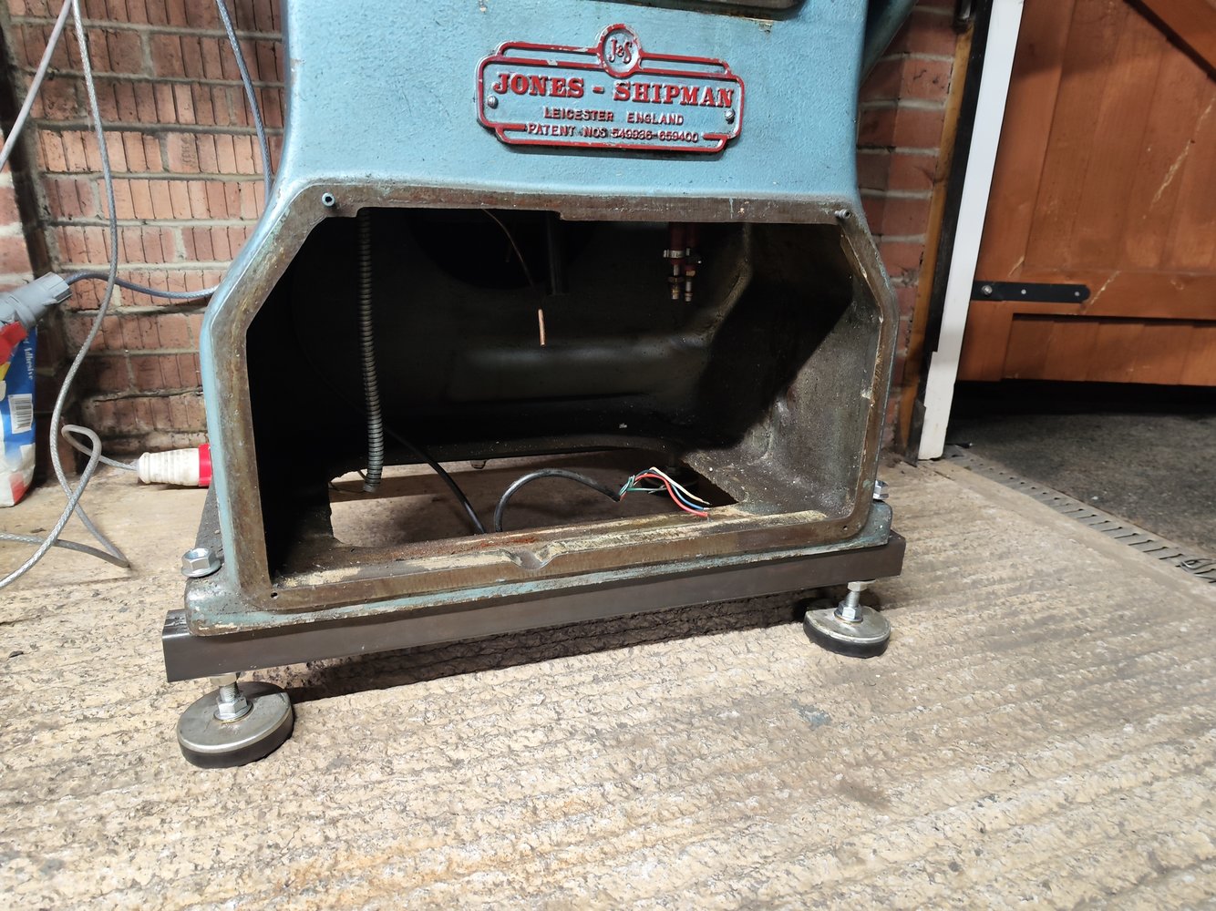

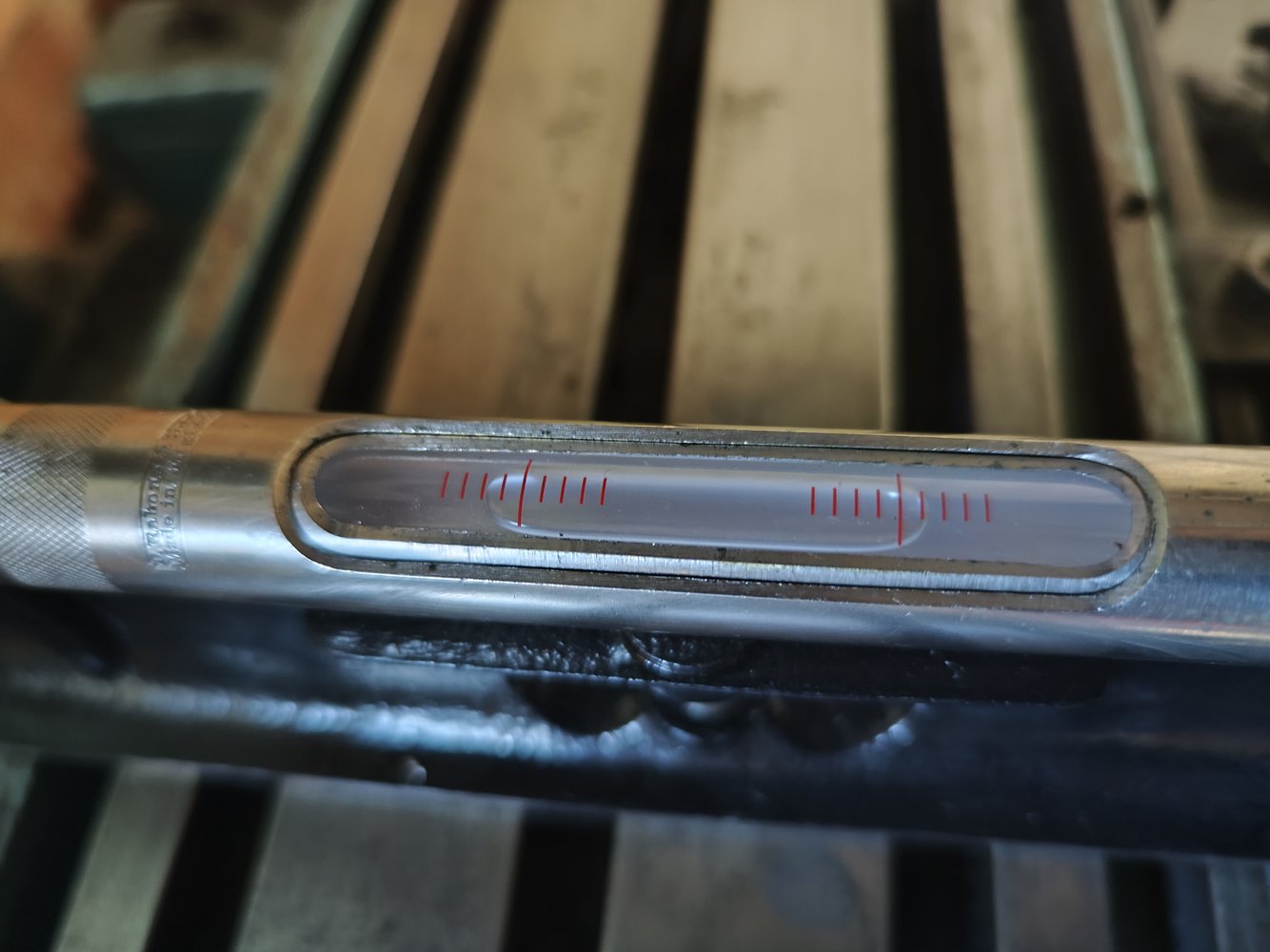

I suppose the whole machine needs to be level first for that method to work?My 540 was badly worn on the cross ways. This showed up by grinding everything convex. You can check this most easily by putting a sensitive level across the table and winding it from front to back. If the bubble moves significantly, your cross-ways are worn bowed.

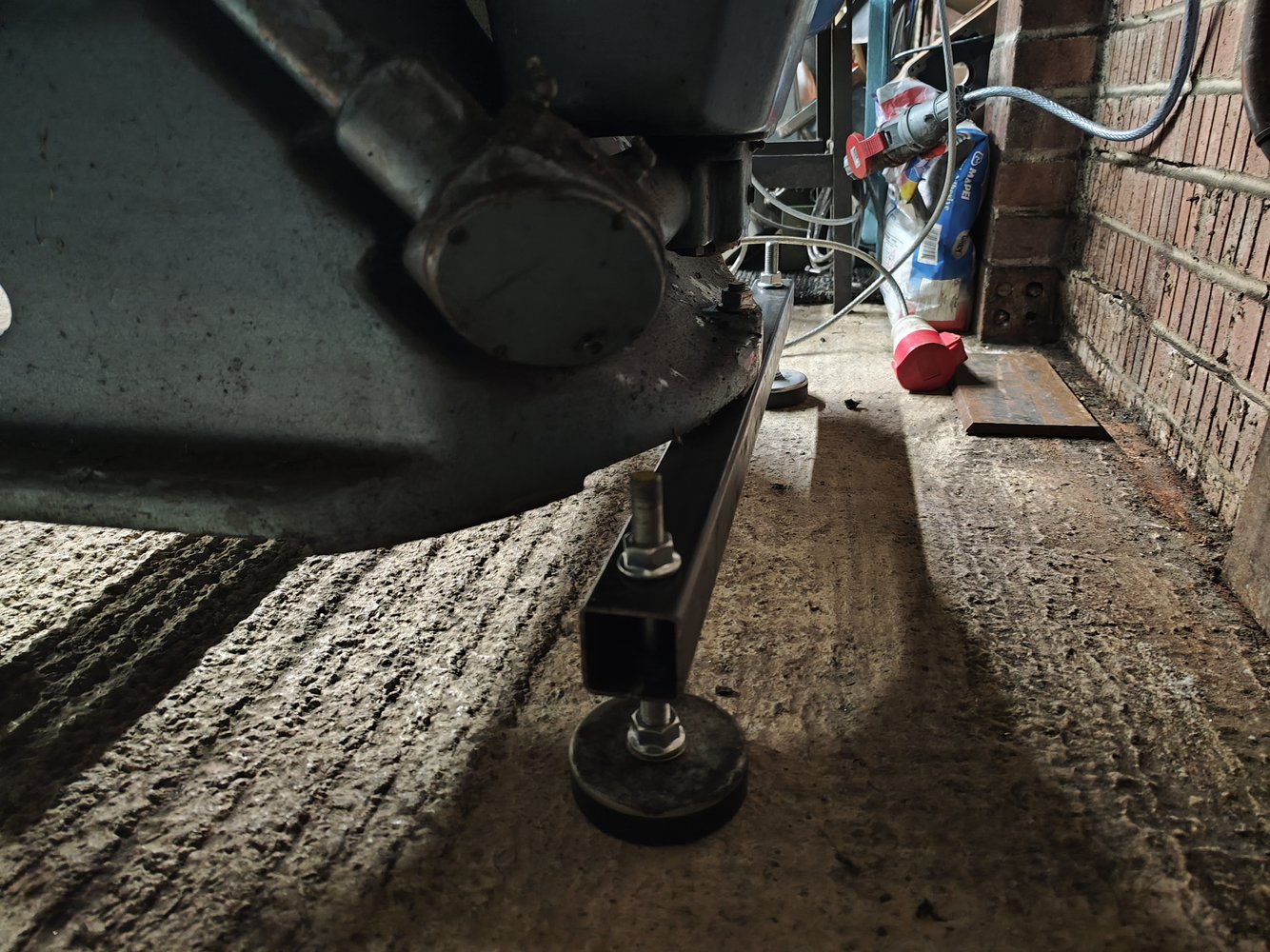

I quickly tried your method this morning, but it did not work because the SG is on a metal post pallet with too much movement.Nope, all you need to do is pack the level one end so the bubble is within the marks. All you're looking for is a change.

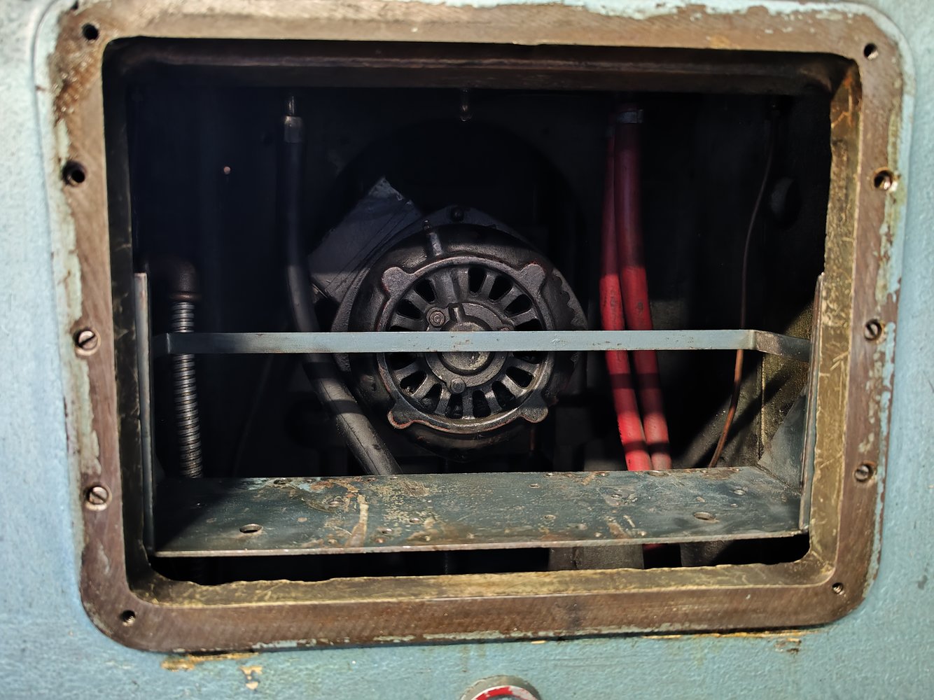

Thanks, that makes sense. I will probably go that route too. Take the table off to see if everything is clear and oil is getting to everywhere it should.I saw you posted somewhere about the oil getting to the y axis ways.

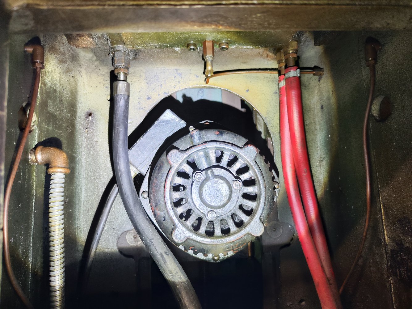

So when you take the table off and run the machine, you should see oil being pumped up to the ways, this disappears under the ram block, and should drain down to the Y axis, which will be evident by oil being returned down the return pipe or wetting the wipers (which i removed to see if oil drained out of the end of the v).
I was getting nothing.

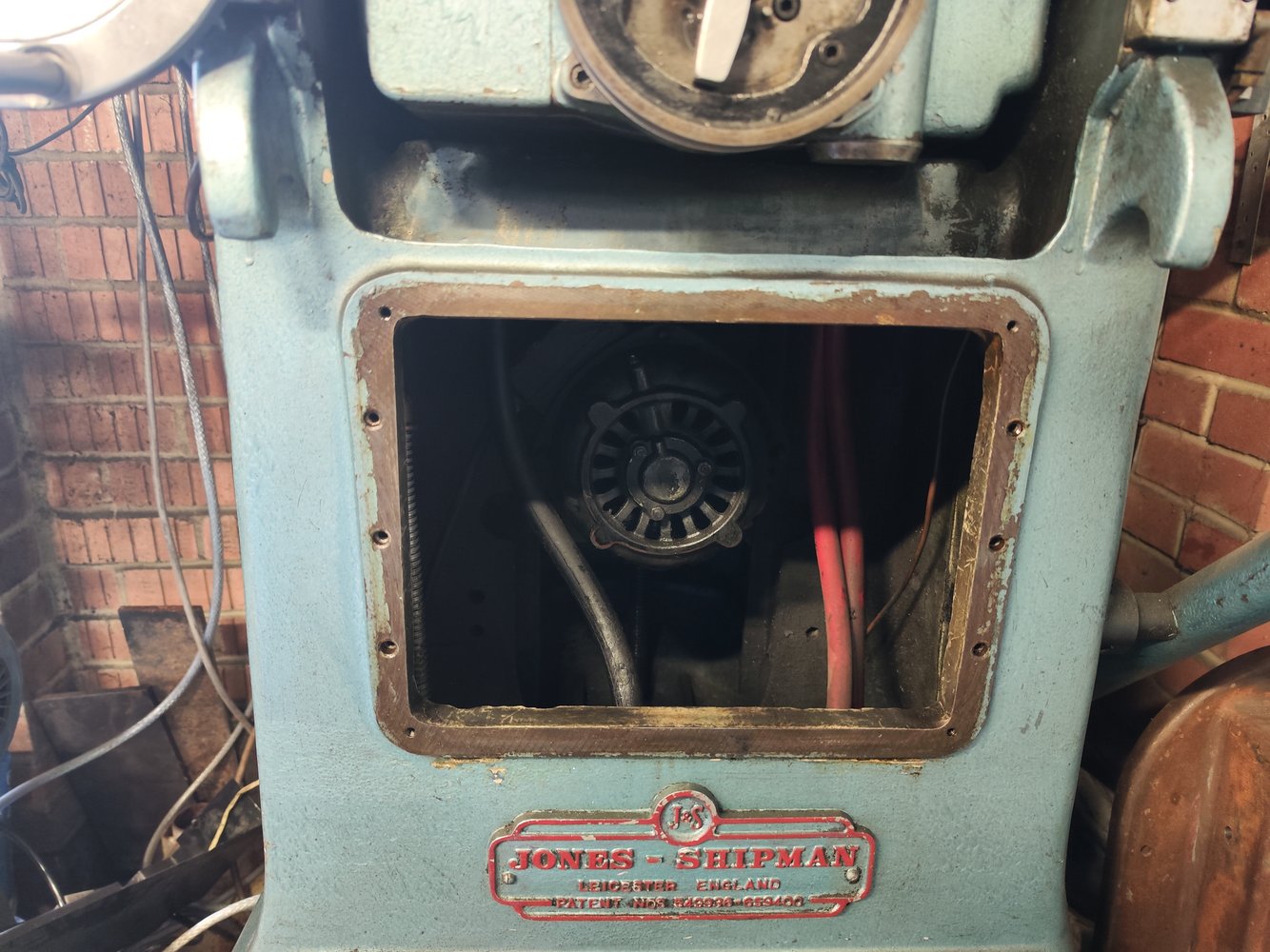

Seriously though brilliant write up. I collected a very very nice JS540 about 6 months ago. It is the 540P with the powered rise and fall head. Really good condition and got it at a brilliant price. Took about 15 hours to go and get it - load and return though - rather knackered at the end of it.
There is one problem with mine - table moves to the right fine but then won't return - it does sometimes but not always.
If I push down on the little trip lever thing it then returns the other way - possibly a stuck valve or spring?
