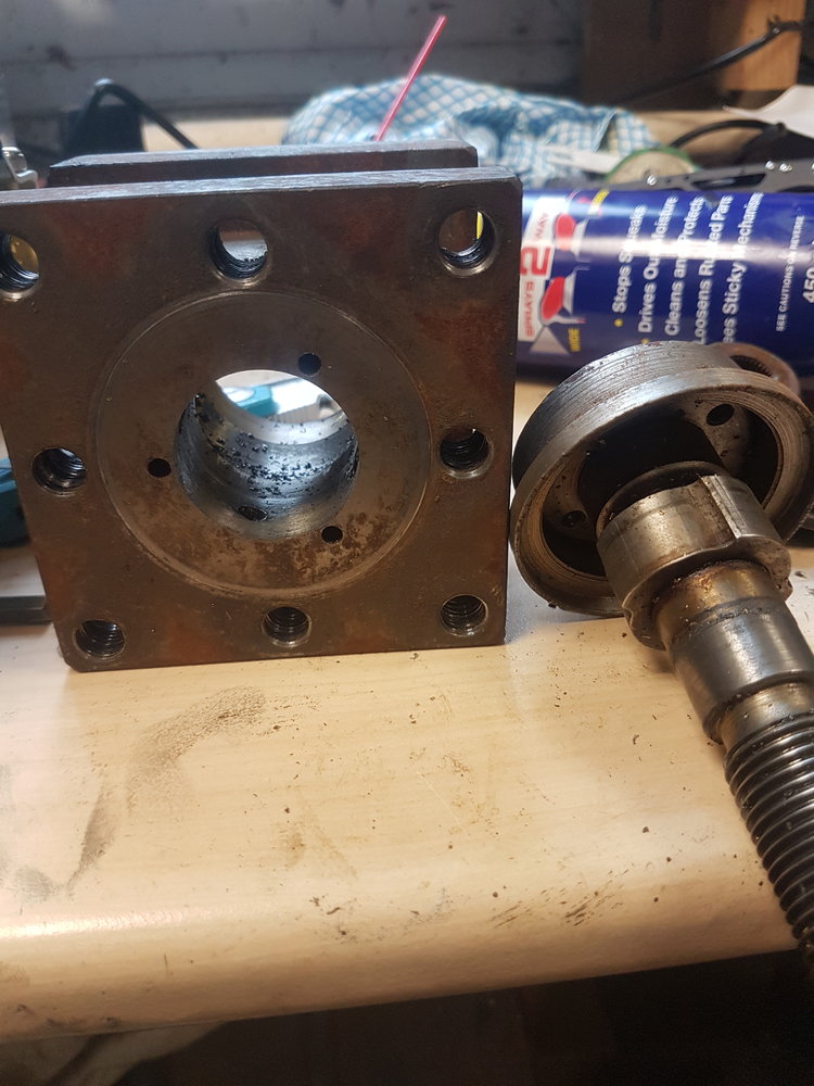

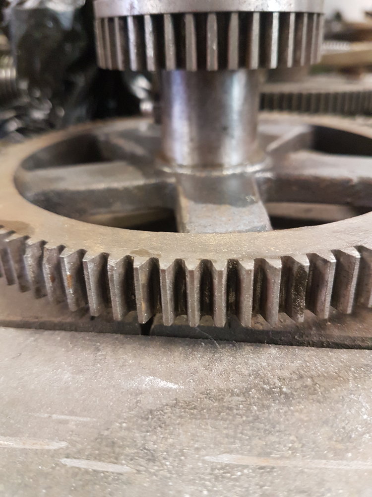

The spindle is way larger than mt3.That sliding gear is vulnerable to being run in 'neutral' and then chewing up the edges of the teeth if it moves in either direction. Certainly, that seems to have happened to mine at some point in its life. The gears mesh fine if fully engaged but have been seriously chewed up along their outer edges.
BTW, I noticed a comment in your original post about MT2 centres. Have you clocked that the spindle is MT3?
Yep, my spindle thread is 1.5" 8tpi. Taper is MT3 and the bore is 3/4".The spindle is way larger than mt3.
The tailstock is mt2. I suspect the spindle is mt4 maybe mt4.5
Edit, mine may have a different spindle to yours. Seems they did 2. Mine is 1.75" 7tpi thread and maybe 1 1/8" bore, maybe even a little bigger.
Yours is 1.5" 8tpi right?
I ha e been speaking to David on from Facebook, he had 2 of these lathes, one with each spindle size I believe.

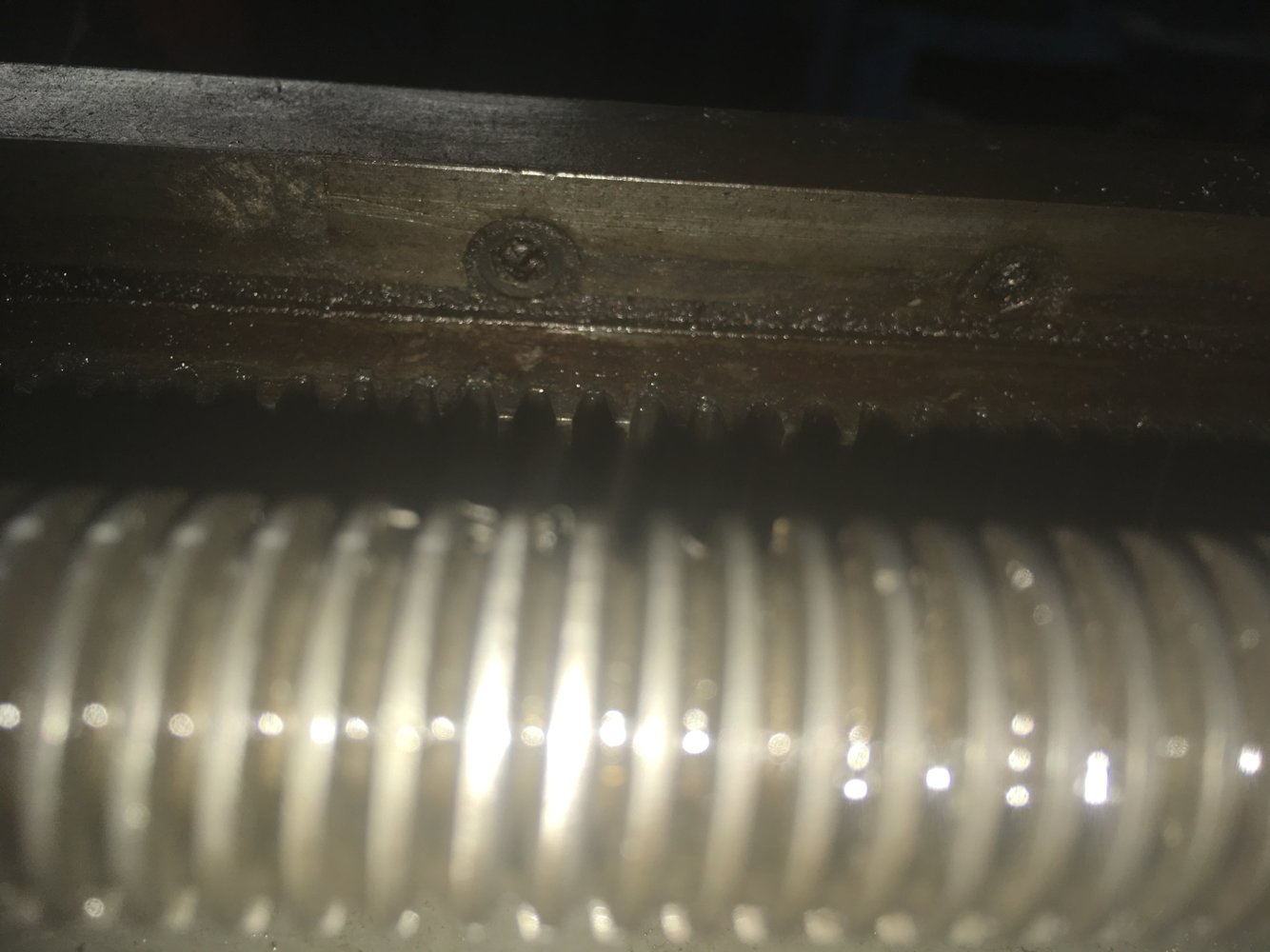

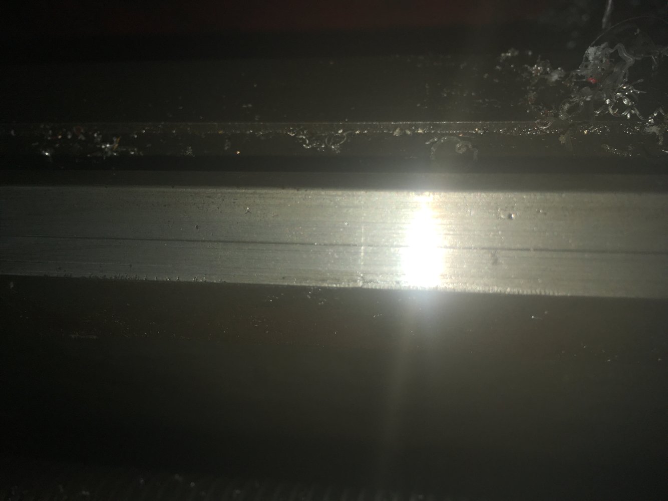

Is the V on the bed on yours removable? I think they normally are, but mine is part of the casting.
Thanks, the plate is still helpful.Yep, my spindle thread is 1.5" 8tpi. Taper is MT3 and the bore is 3/4".
I was just about to tell you my 'V' was part of the casting, too, but then I noticed that if I look up at the underside, I can see a row of cap head screws just in front of the rack. Once you look really closely it's possible to see that it is indeed separate from the bed and has a join in the centre as mentioned on lathes.co.uk - I had never noticed before!

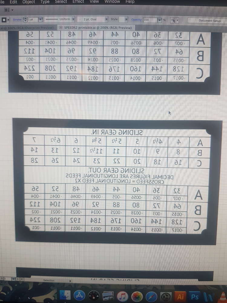

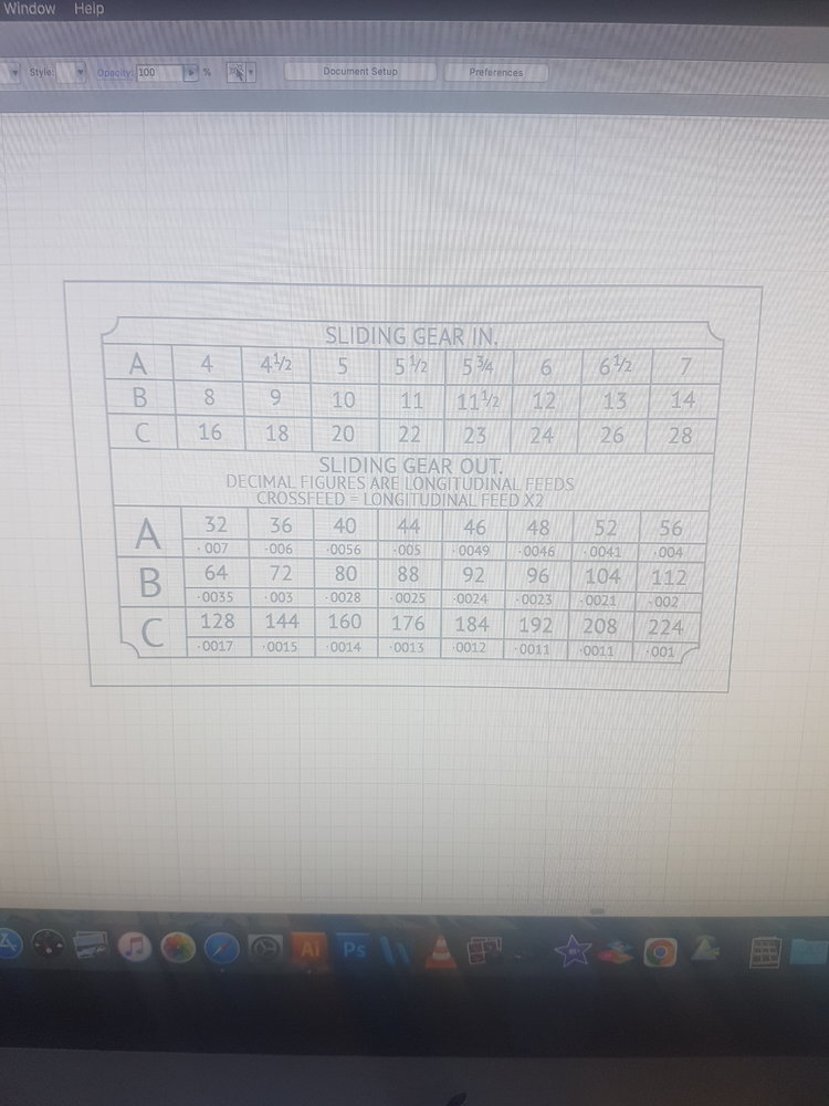

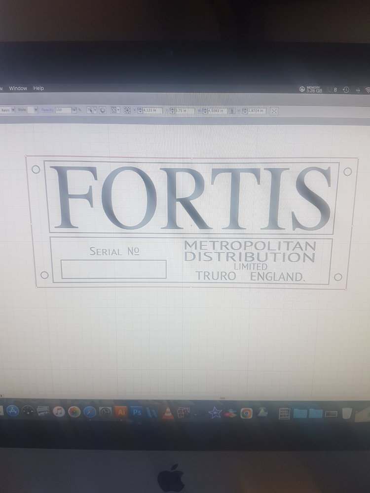

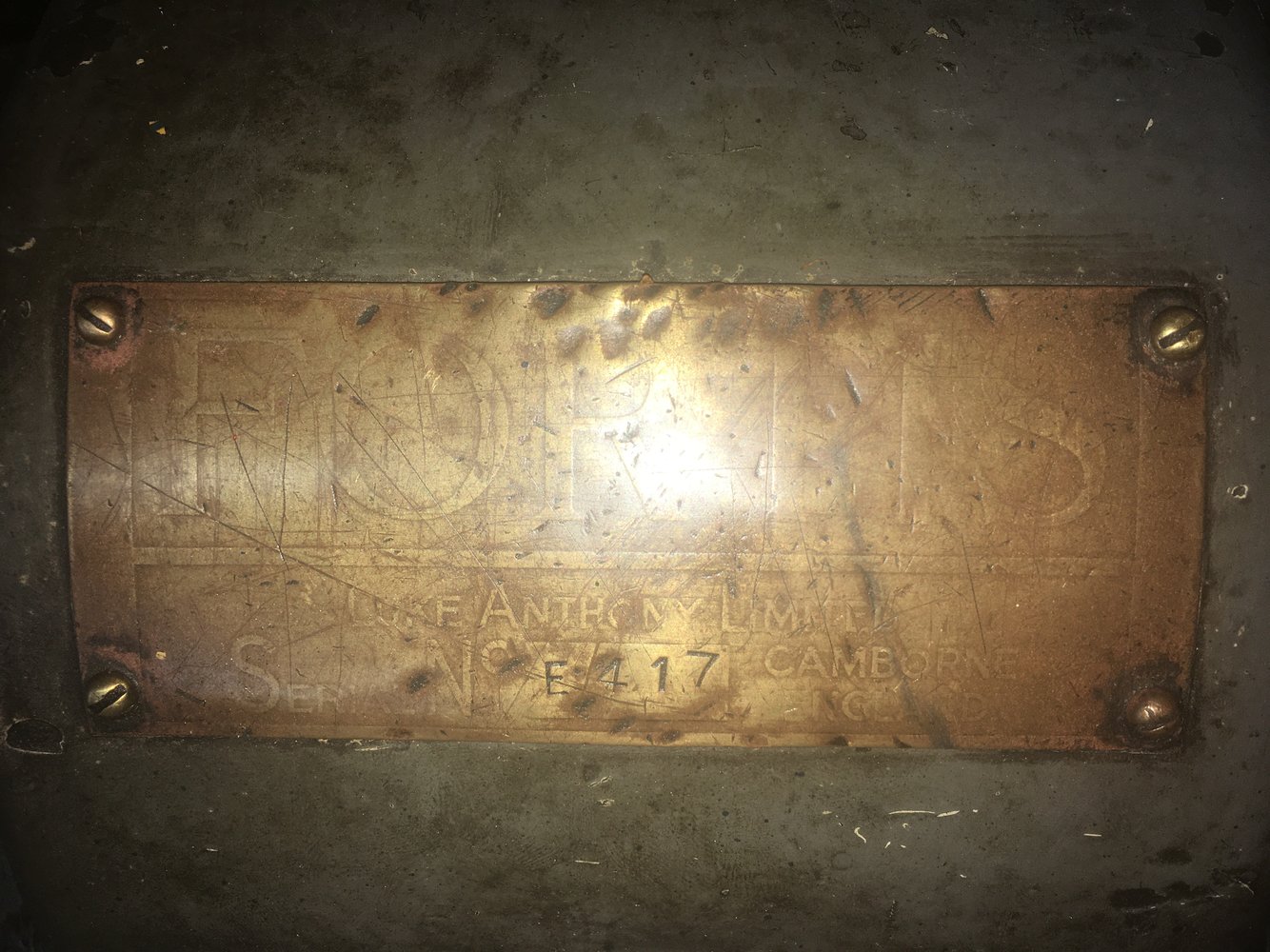

I've done my best to get a decent photo of the name plate but, as you can see, mine's pretty beaten up so it isn't at all clear.
Do you have access to a laser cutter?I hate computers!!!
View attachment 399471View attachment 399470

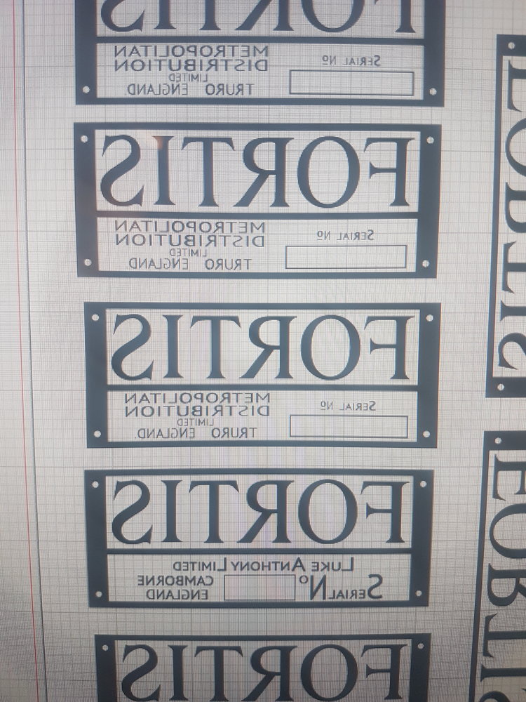

Some tweaking to do, and I'll do the other style of name plate, then I just need to learn a bit more about etching it onto brass.
I don't.Do you have access to a laser cutter?
If so:
• paint the whole blank,
• laser etch the paint over the areas to be etched away,
• then either acid etch with HCl / Ferric Chloride or electro-etch with a sponge soaked in brine solution and a high amperage 12V or 24V supply.
Super quick and pretty reliable for etching very high levels of detail, down to depths up to around 1 to 1.5mm.
I don't.
My plan was to do a toner transfer, probably from acetate.
Not sure how crisp it will turn out though, not tried this before.
The electro etch sounds interesting, I'll have a read on that

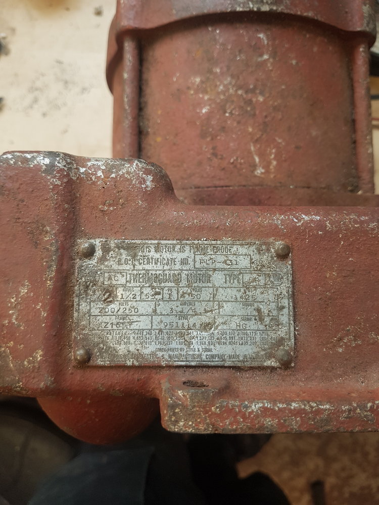

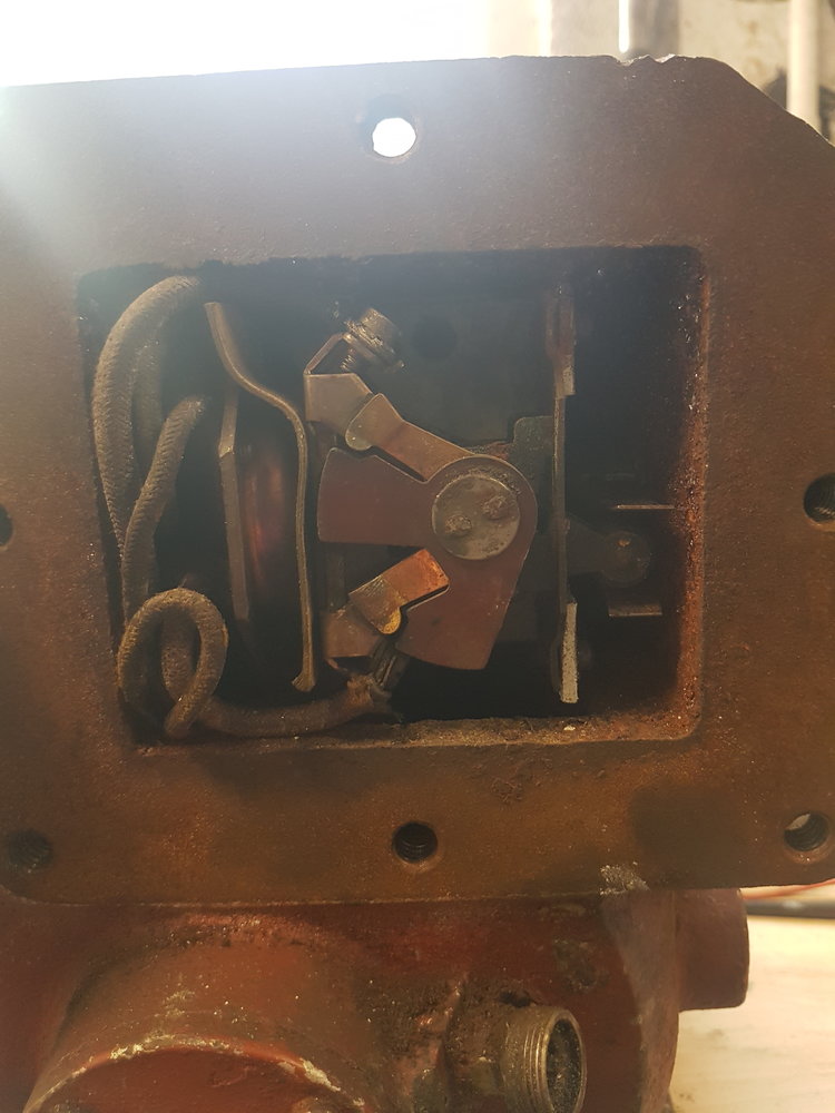

Got the motor out.
Although obviously not the original, it's 1/2hp. Sound about right?
It's a thermoguard and has this odd (exposed!!) Switch set up. A thermal cut out switch?
View attachment 398428View attachment 398427
It's 1425rpm so don't know why it would be too fast?
Thank you.The electro etch is much faster and gives you visibility as you're doing it...
But because you're manually moving the sponge over different areas, it's harder to maintain completely consistent depth of etching on a large part, definitely worth doing some test pieces to get your hand in, it also produces some wicked fumes so best done in a well ventilated area or with a suitable (Type ABE or ABEK filter) mask on.
If you don't have any luck with the toner transfer I'd be happy to sort you out with access to a laser cutter locally to try that approach.

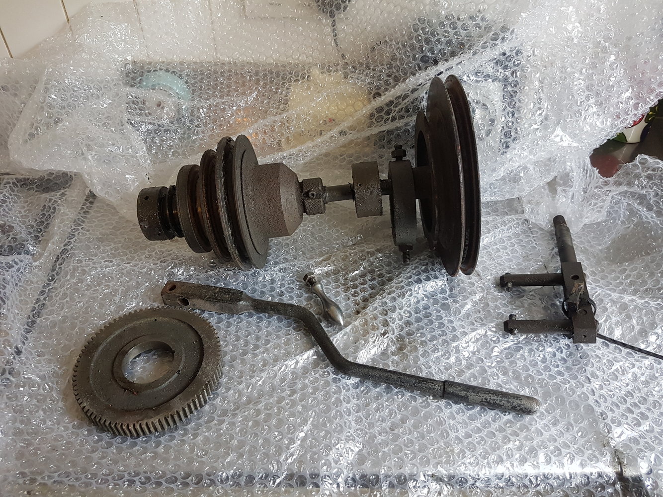

That's very cool you managed to source the clutch .The power of the internet!
A lathe made 70 years ago, in limited numbers, with probably very few surviving and within a couple if days of buying it I get a clutch/brake set up.View attachment 399561
Thanks to mr_luke_too, and thanks to David if you ever see this thread.

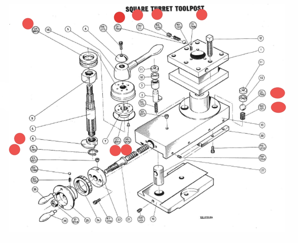

I think I have a complete toolpost the same as that. Actually identicalTook the tool post apart.
It's deffinately this type and it's missing all the bits with red dots.
I can't read the part numbers though, but I'm sure I could find a readable image.
I also assume however that parts are either not available, or expensive.
I guess my best bet would be to either use it as it is, get a replacement, or change it for something else.
The locating pin is still spring and not stuck, just quite stiff, so if I tighten it at an angle other than 90° it will still clamp down.
Only thing I really don't like about how it is right now is how thin an edge actually transmits the clamping load from the handle. Is it always like that, or for the part that looks like a heavy spring, or a thrust bearing, normally provide the clamping surface?
