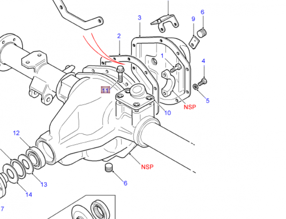

I think my memory's going, can't remember that one
I'll second that. Can't think of a big nut on a Landy that needs to be that tight.
Not a huge amount. I think it's about 4kg or so.
Just checked the RR classic factory manual and it's 1.16 - 1.46 kg I think Defender axle would be the same?.
Depends if you're pre-loading with the swivel seal in place or not...
Just ordered a little digital one for £3.70 want to have everything ready to hopefully rebuild axles next week maybe, let's see

That's the reason I bought them all like for like from Landrover.If you do, because of the job they do, alternating high shear loads, watch what grade of bolt you get. So probably best to stick to OEM for this.
