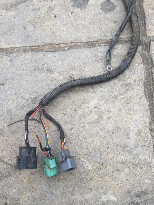

I've used Vehicle Wiring Products for the bits to make looms, they stock quite a few connectors... and a wide range of the crimp terminals used in them and others so it's often possible to re-use the old connector shells and click new terminals into them.
I'll have a look
I need to make it myself as I can't source one :'( Worth investing in something like this for removing terminals from shells.
I need these too. I couldn't remember what they're called
but I'll order someSo have I but if I'm going to do it id rather have the right tools for the jobI always found those little jewellers' screwdrivers did the job quite well, if a little slower (and fifteen quid cheaper)
saves a bit of time I guessA terminal removal tool is highly recommended, some terminals will be impossible without one. Use tinned wire, after crimping the terminals, a touch of solder will prevent future oxidation. If you need heat shrink, only use adhesive lined stuff.
What he said; 70+ years of aerospace experience says crimps should not be soldered.Sorry to disagree Hugh, but DON'T solder - it will wick up the wire making it inflexible and highly likely to fatigue break.
Over three times longer than I've been aliveWhat he said; 70+ years of aerospace experience says crimps should not be soldered.
sorry I'll let myself out
Over three times longer than I've been alivesorry I'll let myself out
I won't crimp them. When i come to do it I'll ask if I have to do anything but have no fear I won't soldier it![]()

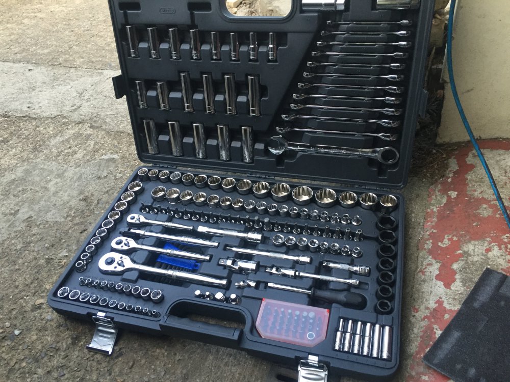

got this tool set for £135 saving 60% with a lifetime warranty
pretty pleased as my tools have seen better days
I believe that for the same reason you shouldn't twist the strands together first, either.
If you have modern automotive crimp housings with silicone rubber seals up the back of the wires, you'll be fine, but you'll never see those on a landrover.
Nope all sealedIn at case, Kim should leave them un soldered. I assumed that as is is a late 90's defender the wiring would be made up of non sealed white plastic crimp housings which are now brittle and yellow...
