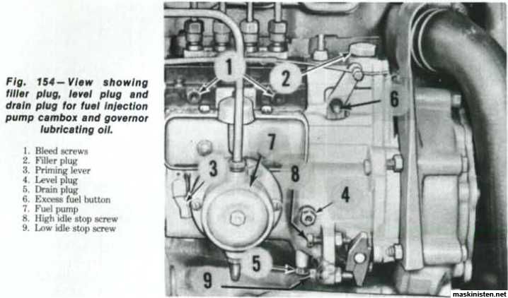

The fuel pump or the lift pump?
the fuel pump is oil lubricated so first job would be drain it (if theres any oil in it) and top it up.i can show you the fill point and fill level.

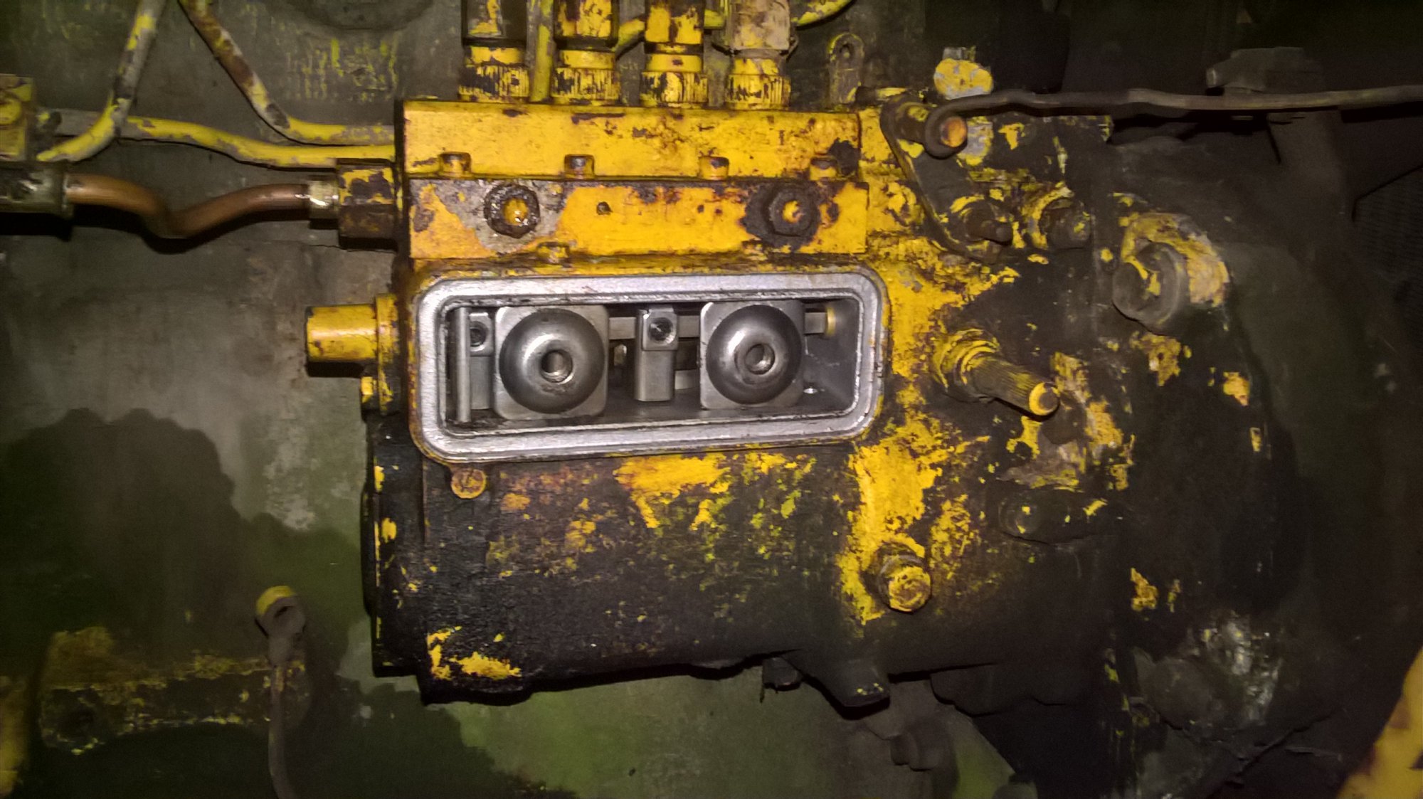

there is a rack that sticks in the pump that can sometimes be easily freed up
Not exactly the same as your pump,but close enough.just ignore the position of the lift pump.
open the drain,its on the underside of yours,you need to be below and looking up to spot it.
then take the 2 bolts off the rectangular cover on the side.the rack and mechanisms for the four injectors are inside.gently pry the rack and lifters to hopefully unstick something.
replace cover,then open the fill level bolt,and fill to level
