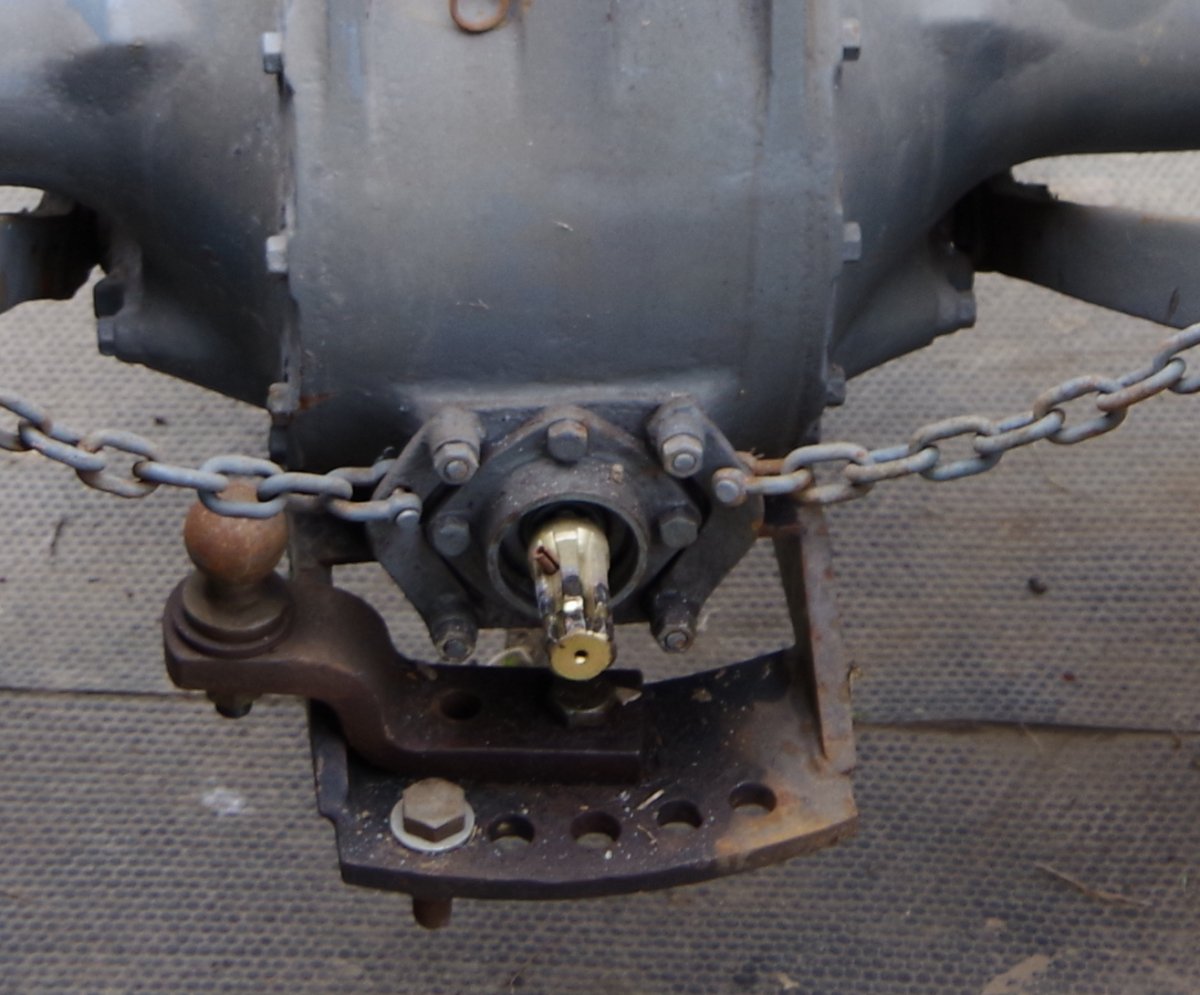

Check the pto size, the origional ones dont fit modern attachments, not sure of dates/ models etc.

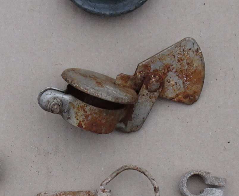

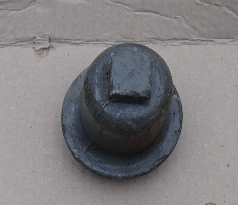

Or a differant Diff.I think it's been replaced with a modern longer PTO shaft as the original cover is to short to screw on, I may be contacting @doubleboost to see if he can make a longer replacement.
I'll leave it as is and just put a cover over the shaft as all the stuff I tow is fitted with a 50mm coupling so I will just swing the towball round and use thatOr a differant Diff.
Thats an adaptor to take it from the original smaller size to the more modern standard, knock the roll pin out and the adaptor should slide off.

No plans to use the PTO as all the attachments I use have a standard 50mm ball coupling.If you're going to be using the PTO, then I'd suggest upgrading it to the modern 6 spline shaft, as the small shafts were prone to snapping.
Agriline sell the kit - https://agrilineproducts.com/ferguson-pto-shaft-5810
They can also supply a larger cover. It's actually a Fordson cover.

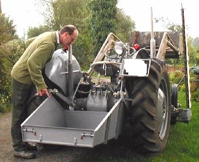

That would be the Continental Z-120 used for the first couple of years until the Standard motor Company engine replaced themI had a very early one with the American petrol engine , great little thing, the wheel Jack that operated via the 3 point linkage was so simple but so effective.
PM incoming...I used to make reproduction link boxes for them
actually I have one partially finished
