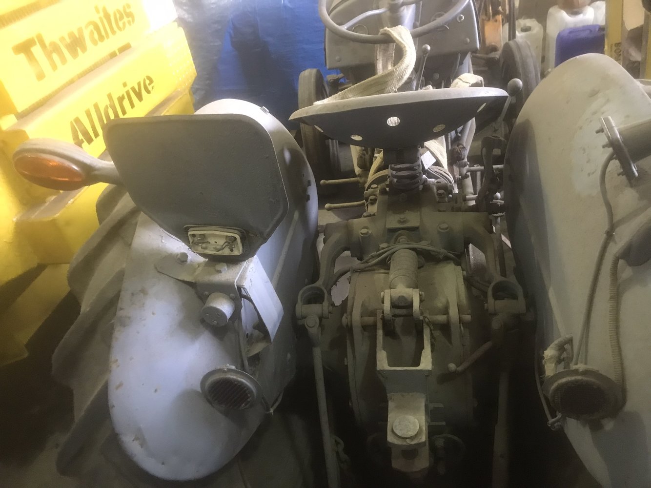

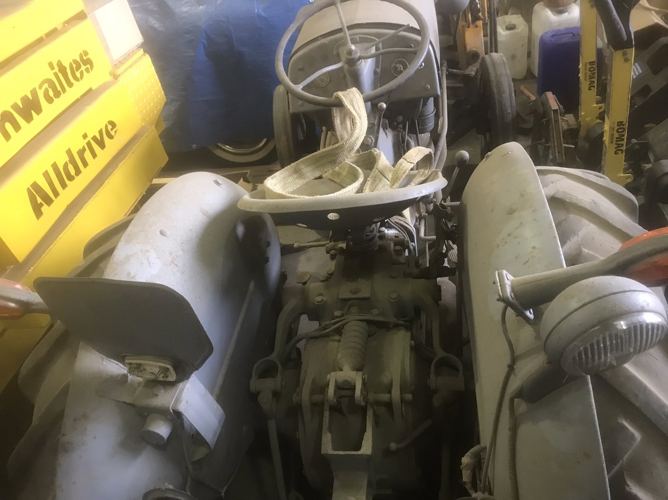

You never knowDoes the extra 'E' denote electric?![]()

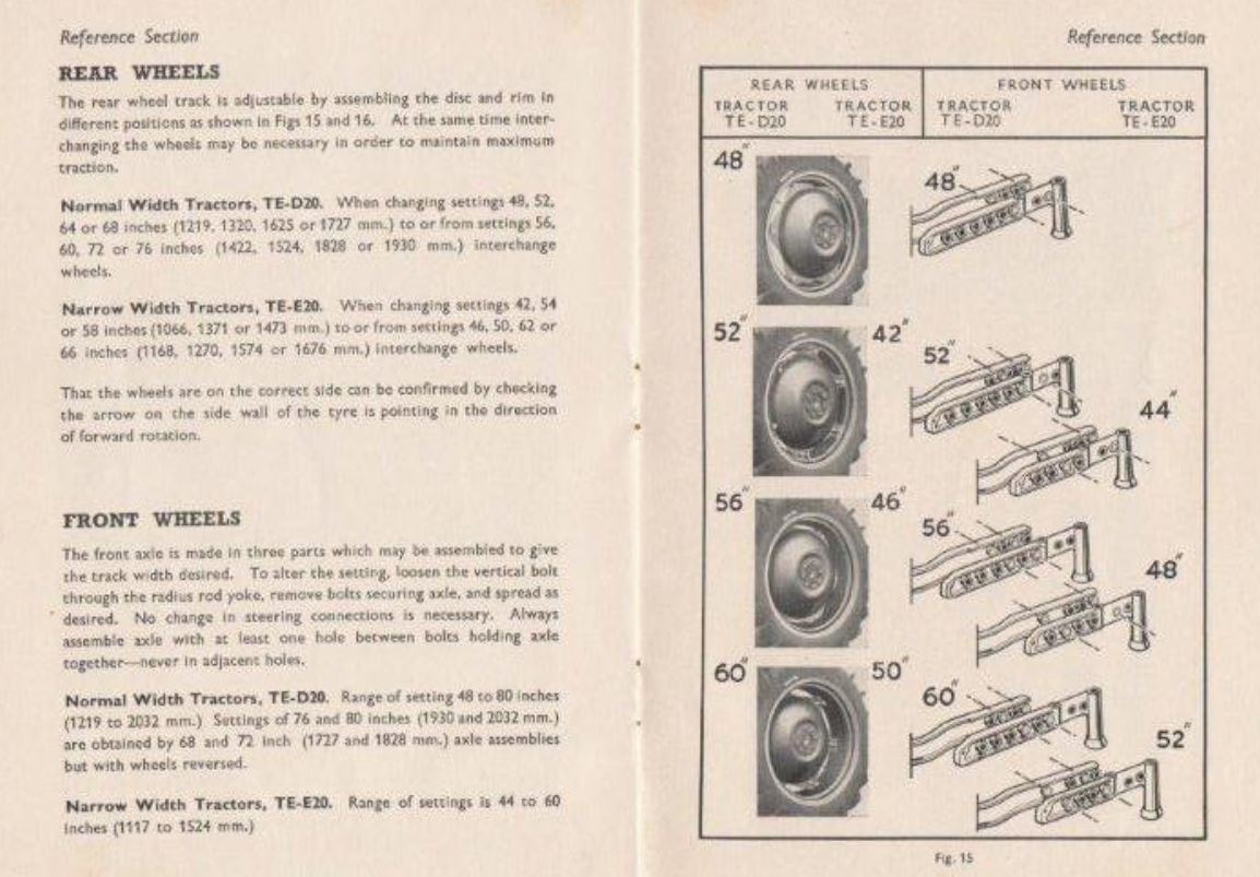

It means it's a TVO narrow wheel (vineyard) version.
I can't remember all the codes of the top of my head, but TEA was normal width petrol. TED was normal width TVO.

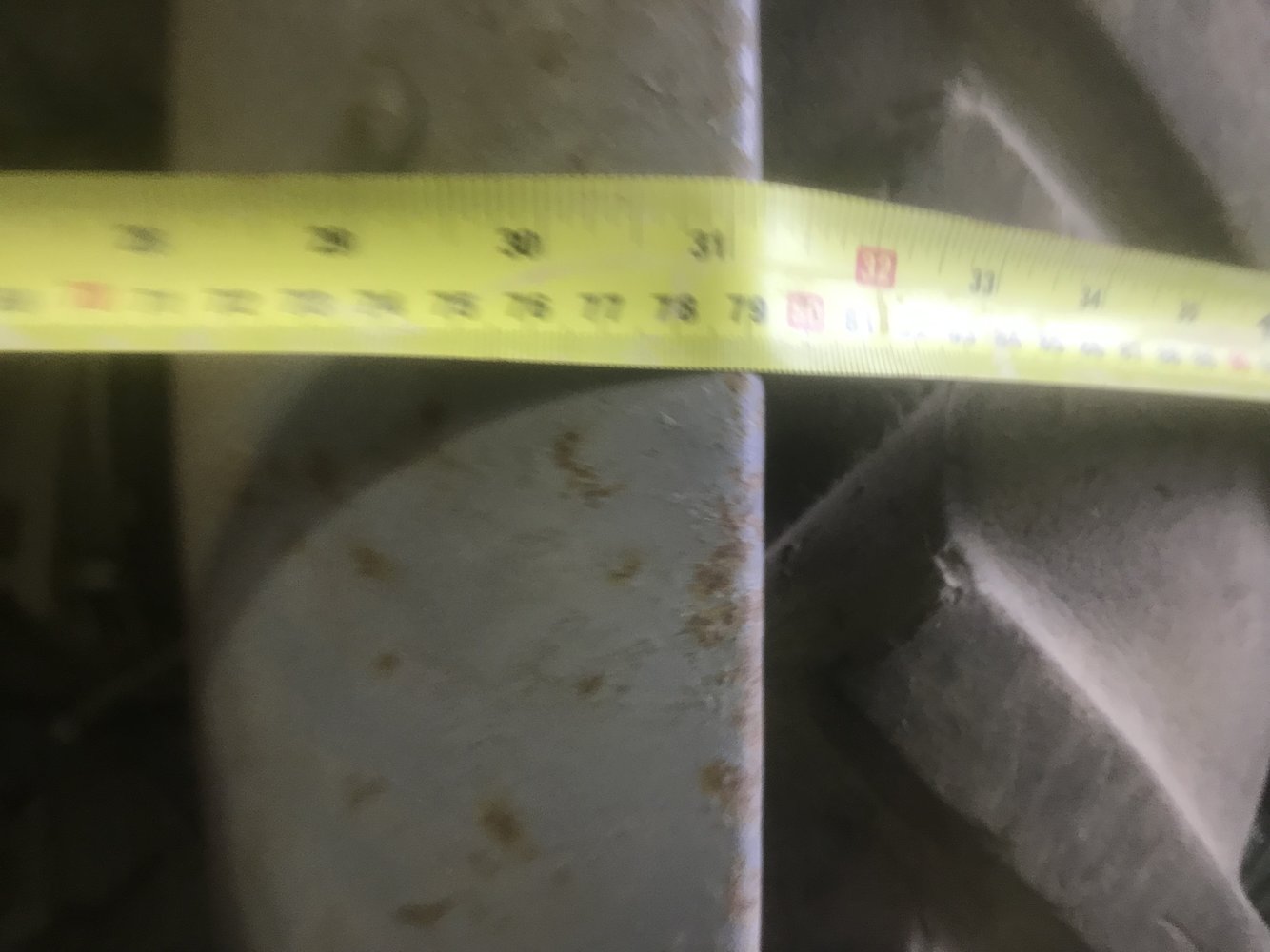

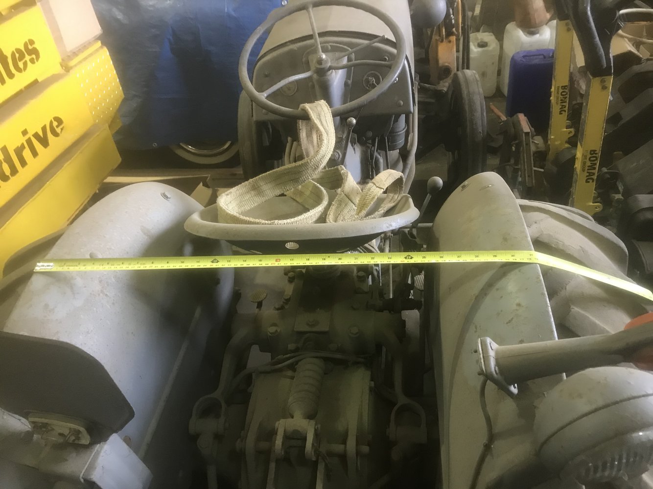

Can't remember when Ferguson started making the narrow width version, as the original narrow width conversions were done by Reekie (predecessor to the current potato equipment manufacturer in the Angus area), where they essentially cut the rear axle trumpets down, and welded them back together, as there was demand for a tractor narrow enough to be used by soft fruit growers in the area. My grandad bought the TEE for working raspberries/currants from a local farmer who had originally bought it for working in the stocks. The tractor hasn't ever stayed anywhere more than 5 miles from the original supplying dealer.
My dad then replaced the Fergie with a MF135 Vineyard, and the Fergie was relegated to the back of the shed for many years.
