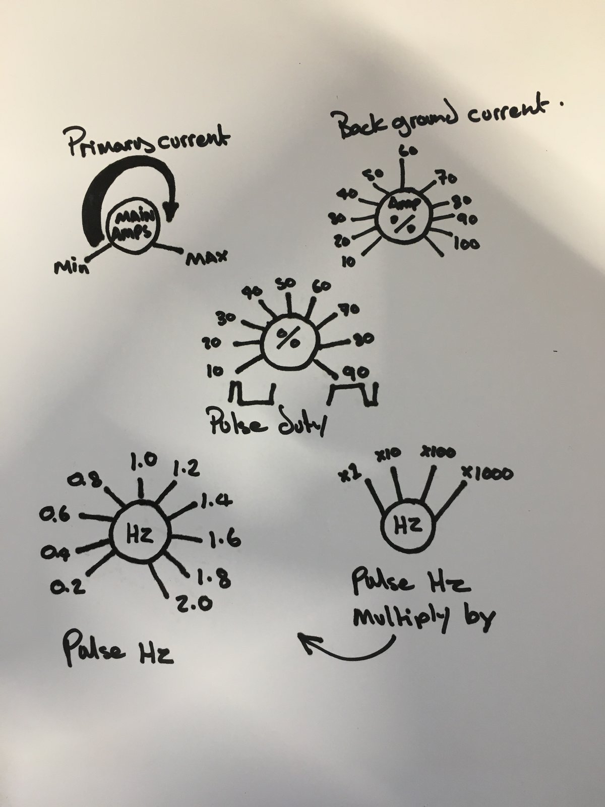

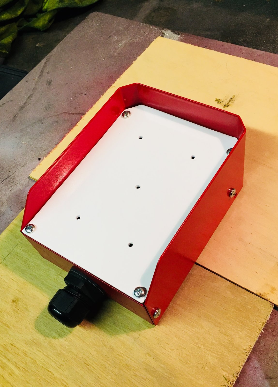

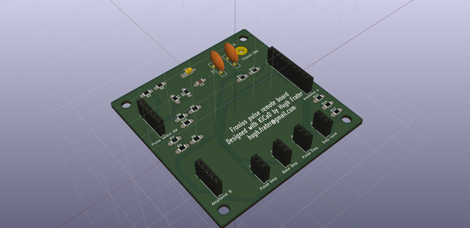

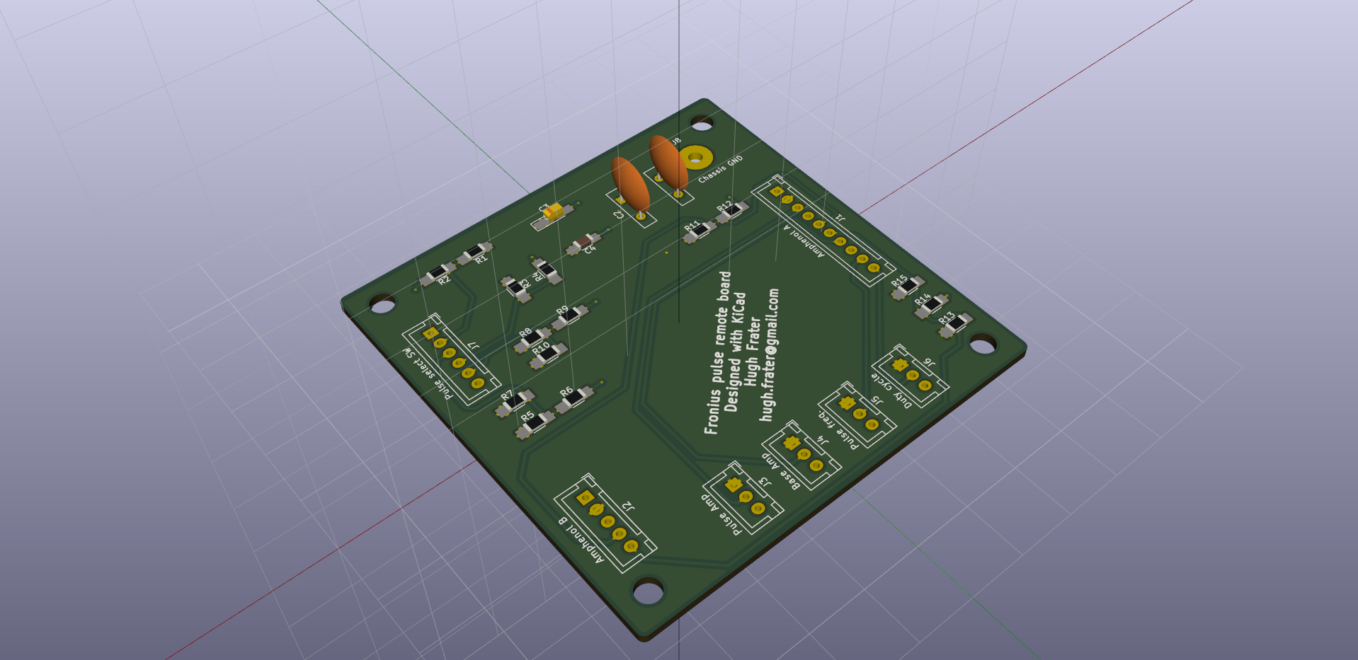

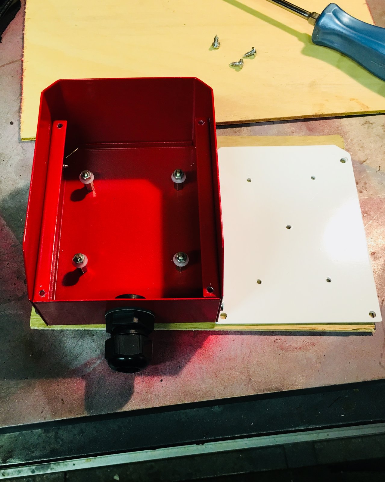

Top man. I’ve got a 10pin amphenol on order it’s the right plug. Board should have about 25-28mm clearance from the top panel when mounted.@Richard. phone has gone screwy... the board will be 75mm x 75mm with 4mm mounting holes at 65 centres
Taking on too many texts from meI received those fine mate but now my messages app on my phone crashes when I try and load it... my phone needs a factory reset I think.

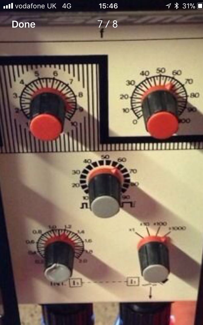

Do you know what size the pot holes should be.
Nice. Are there any particularly high sticking out components on it or is it relatively flat.Not decided on yet mate, depends on what pots I end up choosing... Nearly finished the board layout tonight though.
Indeed I am.... just a small run to start with, minimum order quantity from someone on aliexpress probably. The small volume UK board shops are just too expensiveAre you getting them printed Hugh?
