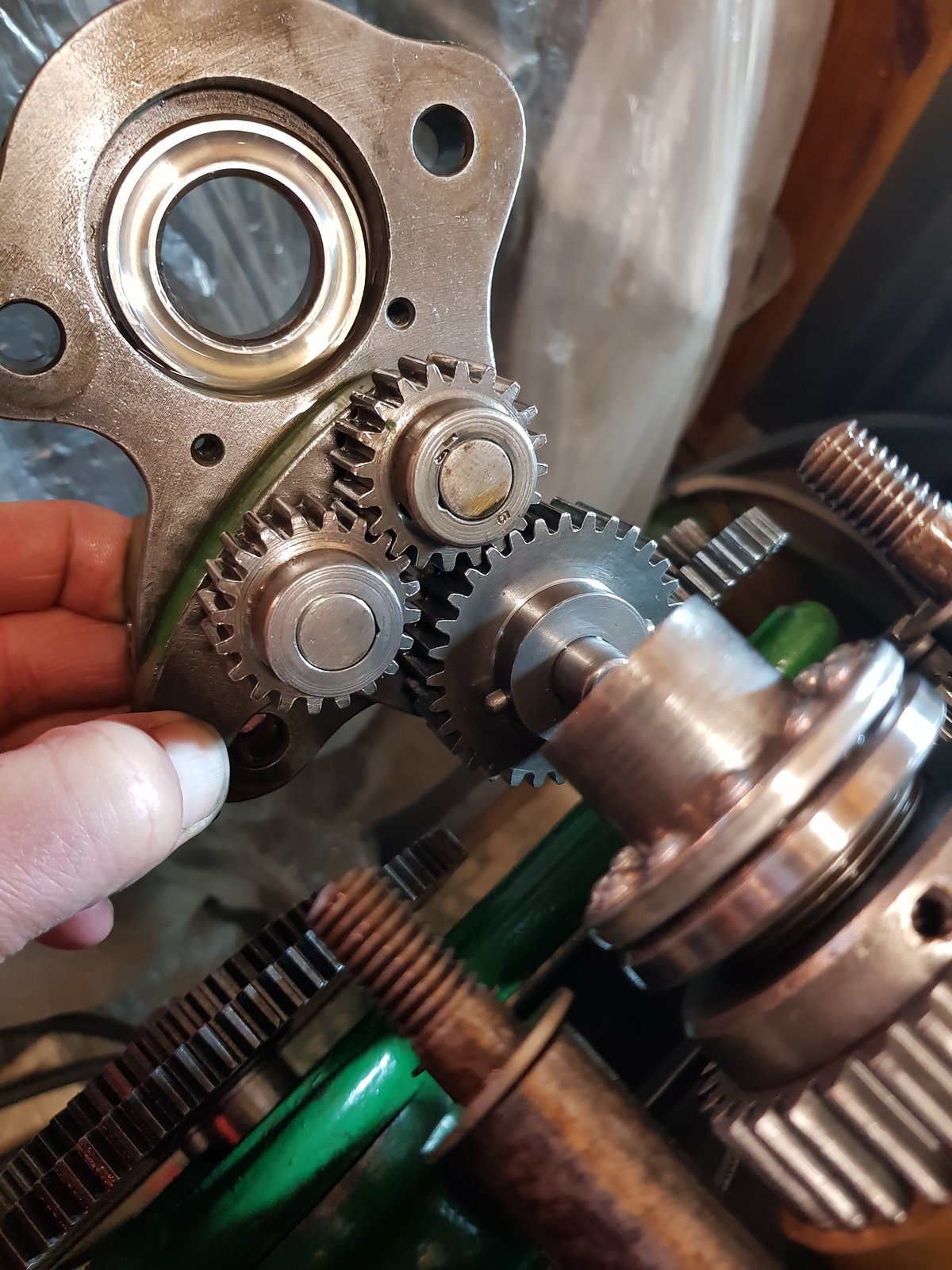

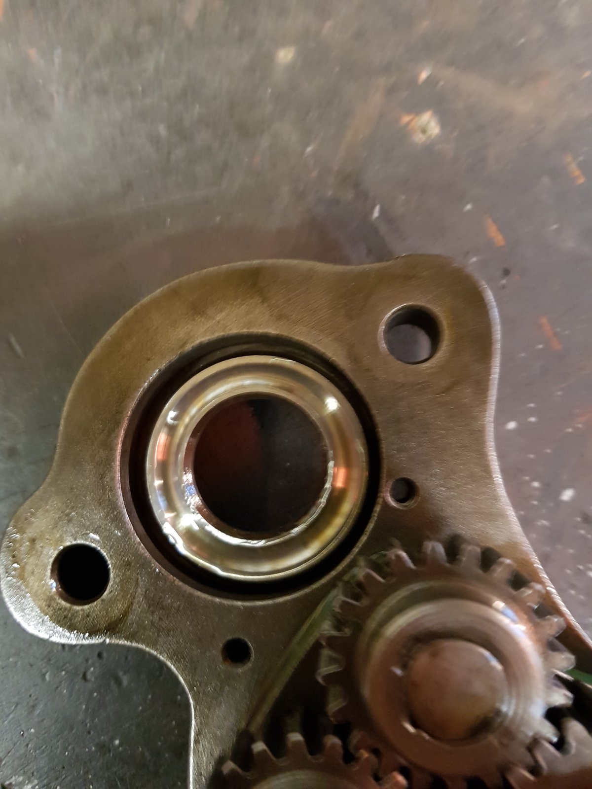

I found the 20. 25.
Two 20s and a 32 in the tumblr.
One 20 on the spindle.
A 63 rear screw gear and a couple more I need to take cover off to count. Gears everywhere
Well, going by your screwcutting chart you have an effective 4tpi leadscrew (because 4TPI has the same input and output gears sizes), which is 6.35mm lead. To get your metric pitch you look at the letters of the gears in the inch chart and use the formula:
6.35 x A ÷ B x C ÷ D = metric pitch in mm
