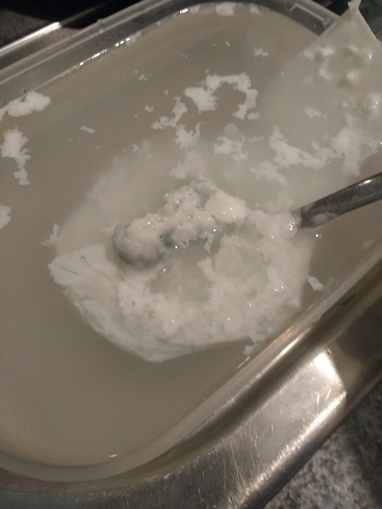

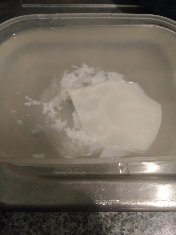

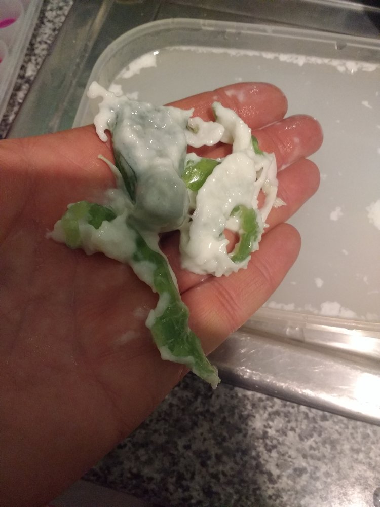

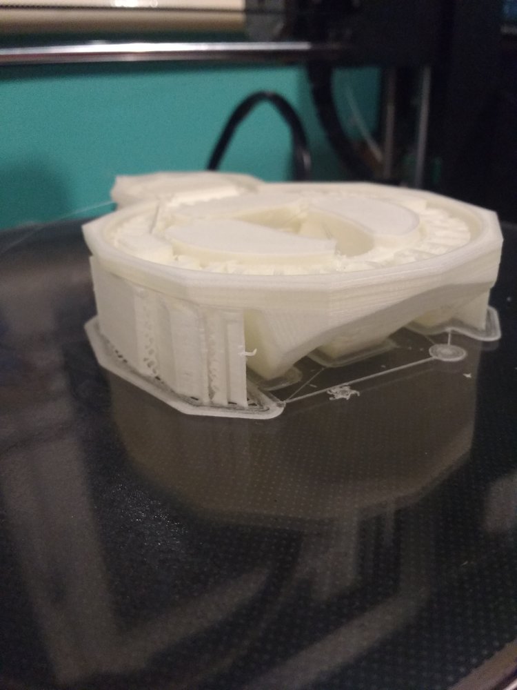

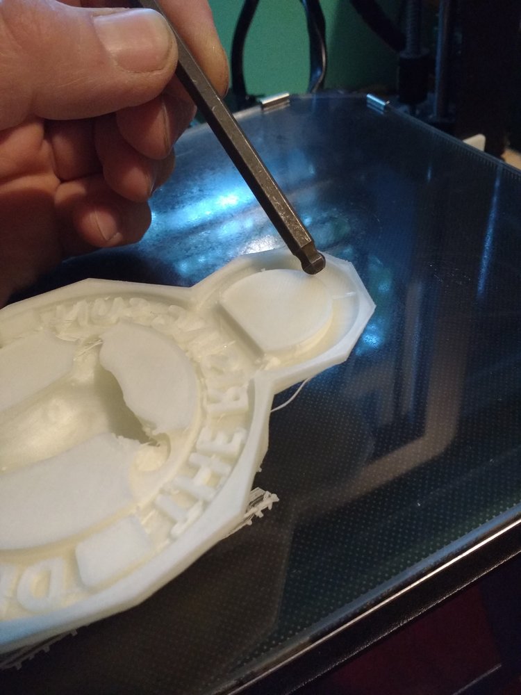

I'd still try making a silicone moldTo get rid of the PVA quicker I figure a cheap aquarium heater to keep the water warm. Then I need something to make "bubbles". An aquarium air stone maybe?
Ideas on a post card please!![]()
De-molding is easy and you can make lots of wax patterns for when more people want them.

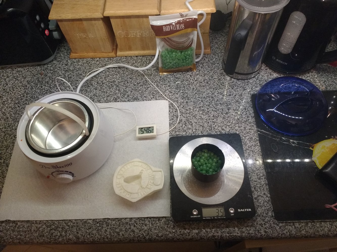

Have you tried melting the wax beads that came with the warmer? Any good for making moulds?
You need a degassing chamber to get rid of the air bubbles in the siliconYes. Exactly.
Something like this, there may be cheaper available..
Quality 500ml Liquid Silicone Moulding Rubber Mold Making Casting Mould Kit 500g | eBay
Find many great new & used options and get the best deals for Quality 500ml Liquid Silicone Moulding Rubber Mold Making Casting Mould Kit 500g at the best online prices at eBay! Free delivery for many products.www.ebay.co.uk
Or possibly high temperature stuff you could cast pewter into directly?
High Temperature Resisant Silicone Mould Making Rubber 250g Kit *Pewter Casting* | eBay
High Temperature Resistant Silicone Moulding Rubber 250g kit. It can also be used for casting resins, waxes, plaster etc. It may cause skin irritation making this product unsuitable for applying directly to human skin for life casting.www.ebay.co.uk
Vibrate for a few minutes to get rid of bubbles.
Use vaseline thinned with IPA as a mold release....
No you don't. It's nice to have but vibration or rapping will get bubbles out. And careful pouring into one corner of the mold also helps.You need a degassing chamber to get rid of the air bubbles in the silicon
You’ve obviously been lucky then.No you don't. It's nice to have but vibration or rapping will get bubbles out. And careful pouring into one corner of the mold also helps.
Very interesting thread

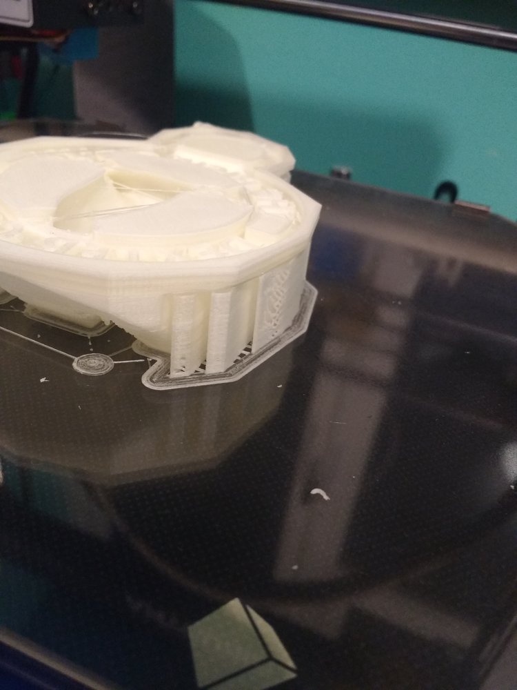

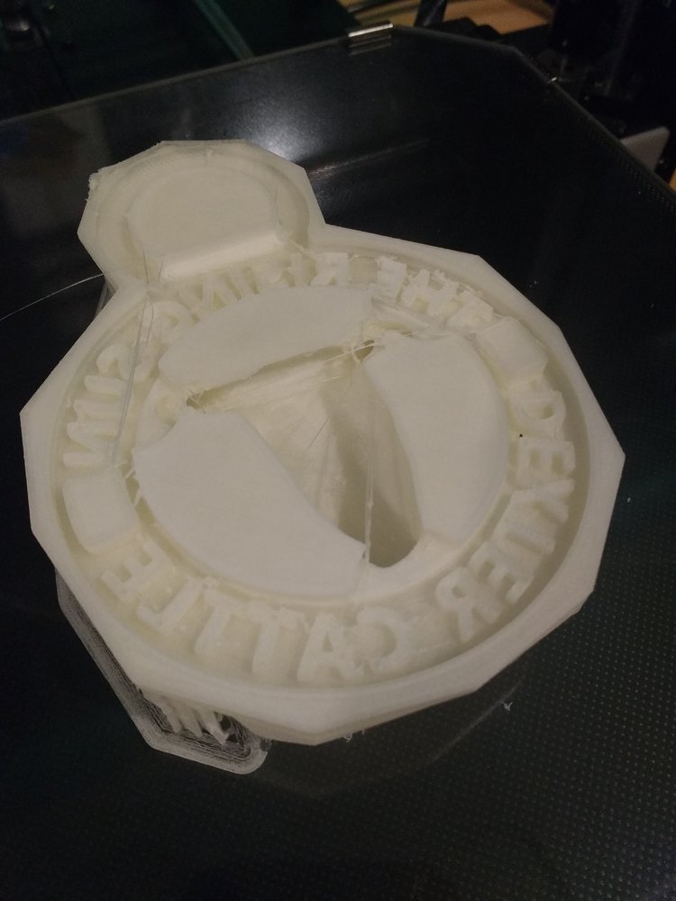

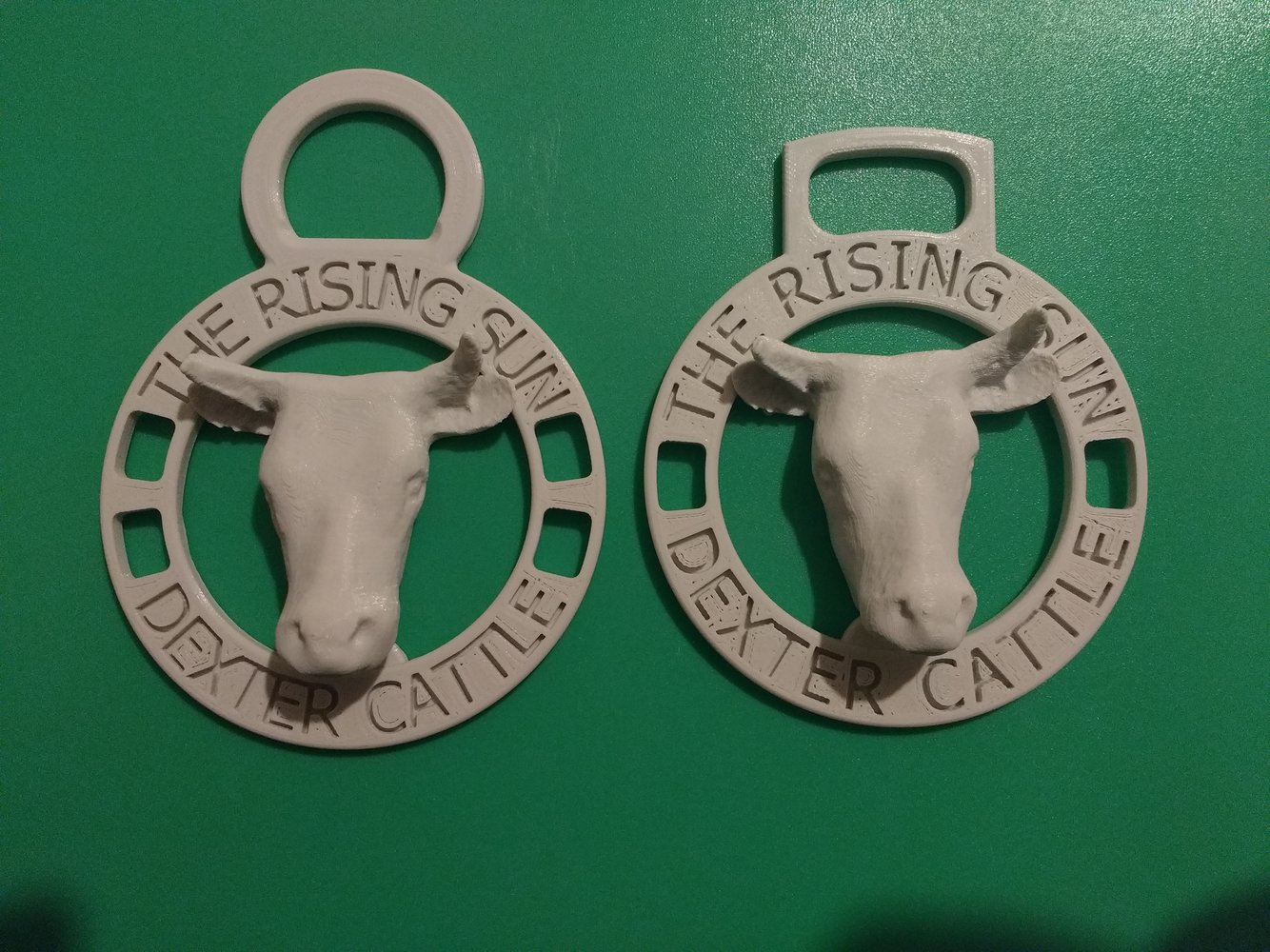

This was an eye-opener to me......the casting technique not the puzzle.Very possibly will and indeed the PLA forms are done but I just wanted to try wax.
Have you actually done lost PLA?
