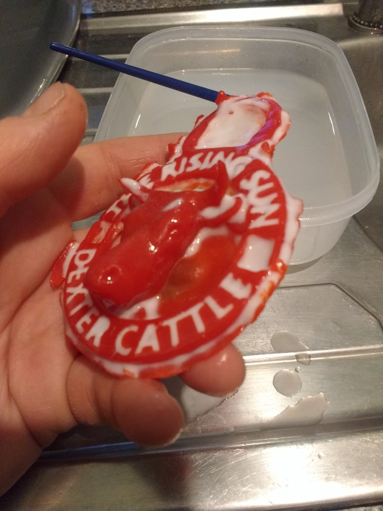

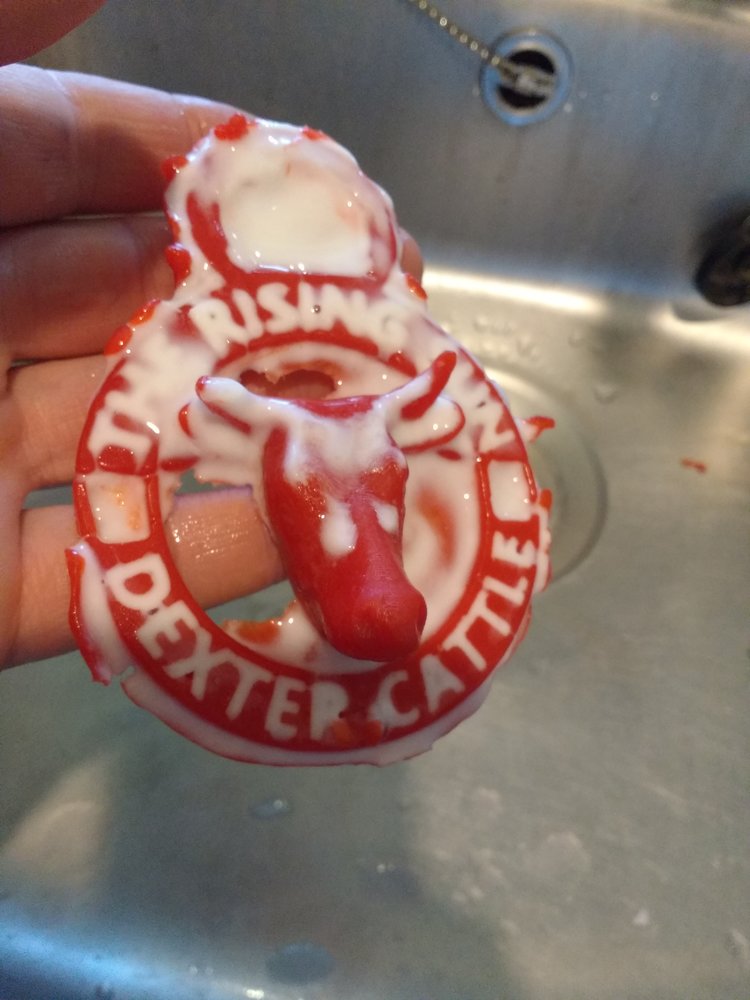

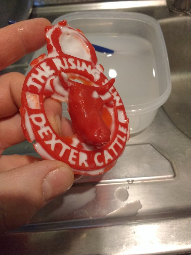

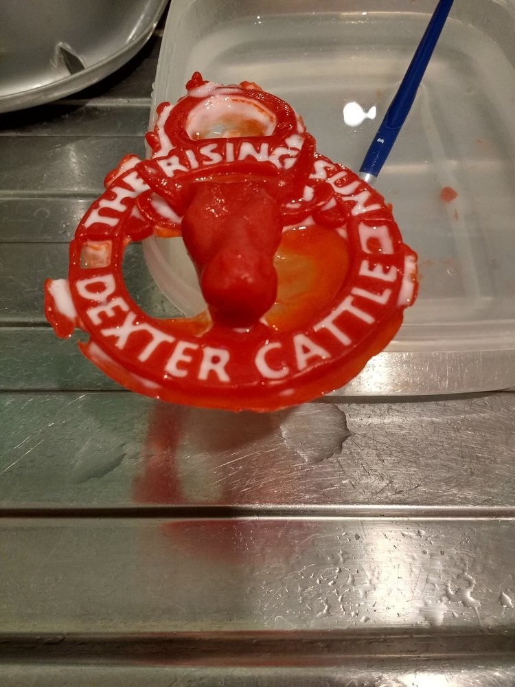

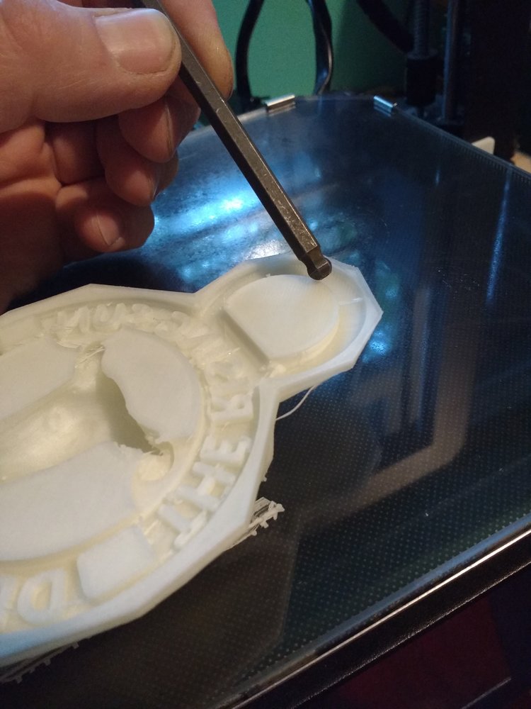

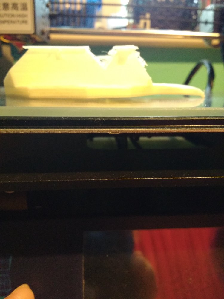

Would that work or are the horns an issue? Moulded on edge might resolve it?
Good Luck and speedy recovery.The horns and ears in the case of the cow we're trying to do, are in effect overhangs. You don't really see that sort of feature on traditional horse brasses which is why it appealed to me to try and do it.

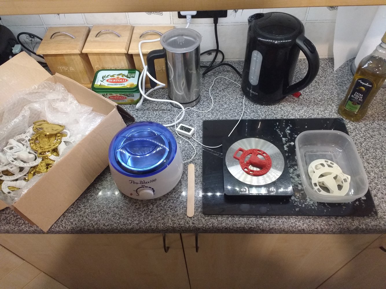

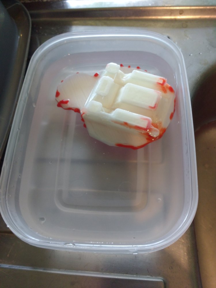

Happy to be told wrong but I figured investment (plaster) casting was thus the way to go. Silicone moulds would likely work but not for the temperatures involved with brass.
With the overhangs we're into almost jewellery making as I see it and then lost wax / lost PLA, lost wax being the traditional jewellery method.
I might try another wax pour into the PVA mould later. The latest PVA mould isn't perfect as aforementioned. It does seem to have some warping issues as a process but I reckon my lad can figure that with more work on the supports.

Is the the stl freely available? If it's a private thing I understand, But if not I'll give it a go, probably in lead 1st. The horns and ears would be gulleys cast face downwards?The horns and ears in the case of the cow we're trying to do, are in effect overhangs. You don't really see that sort of feature on traditional horse brasses which is why it appealed to me to try and do it.

I thought the first wax cow was quite good..
It wasn't as a finished product just to see the issues with casting. I'll knock something up to tryPrivate? Well it's unique and a fair bit of work's gone into it along with countless pints!
