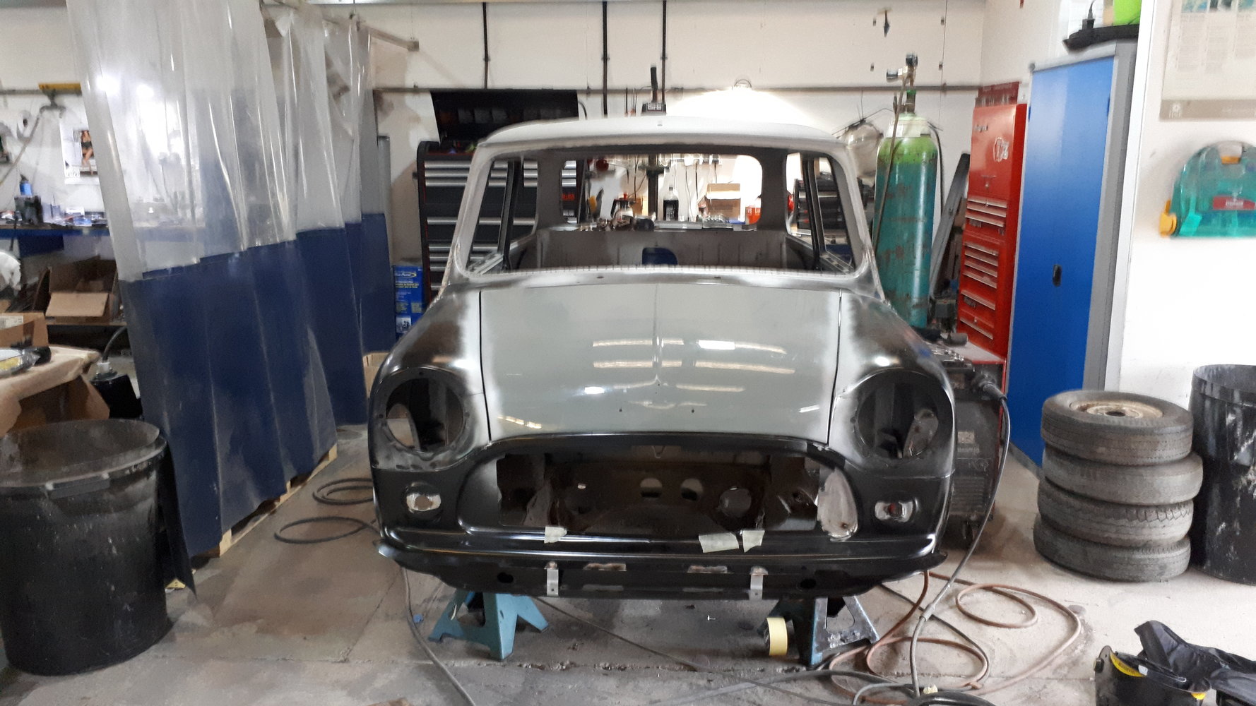

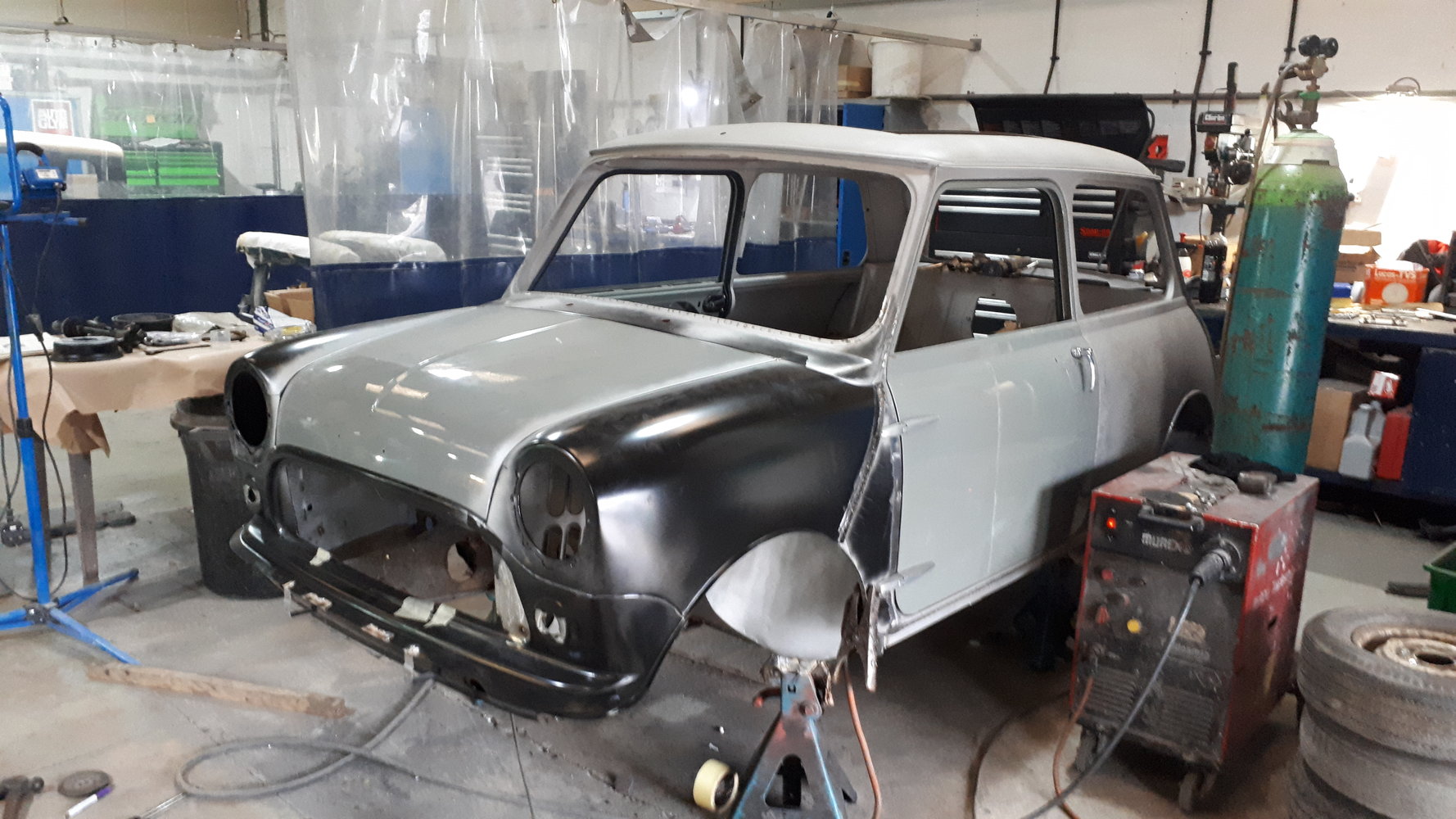

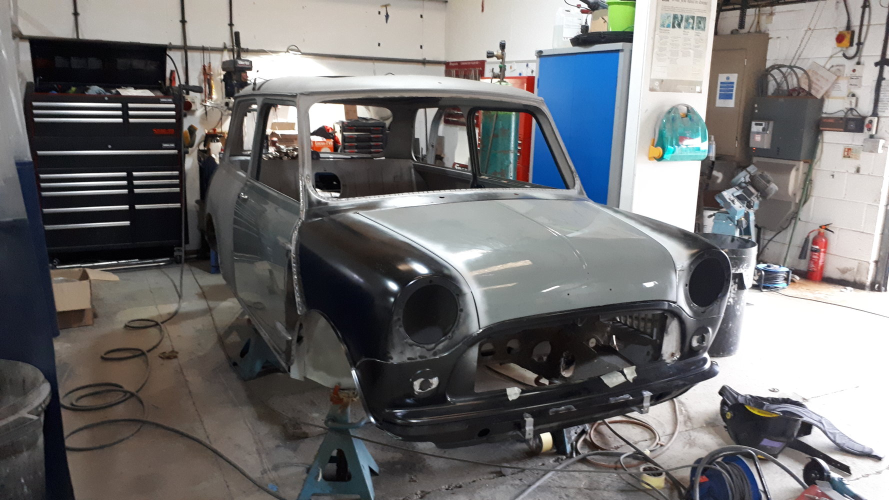

Yes, only about 45% of this car has been replaced. This is what I would class as a light restoration of a 54 year old car.It's looking good! but is there any of the original body left?

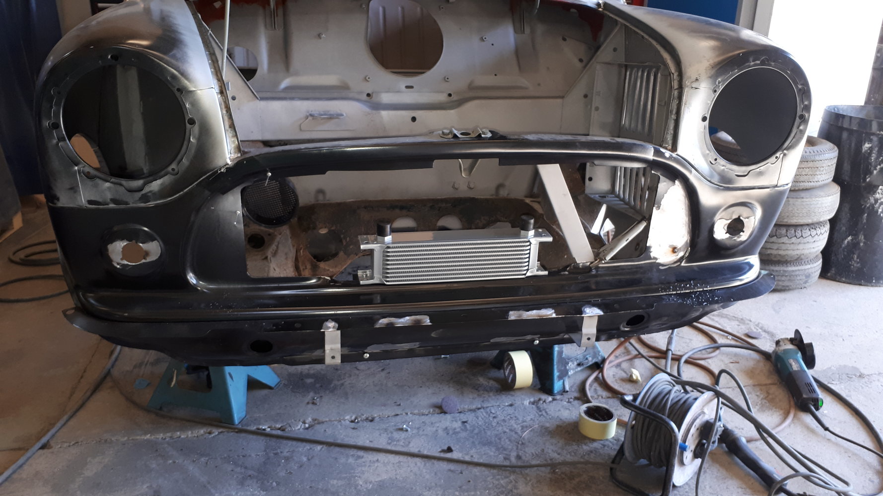

So where are the shims located? Behind the panel but in front of the subby?You have to have the front sub frame fitted and with 1 or 2 shims on the front bolts to fit the front end panels. Without it you stand no chance of making things line up.

(no migs about then)Yes, that's correctSo where are the shims located? Behind the panel but in front of the subby?
