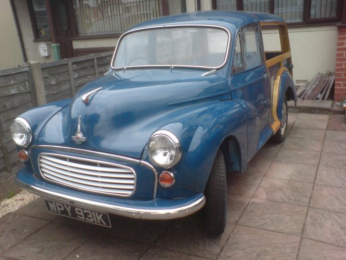

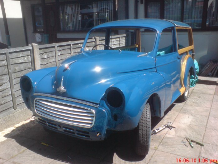

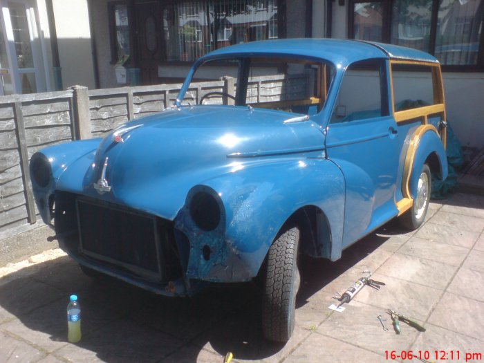

That wood looks the bees knees. The one my friend has is like a powder blue, I like the colour of yours. It's coming together nicely keep up the good work.

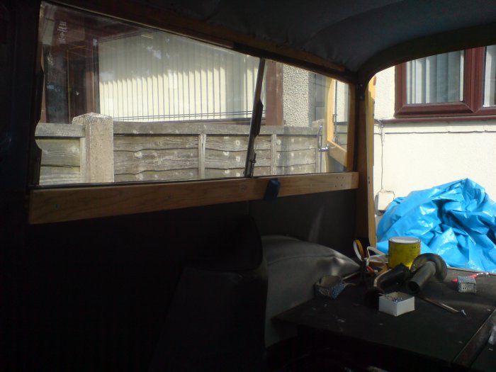

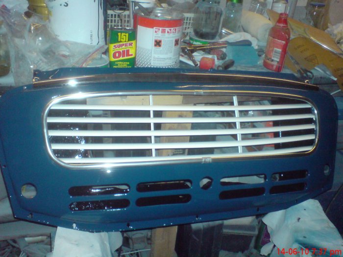

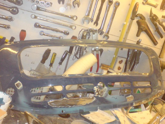

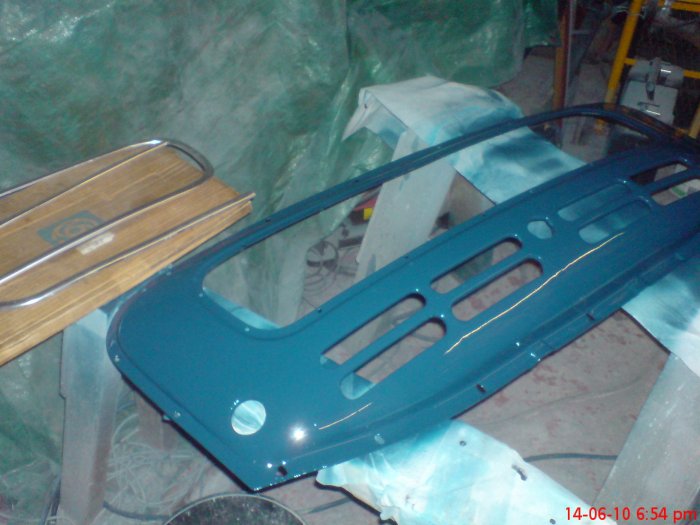

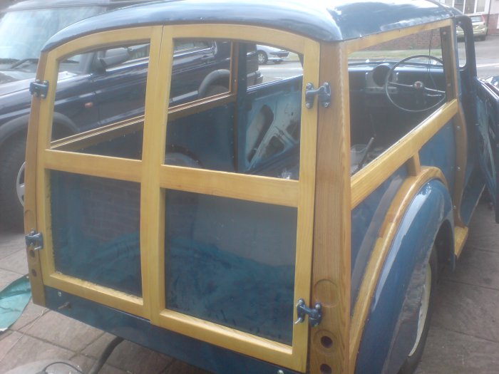

Been doing some more work, so here are some more pictures.

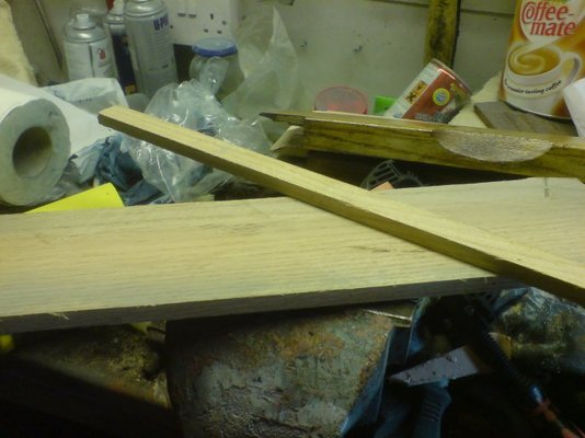

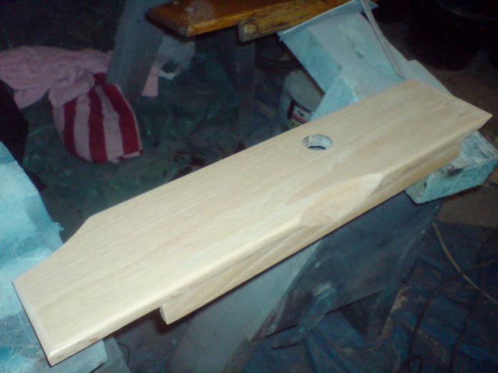

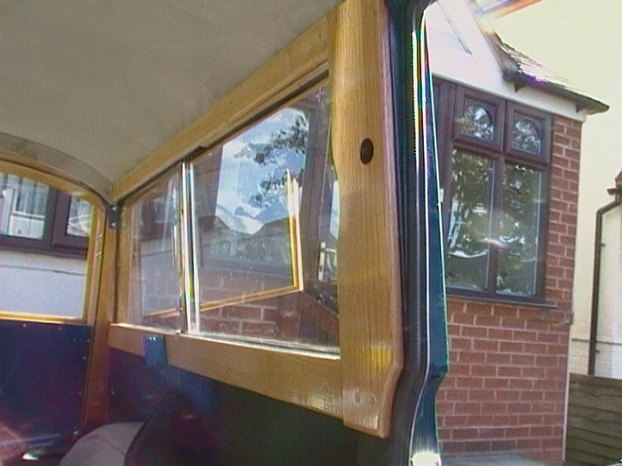

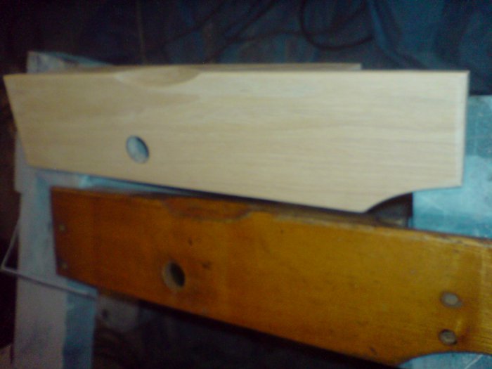

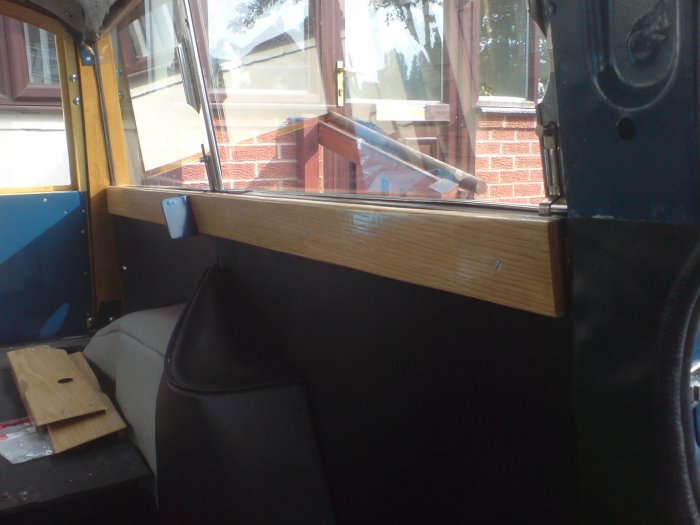

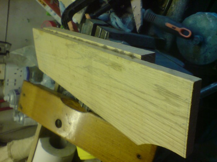

There are also photos of one of the new interior wooden trims that i have been making, along side the old part. New part is made from oak.
Hope you like them

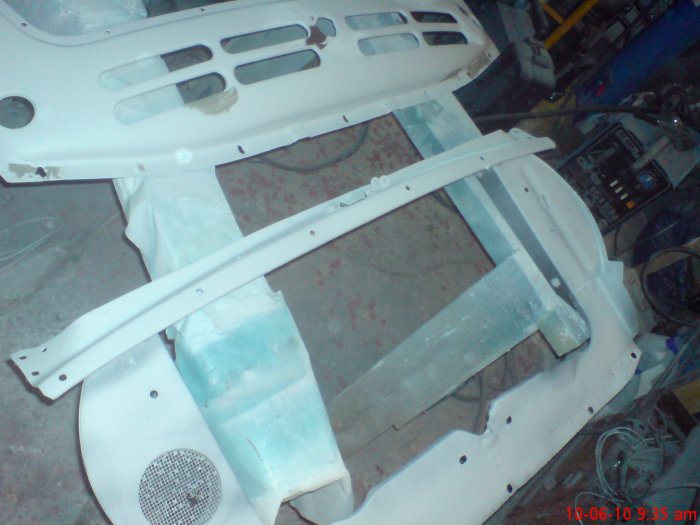

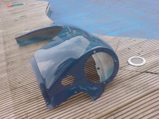

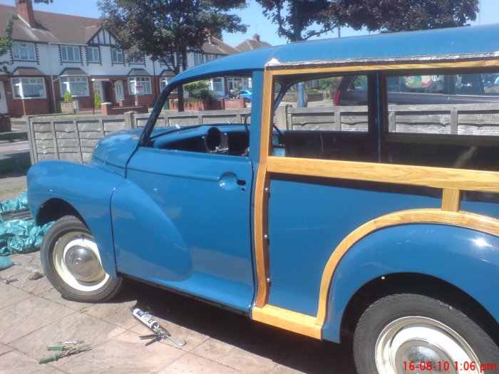

I did the cab under a gazebo type thingy but anything that could be removed was done in the shed, and yes i do have a proper mask before anyone asks.

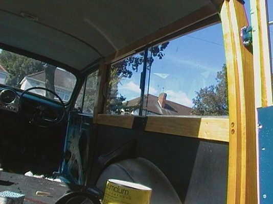

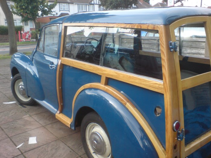

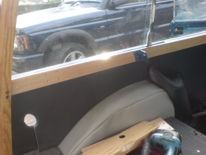

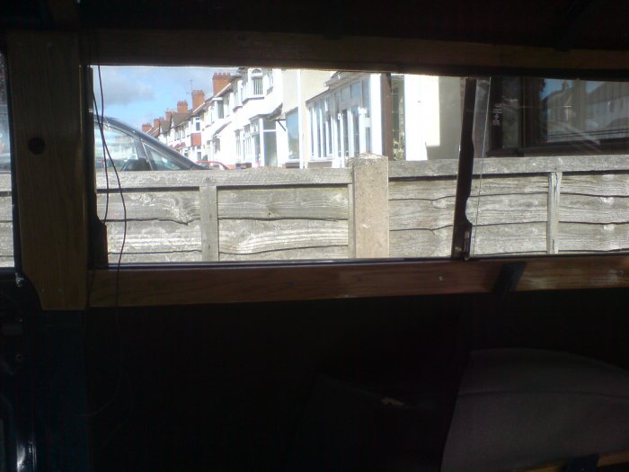

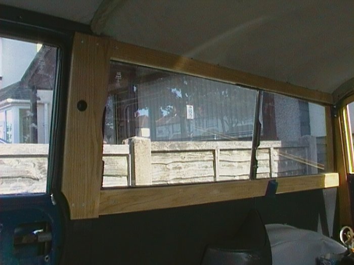

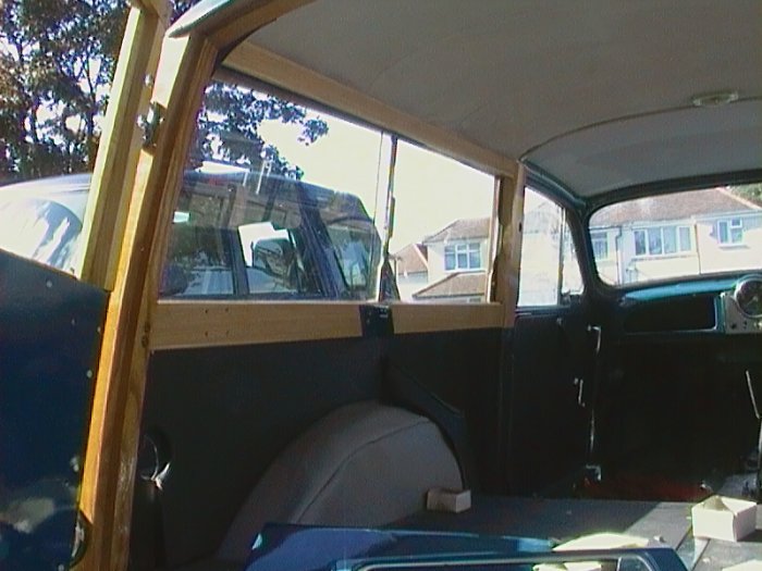

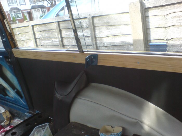

Had chance to do a bit more today, but my camera was playing up so these are the best pictures i could do. The camera didnt want to work inside. Anyway the side windows are in, and the carpet on the wheel arches, also the trim panels in the back along with some of the wood cappings,front door seals and now the rear headlining is almost in. Not a bad days work i`me really pleased with how things went today.

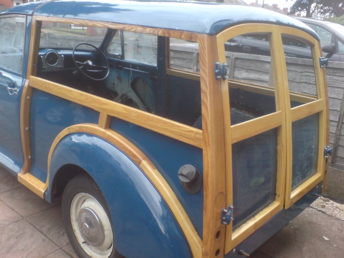

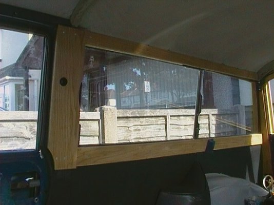

Finished fitting the interior wood today, this is what it looks like. I`me thinking of doing the headlining capping and where it is secured over the back doors in the same wood as they are marked.
Superb restoration you are doing & what a lucky young lady your daughter is to be getting such a well sorted classic,please create a thread on the mini resto you do for your son.

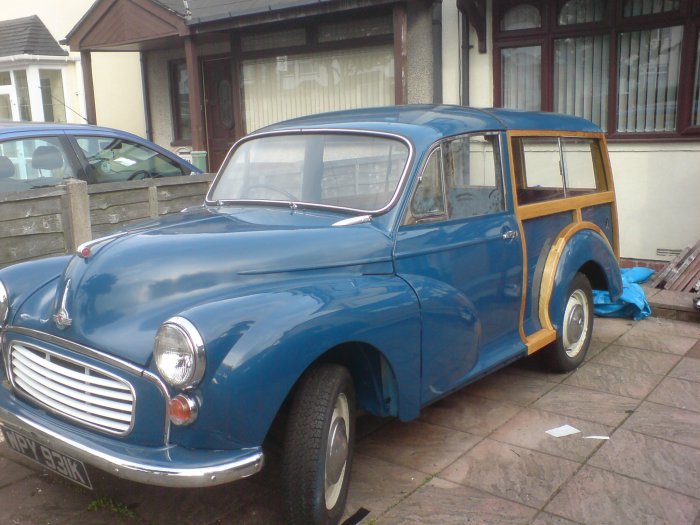

As i am working outside its wrapped up now untill spring. But it should only take a couple of weeks to finishoff then and i can get it on the road.

I am looking for a classic at the moment as my first attempt at restoration,i was a bit dubious about it as i too have no garage but you have spurred me on Mark,you have proved that a front drive resto can be done with superb results
That's a lovely job squizzel. Couple of q's- did you do any steam bending on that lovely woodwork, and will the oak be ok with the steel bodywork? I think the original timber was ash, and oak is a bit tanic acidy. Mind you, it'll last forever!
You are correct the original wood is Ash. The wood frame i got in a job lot of spares for £600, this was a good deal as it is £1000 normally and this frame was new. It had been purchased for a rebuild but the guy doing the work cut out too mutch metal without bracing and the body twisted. So i got a bargain as i got a rebuilt engine and a lot of new panels too.
The oak for the inside i did make myself, but this screws to the inside of the wood frame with the exception of the pieces on the pillars, but i dont think there will be a problem, its easy enough to remove annually to check, none of the other wood comes into contact with the metal work.
