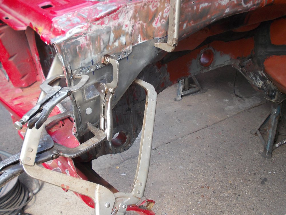

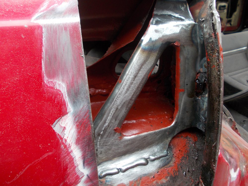

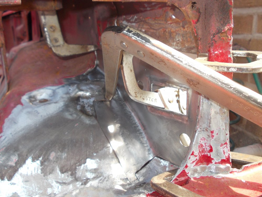

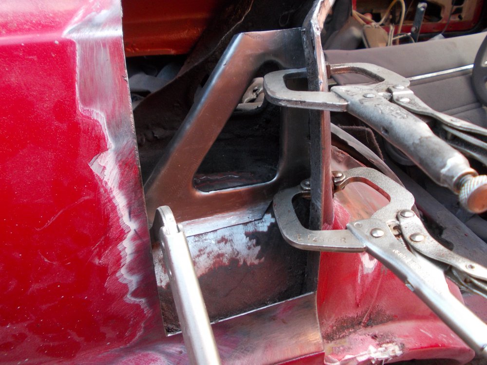

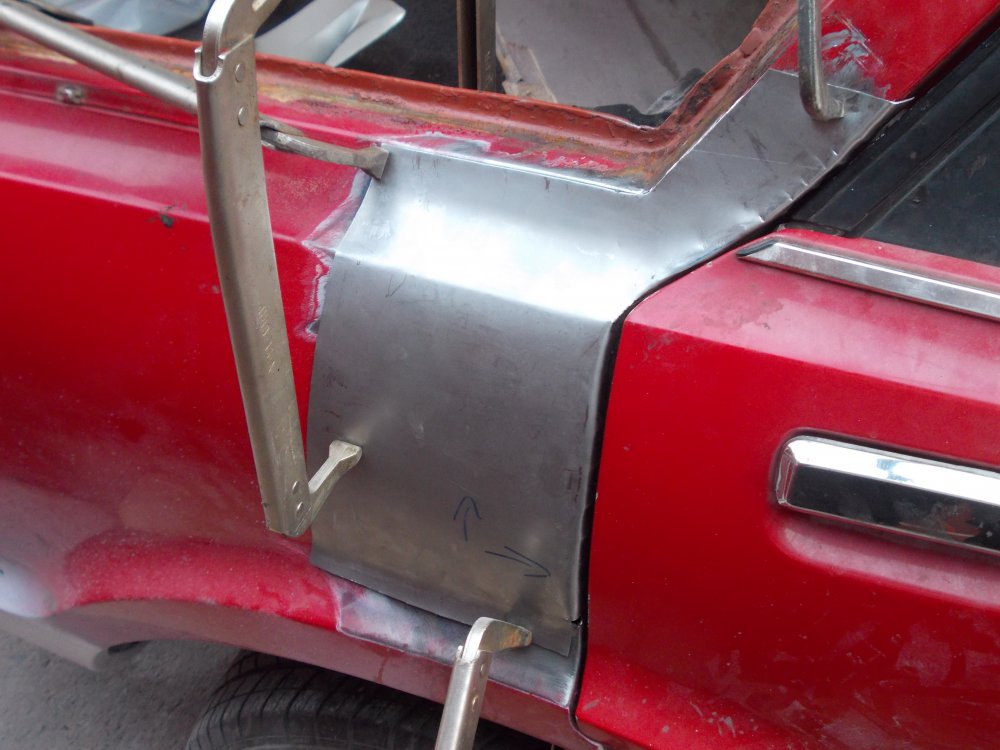

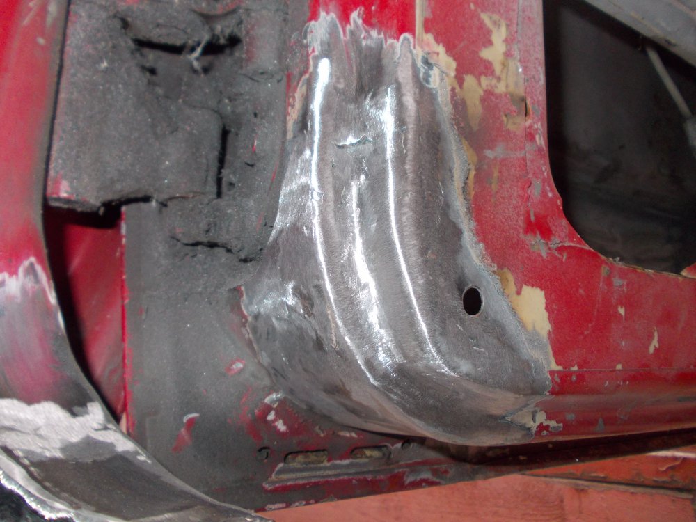

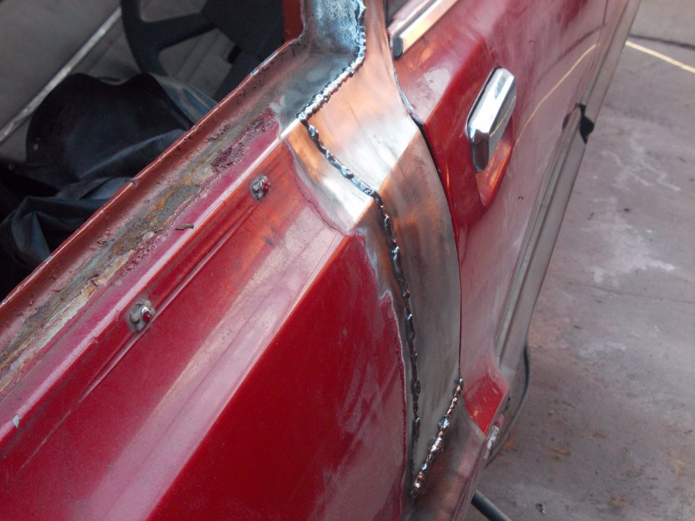

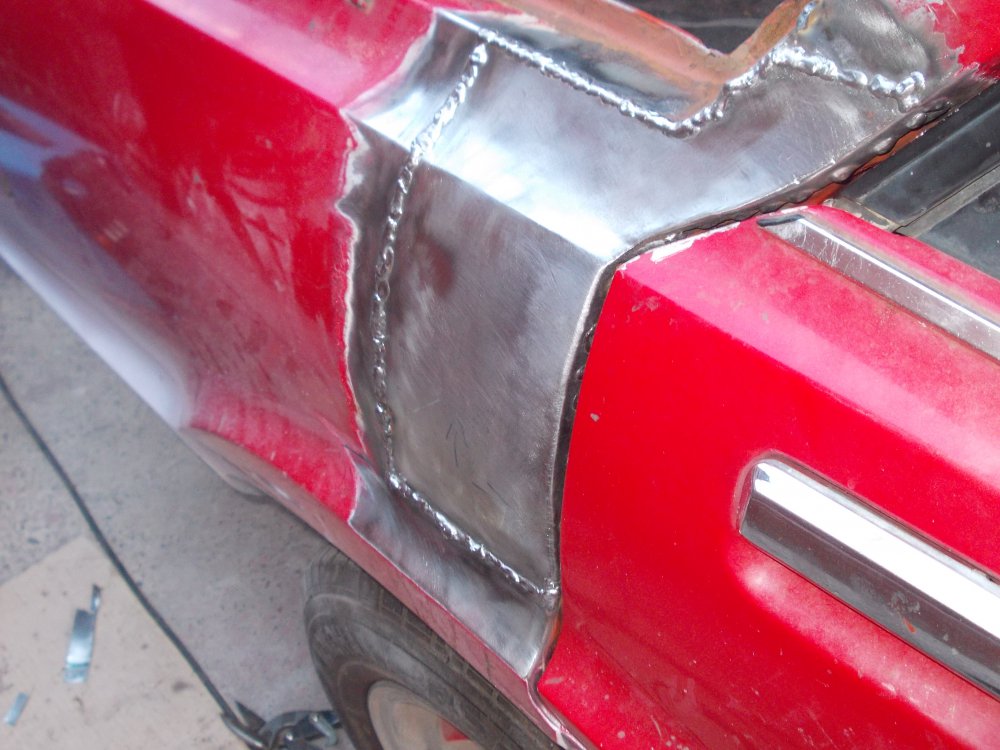

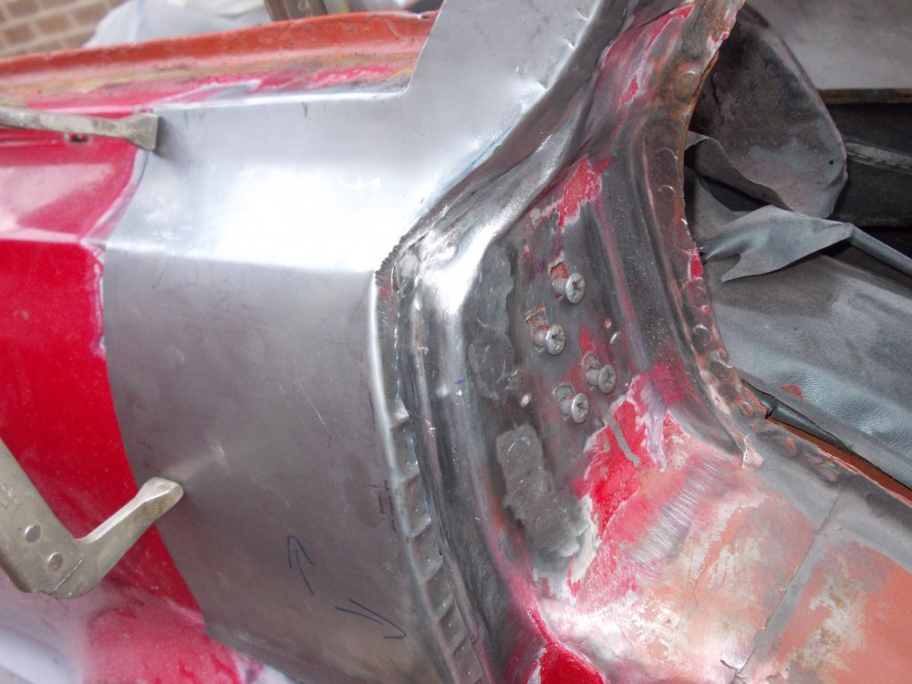

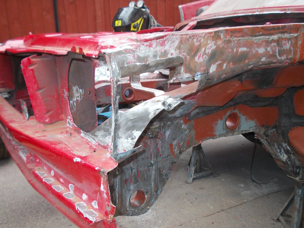

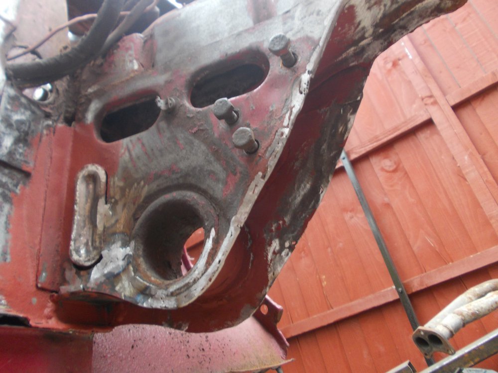

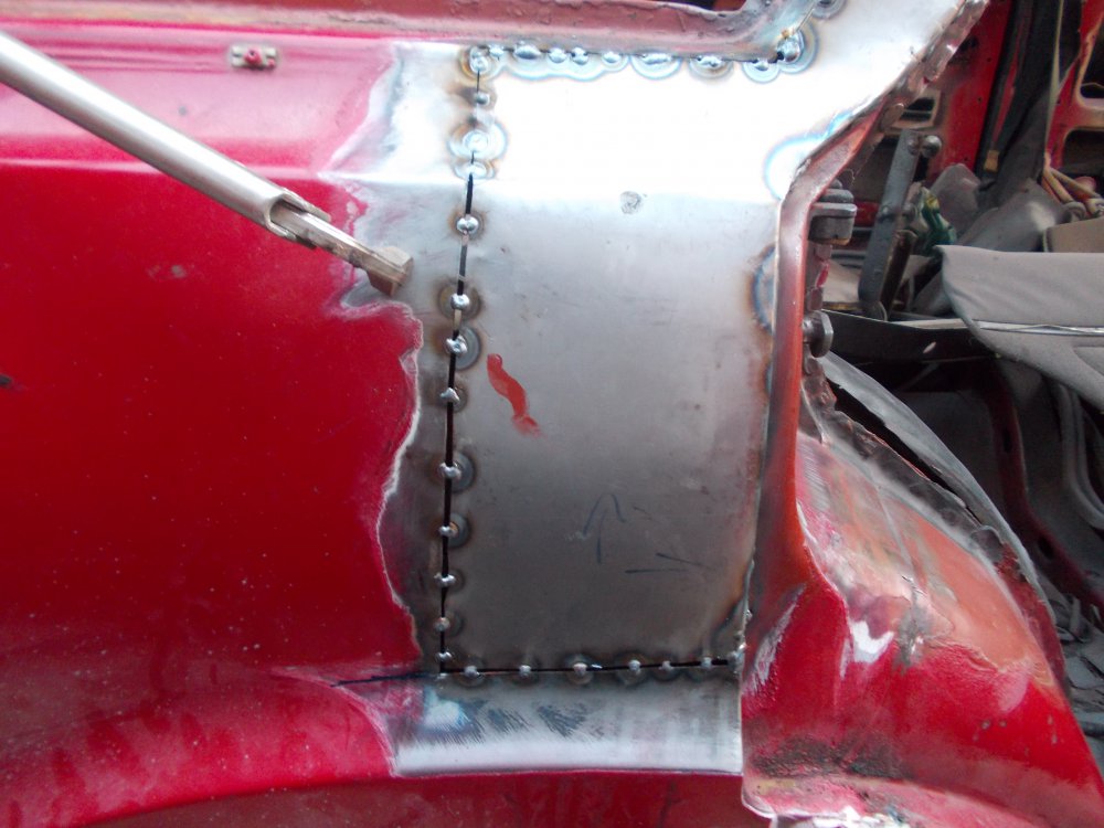

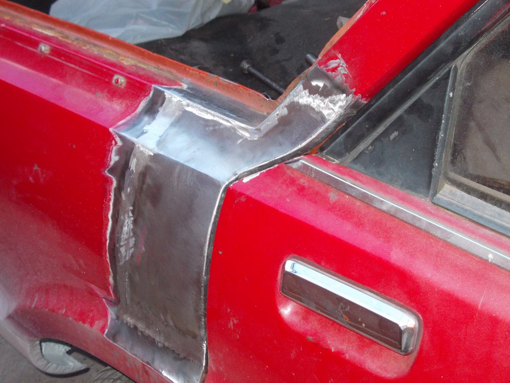

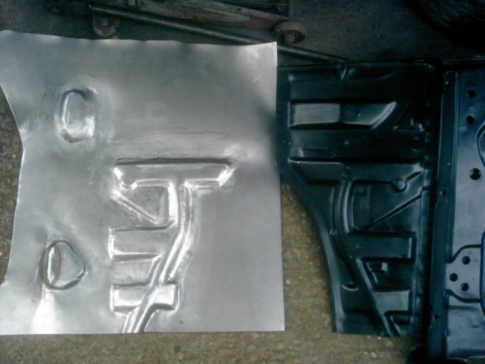

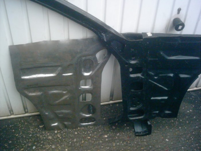

i also made the inner sill. i'd also managed to get hold of a n/s door post panel so decided to make a copy for the offside, it's a bit rough but will be painted in stonechip so should be okView attachment 26470

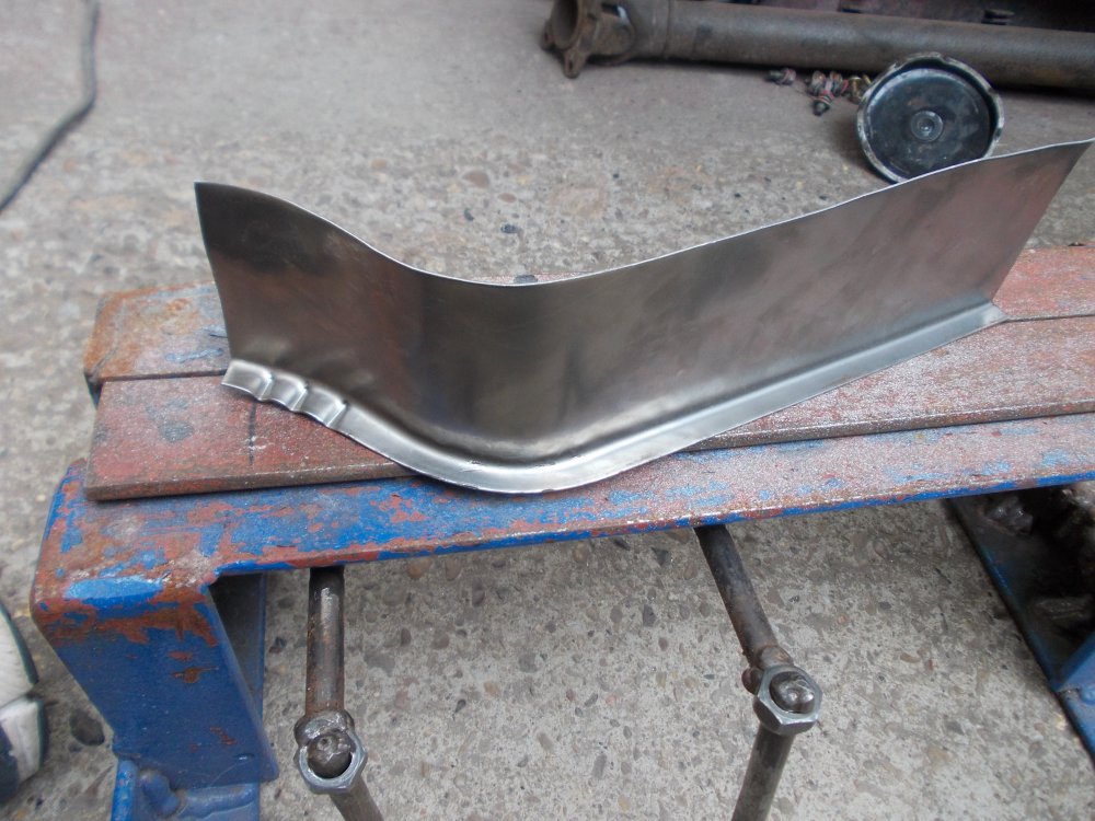

View attachment 26473more to follow

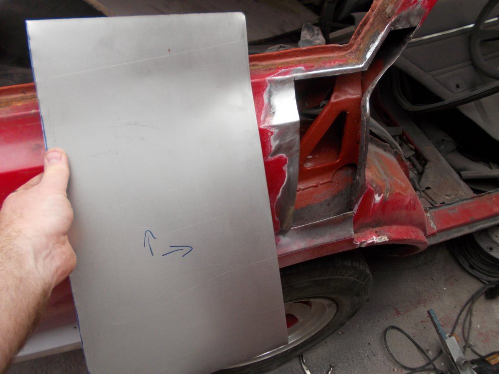

hi, 1mm for outer panels and 1.2 for inner strengthening braces or whatever was there originallyReally fantastic work
What thickness sheet steel to you generally use for panels.
