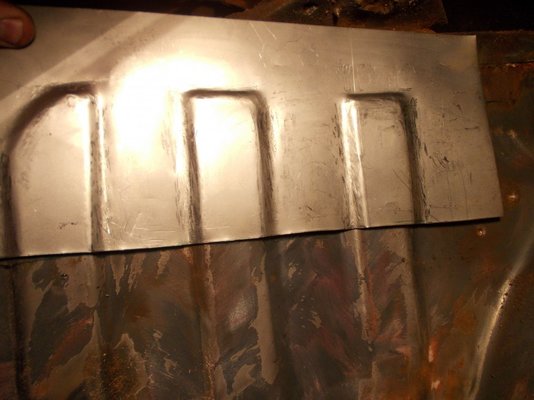

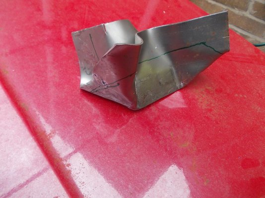

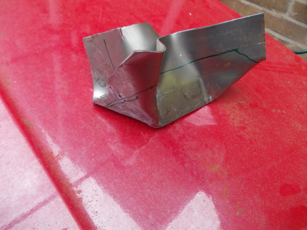

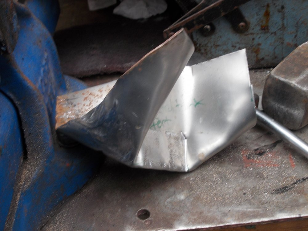

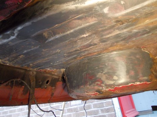

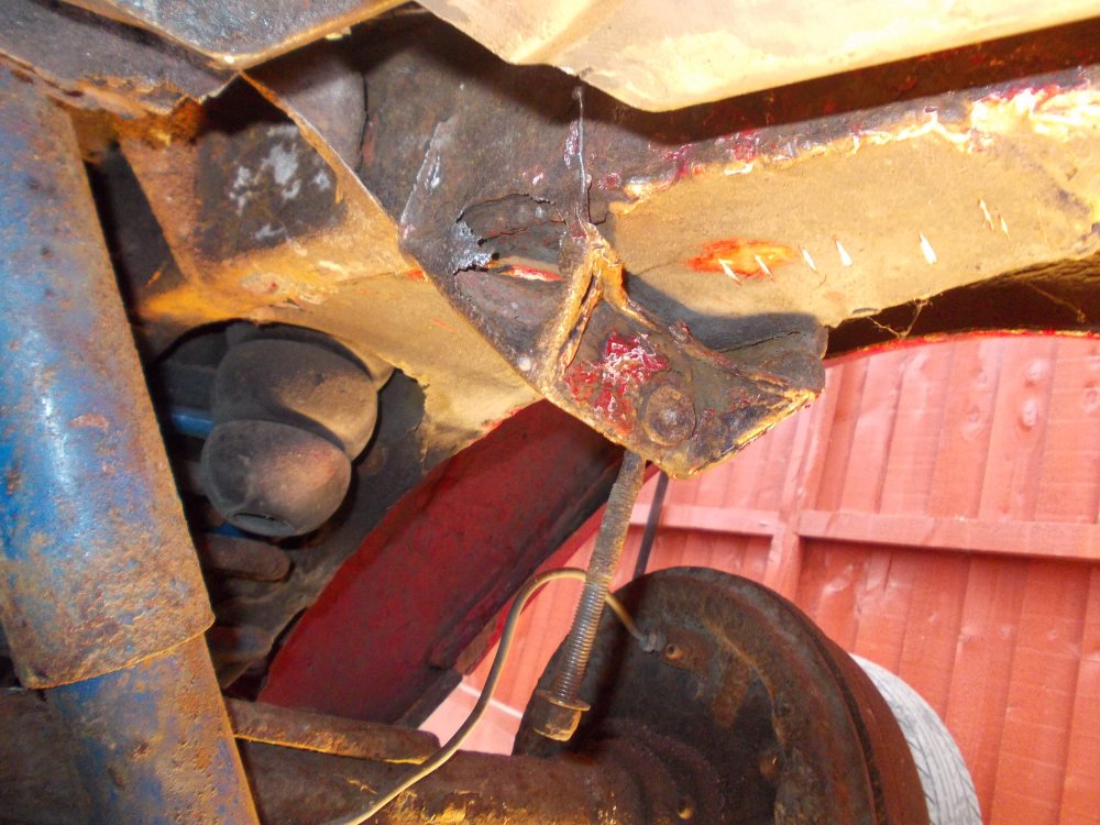

before anybody says it i'm going to try and reprofile the swages on the left to make them the same length as the others
which is a little crusty

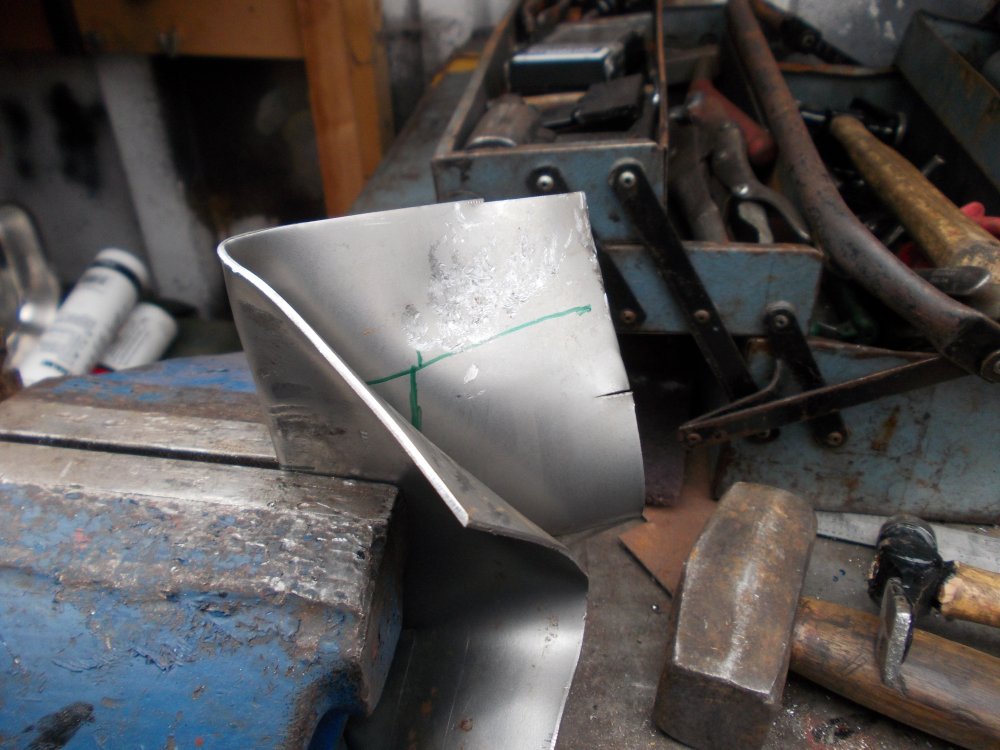

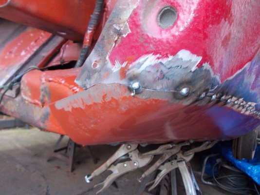

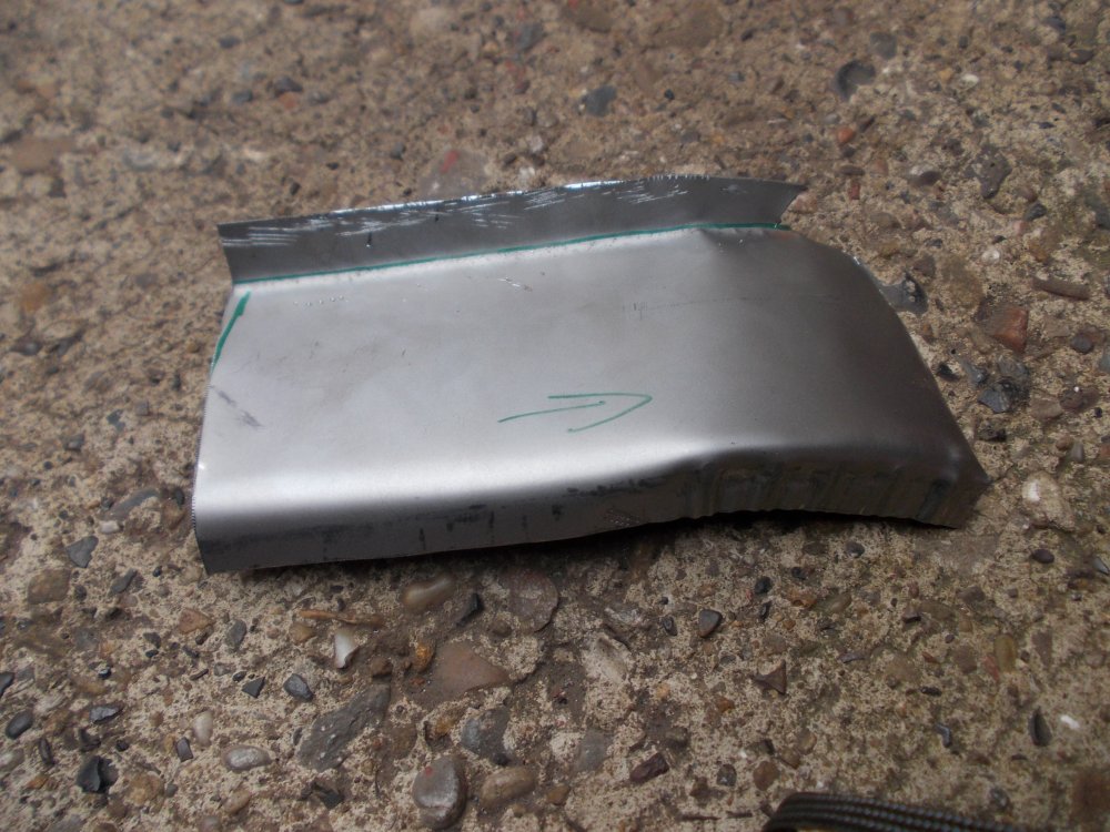

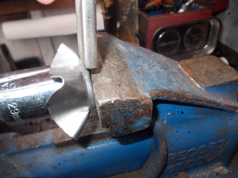

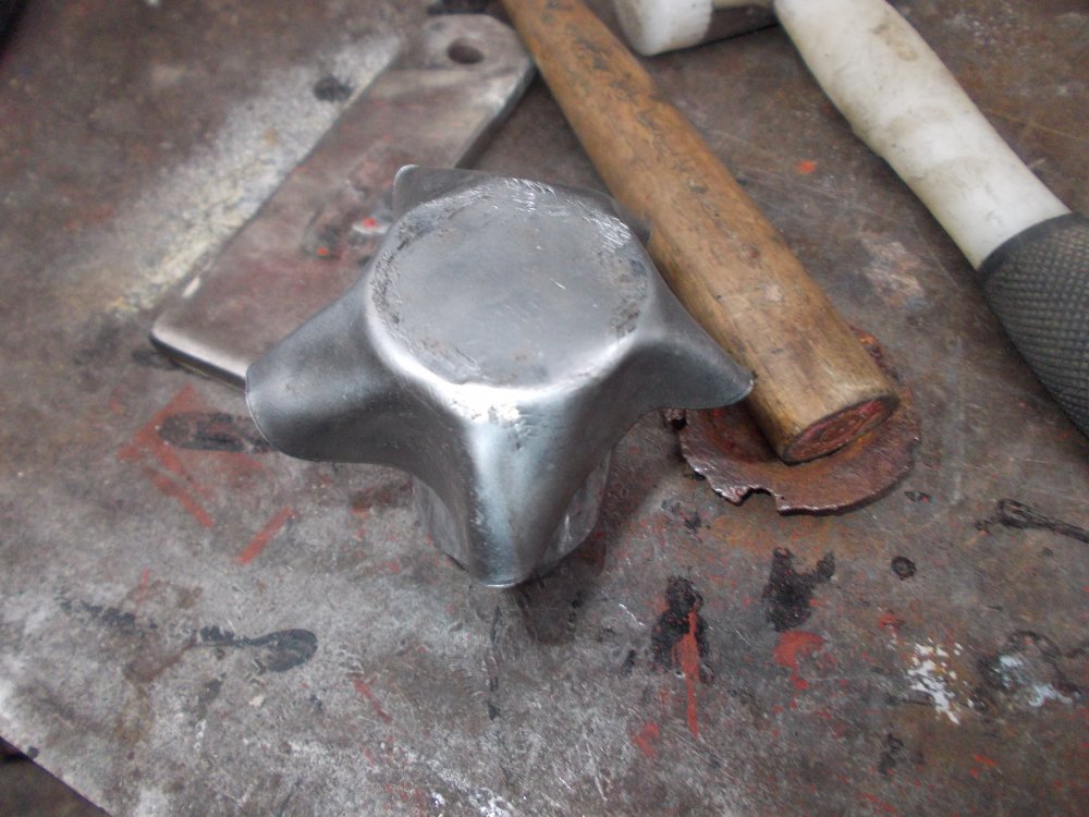

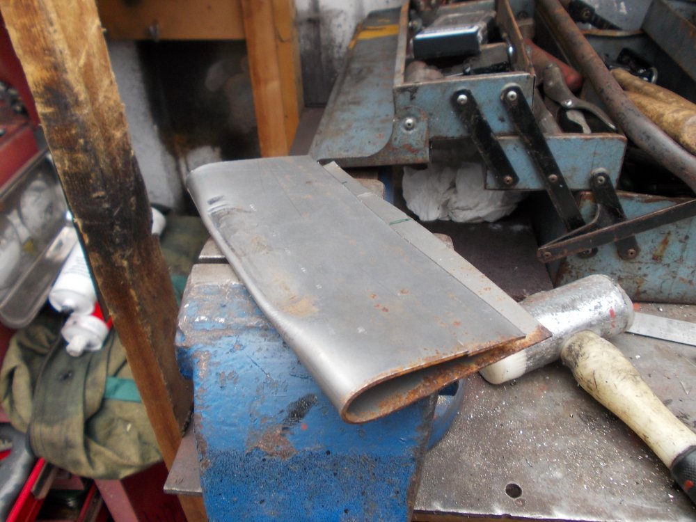

so cut a new piece of 1.5mm steel and folded it over
clamp in the vice and open the ends up a little
then smack the living crap out of it until it takes the correct shape

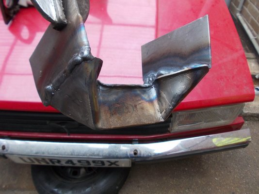

ready for trimming

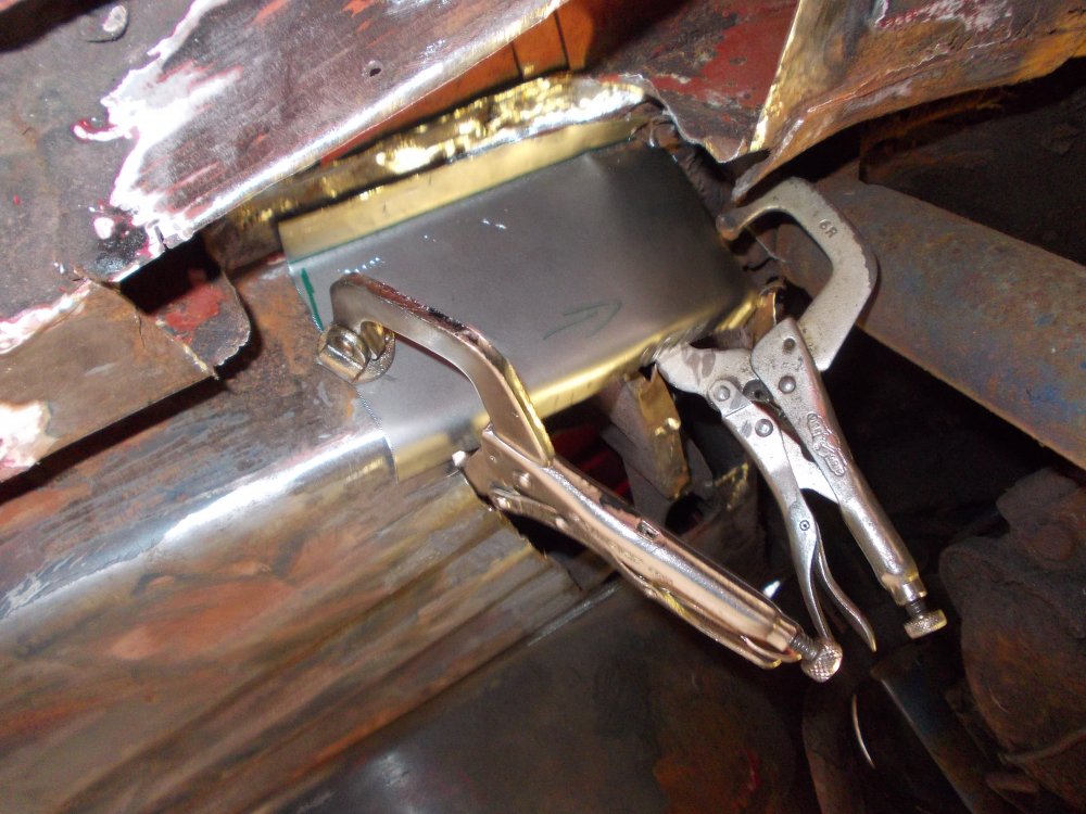

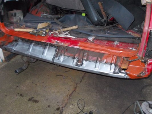

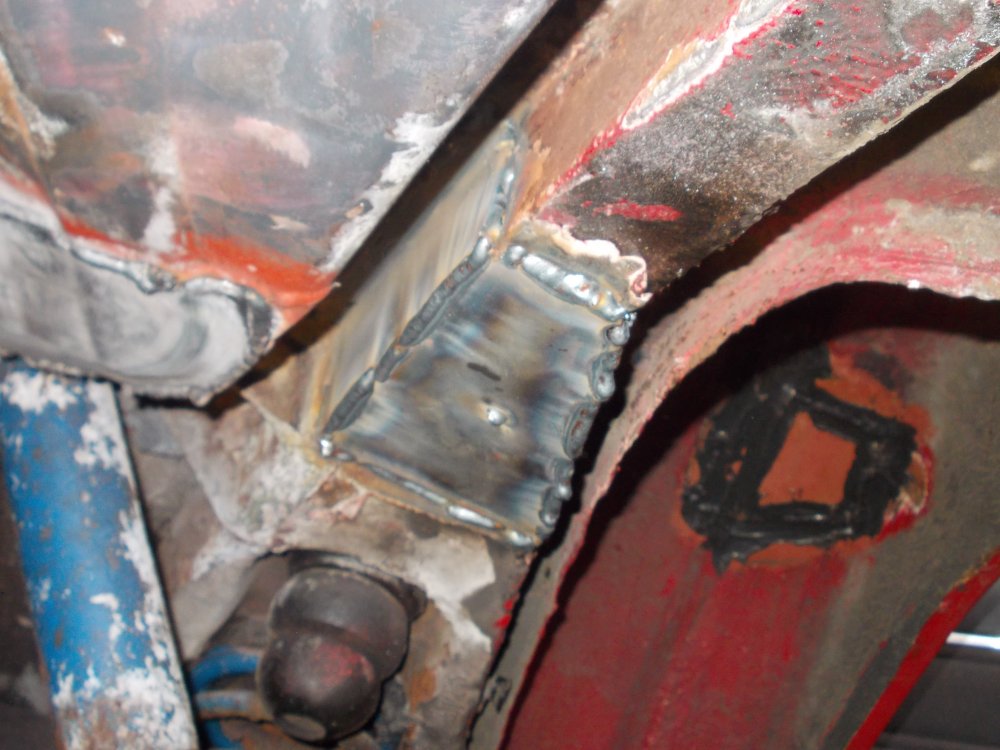

then weld on the extra pieces that attach it to the chassis

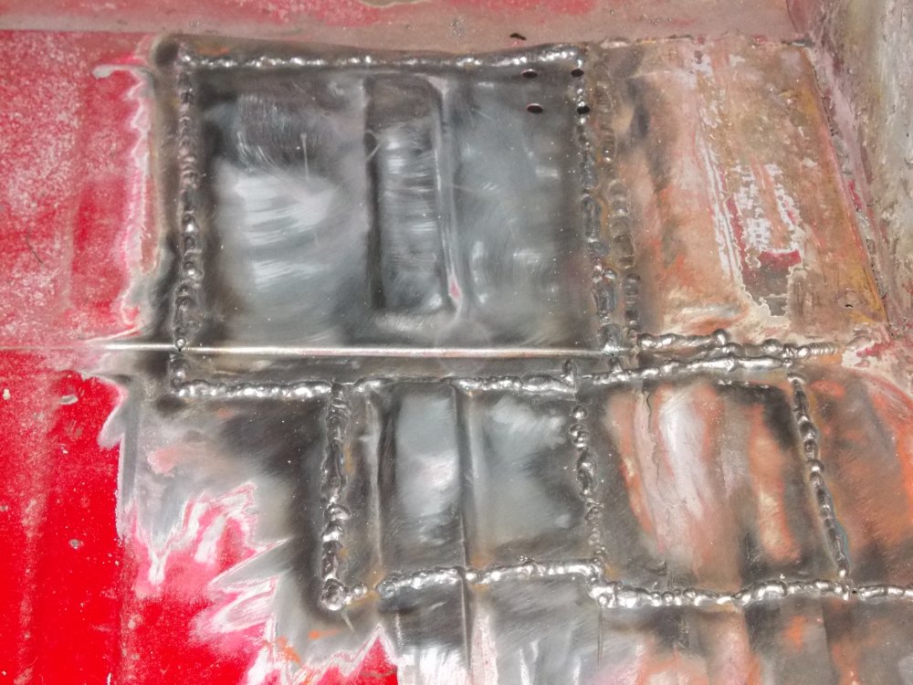

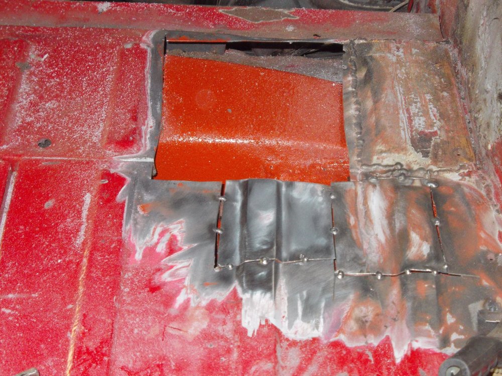

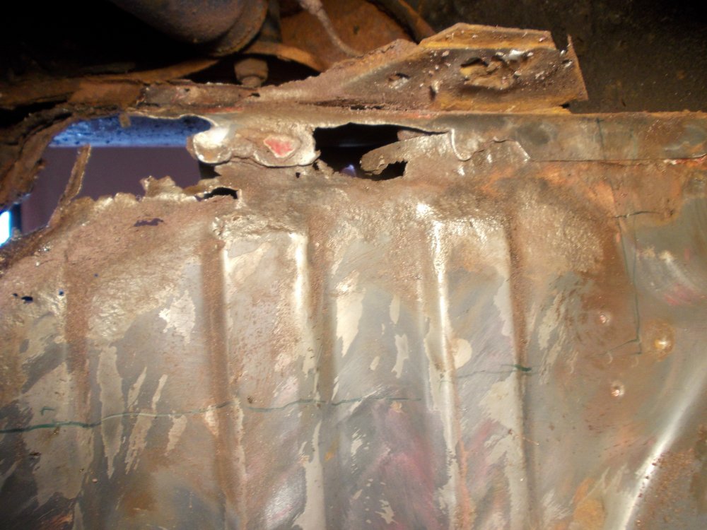

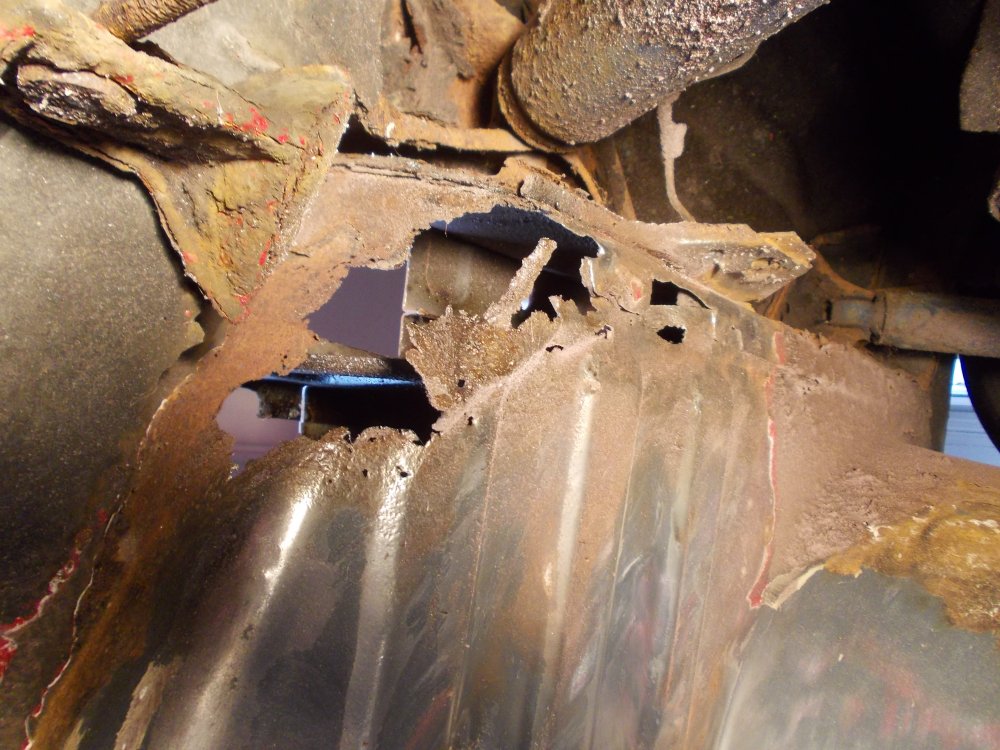

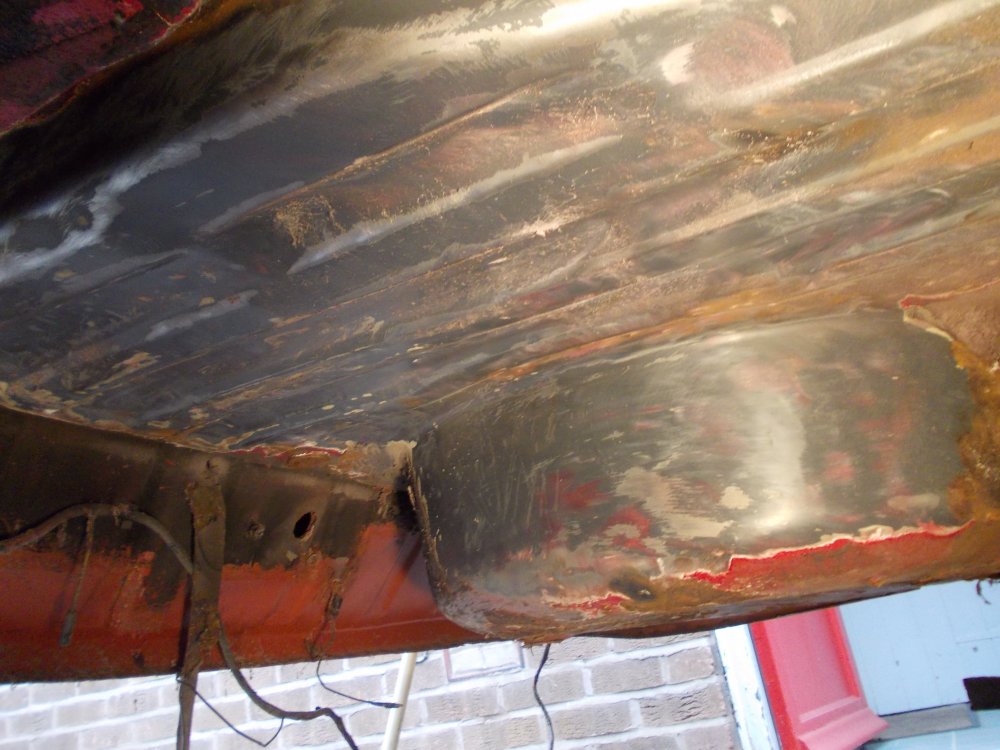

first piece the vertical part of the boot floor which has to go on before the chassis repair

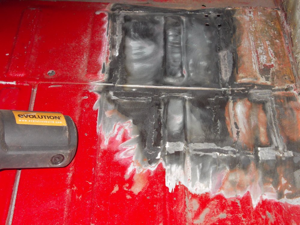

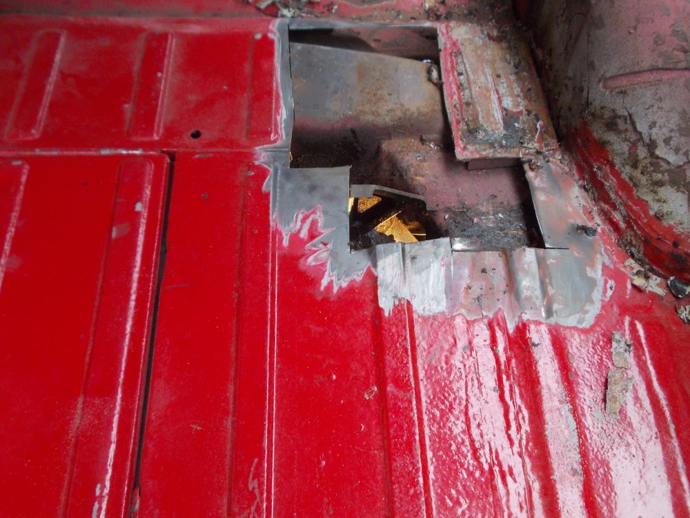

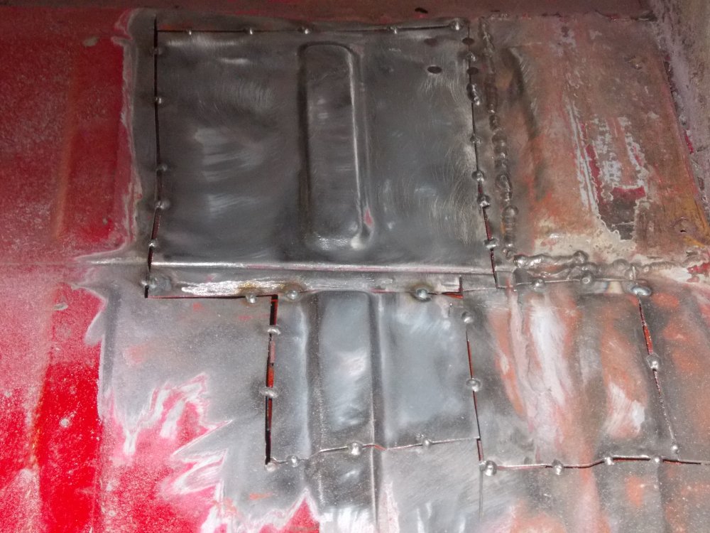

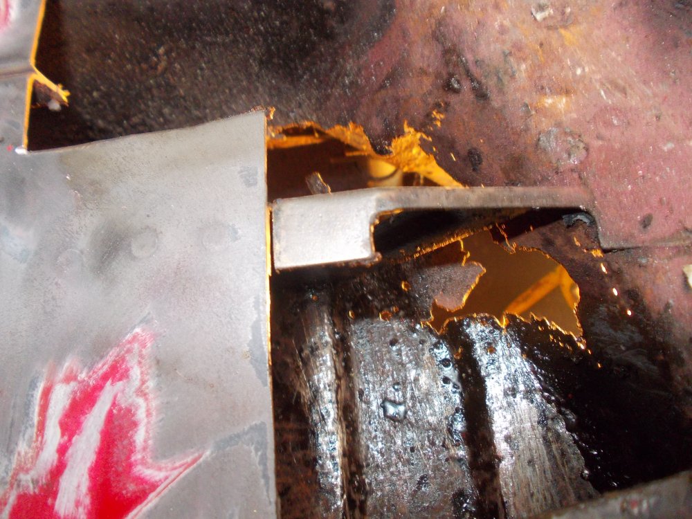

the same time i did all the above i also closed off the cut outs that i did to gain access to the lower boot floor i had to do this as it was covered in waxoil but i suspect the panels were rusting away when i injected it many years ago. so first piece tacked in

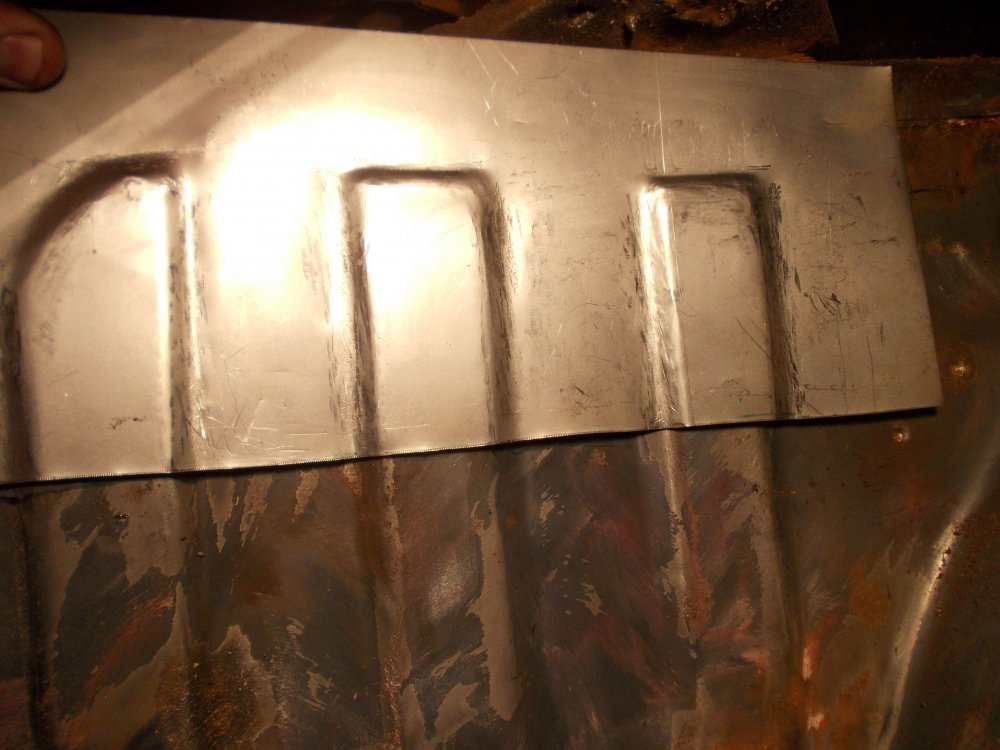

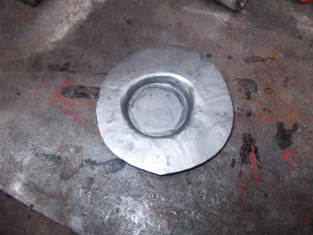

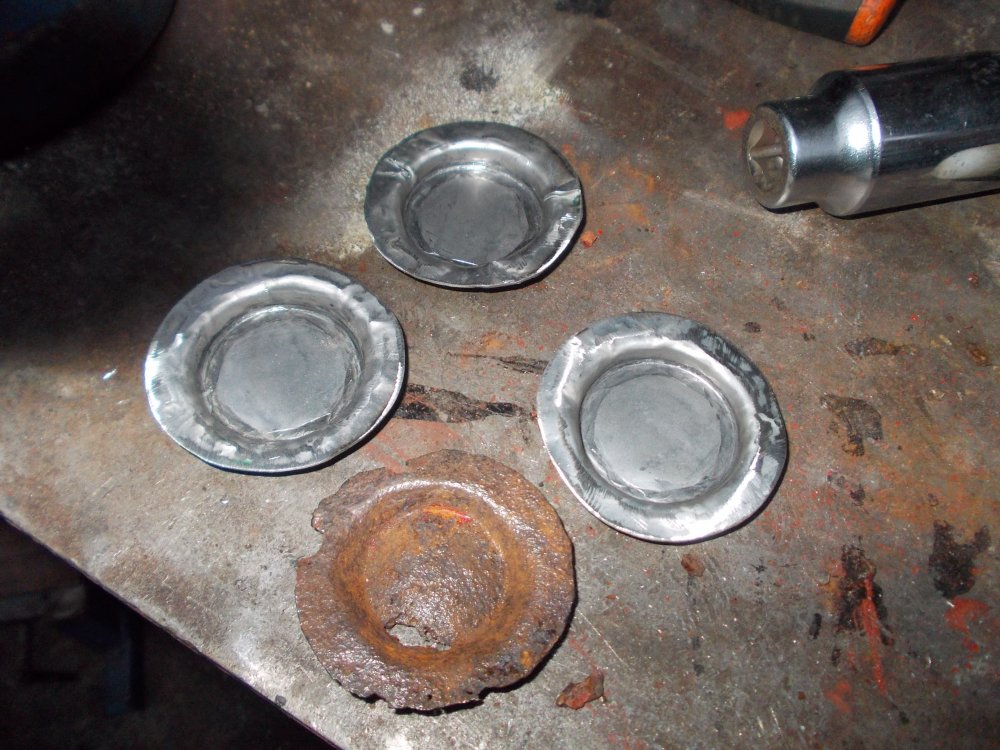

hi, i'll try and take more picsgood stuff , i like the panels you are making
could you post more pics of how you make the panels please

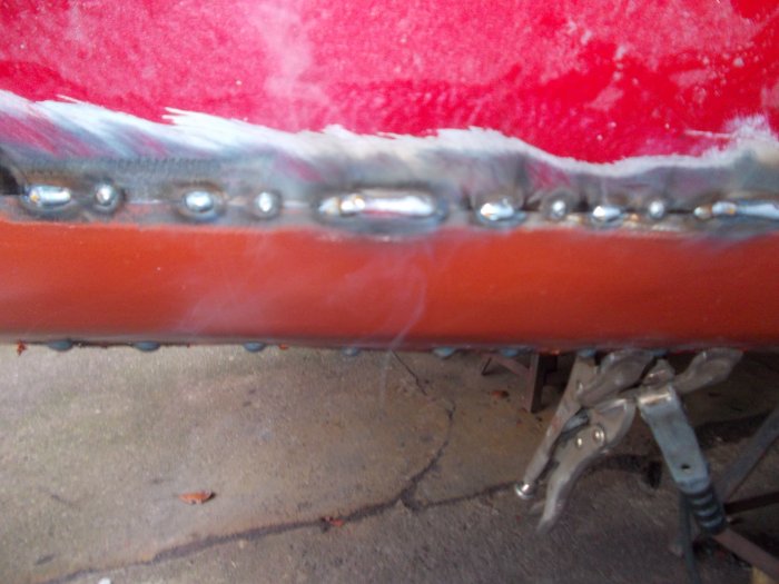

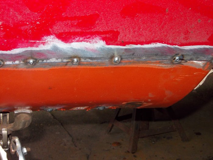

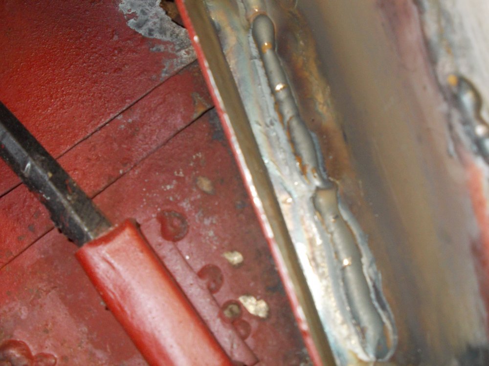

not thick metal at all, 20 gauge or 1mm i reckon plus i cleaned up the edges with the powerfile so probably a bit thinner it's just a case of expecting it to blow through and stopping before it doesNice work. I don't know how you manage to get those short runs without blowing through. Is the metal pretty thick in Cortina boots?
must admit i got it wrong a few times though

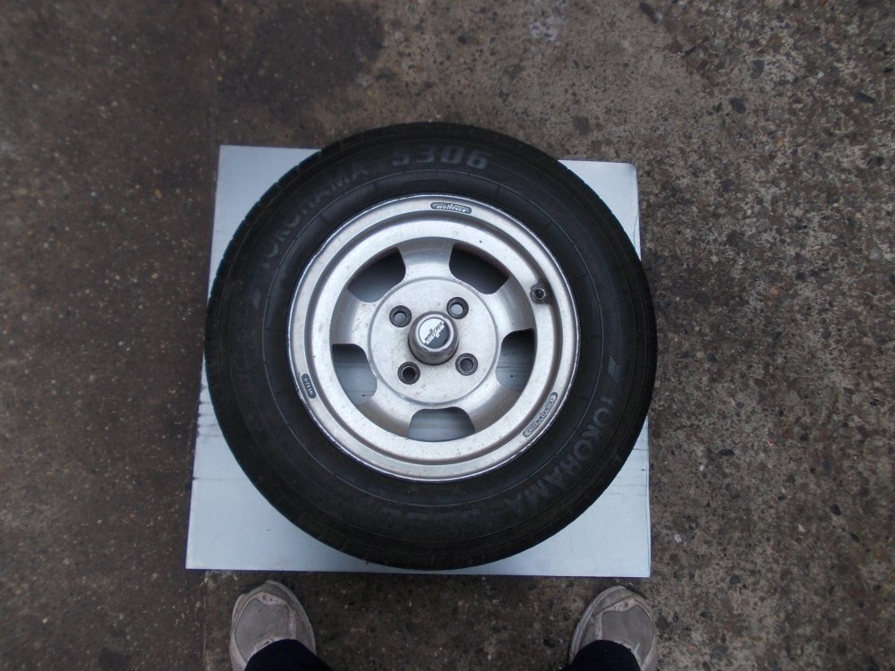

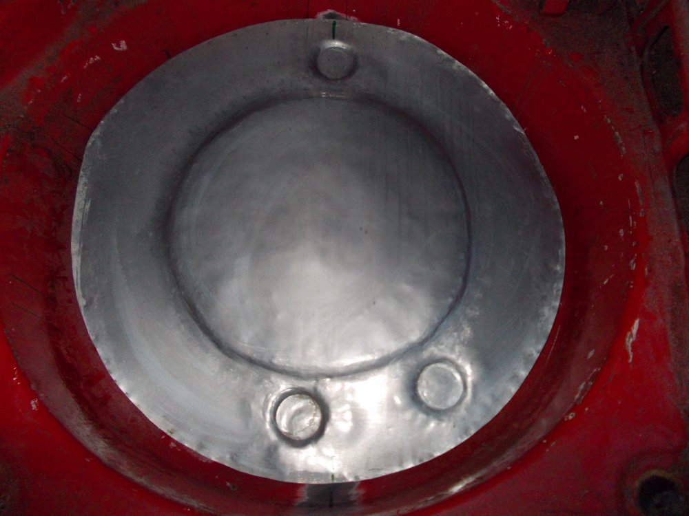

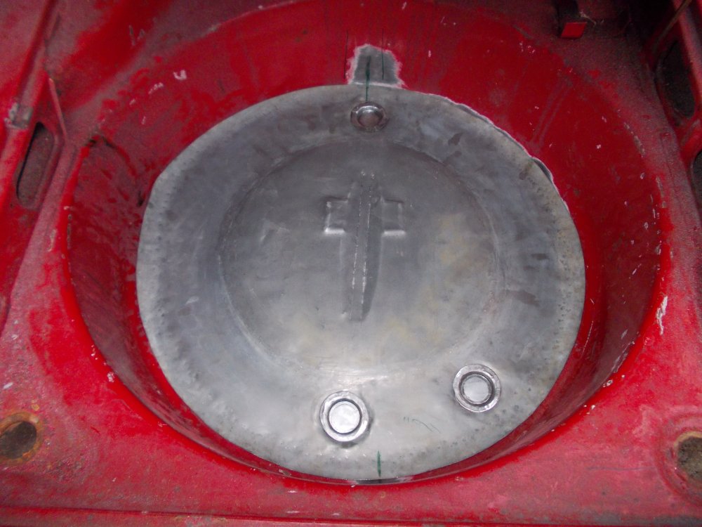

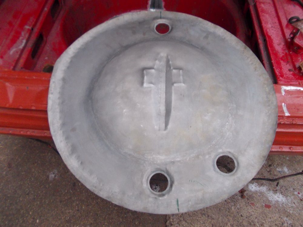

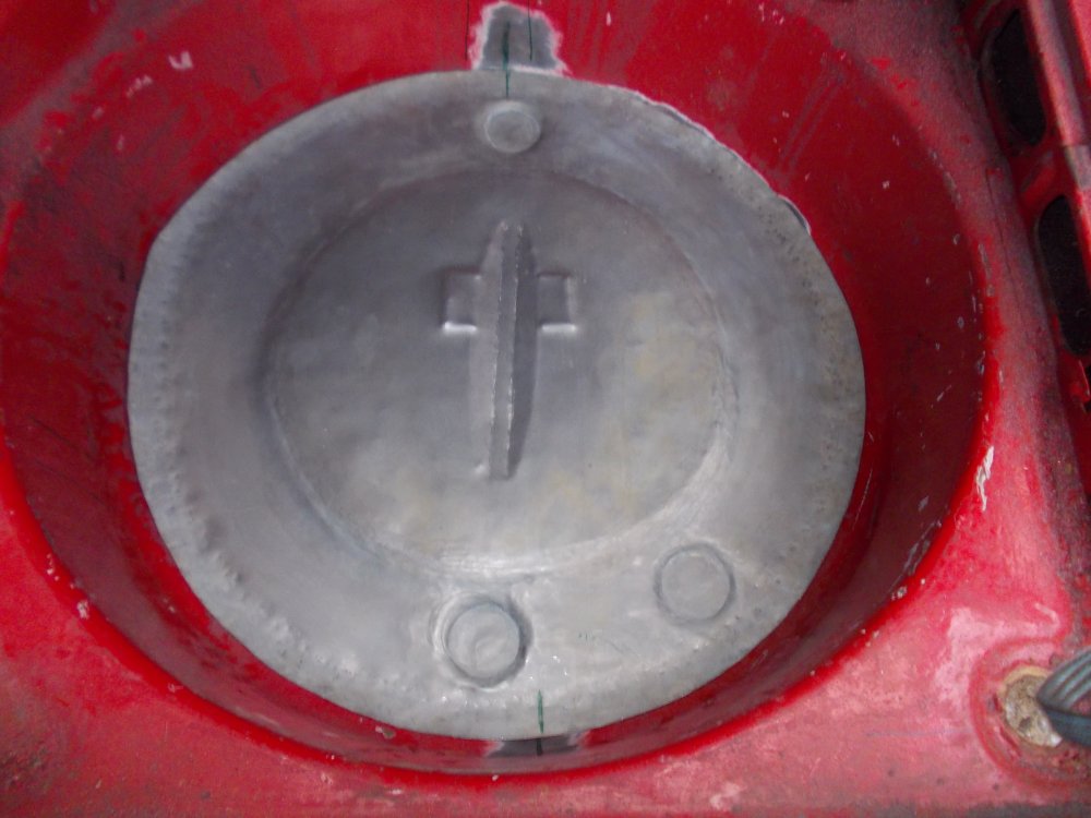

forgot to add the final pic yesterday sorry

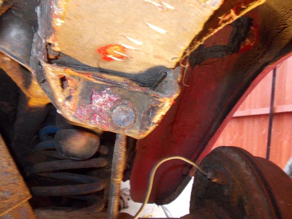

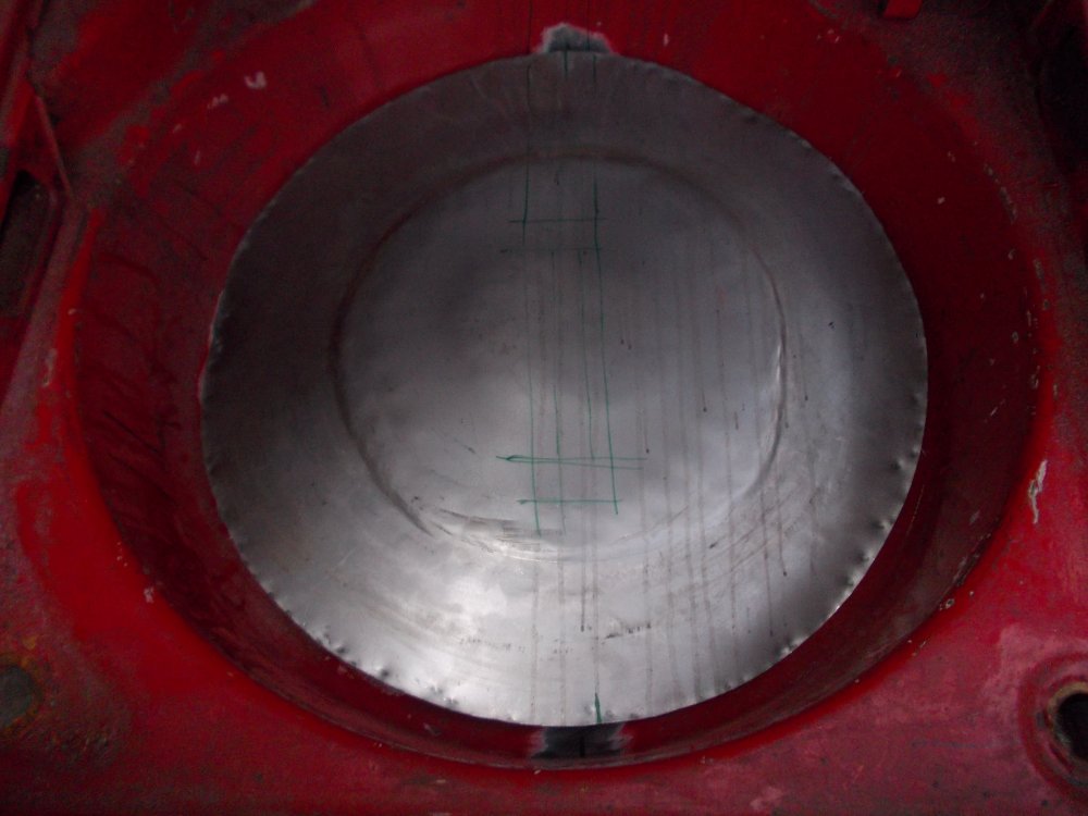

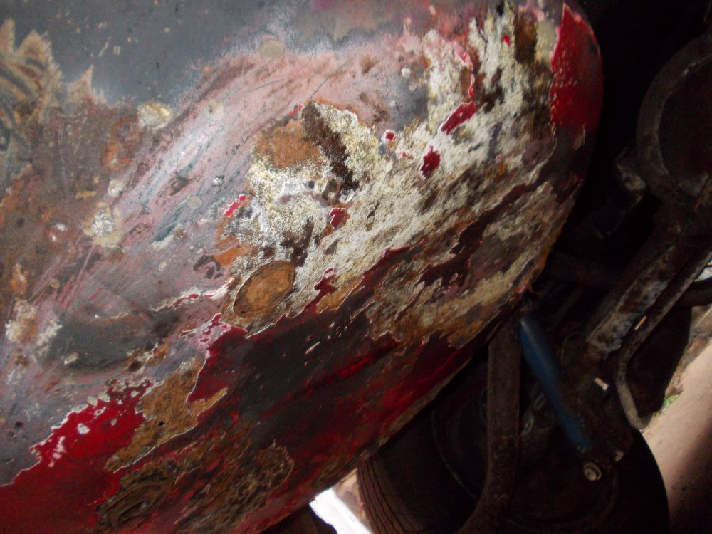

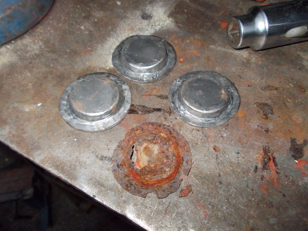

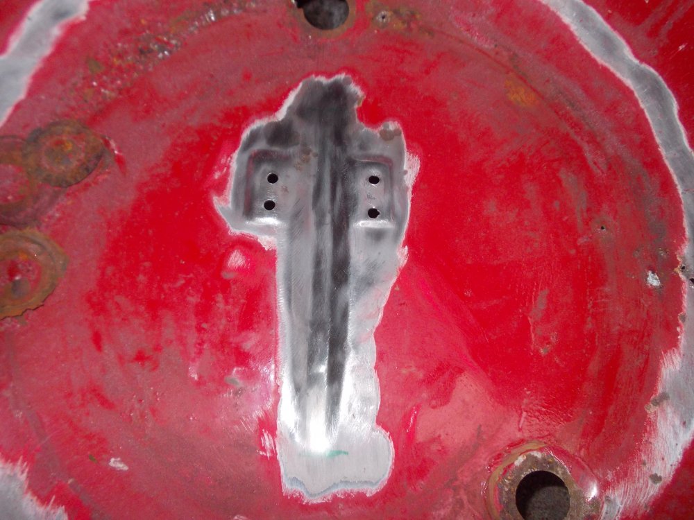

i swear one day i'll get this thing finished. so, the spare wheel well seemed pretty solid
hope that makes sense
