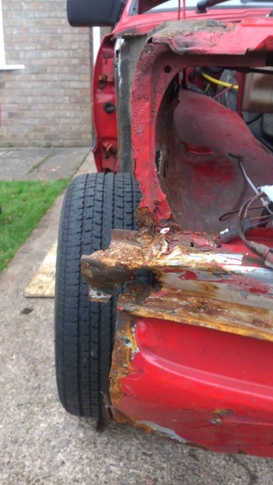

On my mk5 Cortina Estate.
I have managed to 'pull' most of it out, back into shape, not quite finished yet though.
The end of the front panel will have to be replaced … I'm going to have a go at fabricating the piece needed myself, if it comes out Cra...err - rubbish (swear filter, I almost forgot. Lol), I'll get someone who has experience to do it for me, but I have to try or I'll never learn/know if I can do it.
It should be a 'walk in the park' compared to some of your fabrication work.

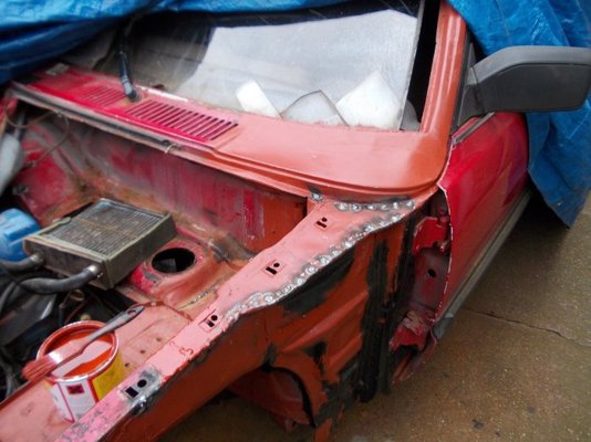

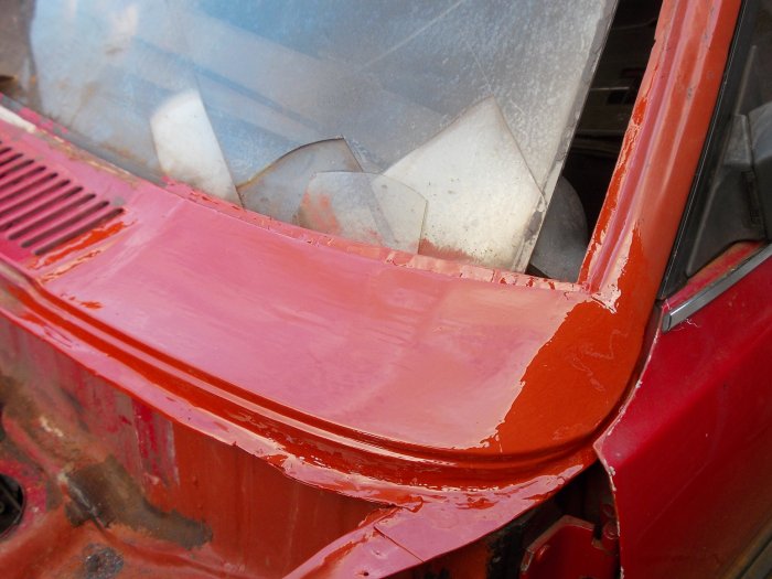

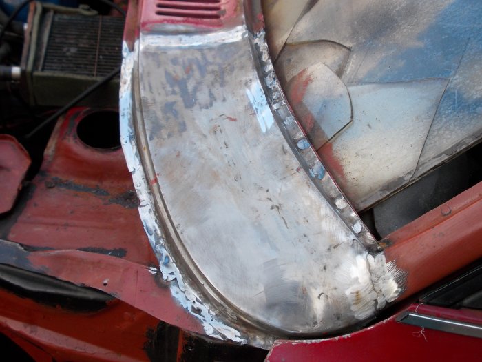

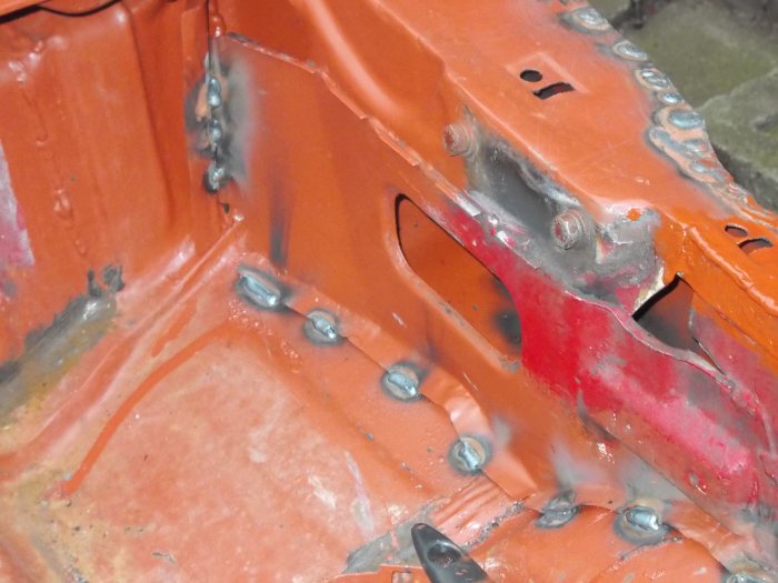

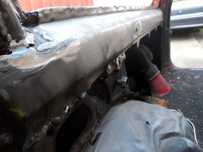

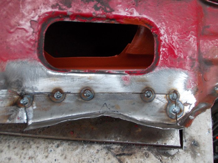

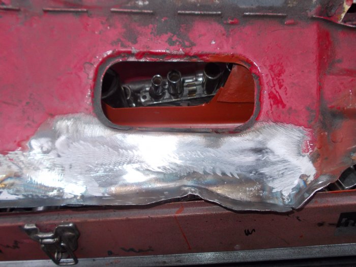

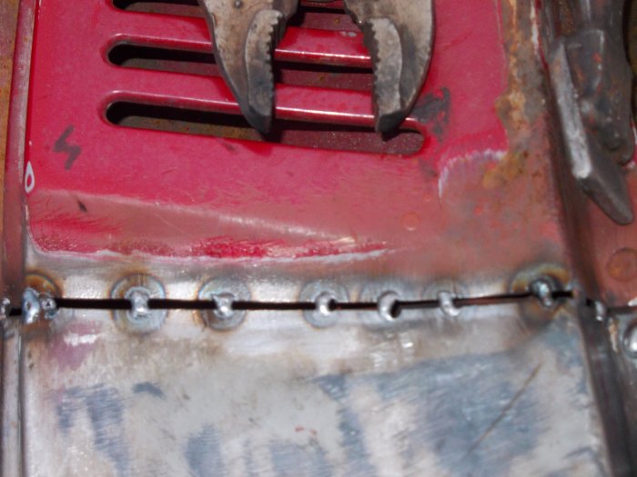

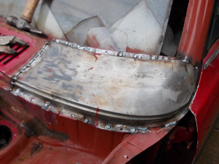

hi, hope everybody is well so despite being in severe pain with sciatica i decided enough was enough and finally welded the scuttle panel in place six pieces had to be made to make the panel usable. tacked in and welded

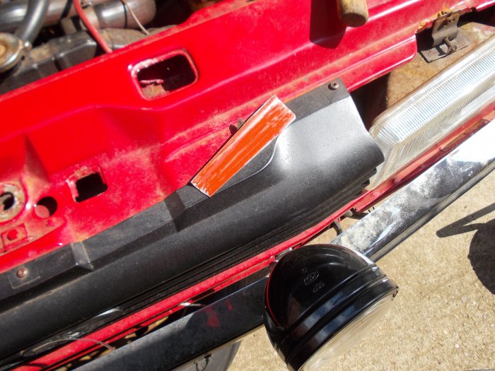

did abit more yesterday, bonnet hinge mounting rot cut out repair panel made tacked in and fully welded and ground down still suffering with sciatica but will keep going

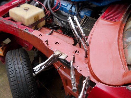

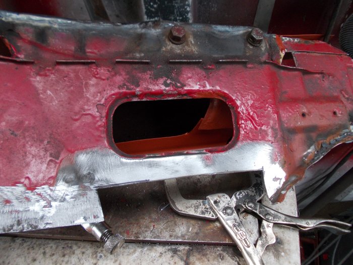

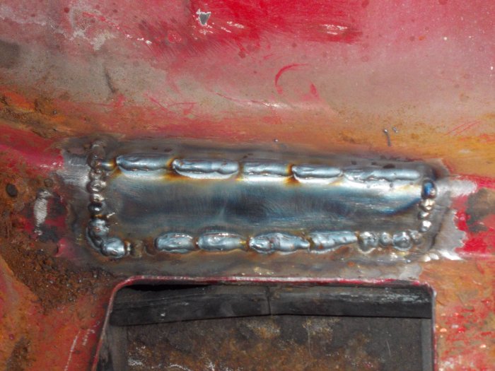

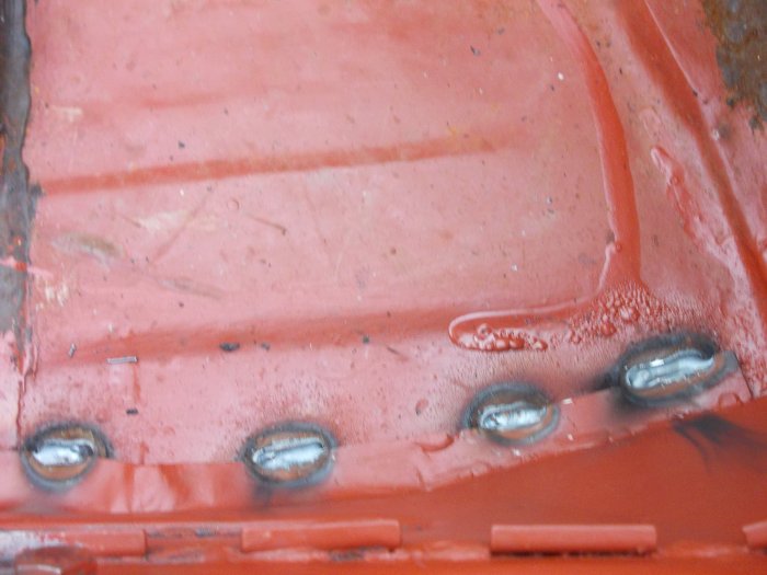

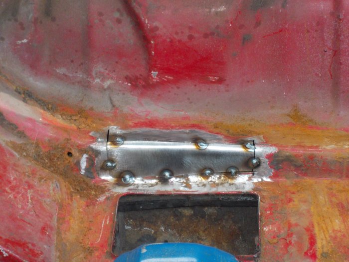

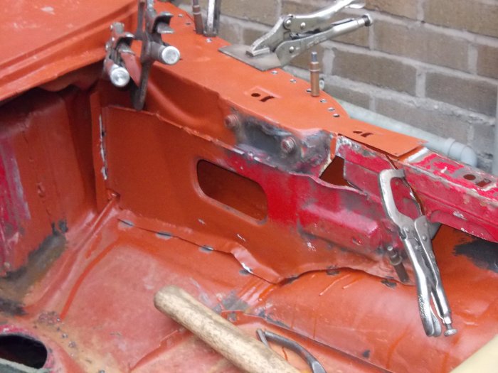

hi, managed to weld the bonnet hinge mount back in place today. clamped up cleaned the edges for welding welded the lower edge as it was originally just need to grind the plug welds back now

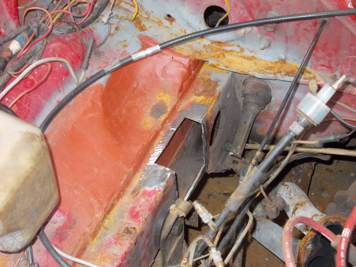

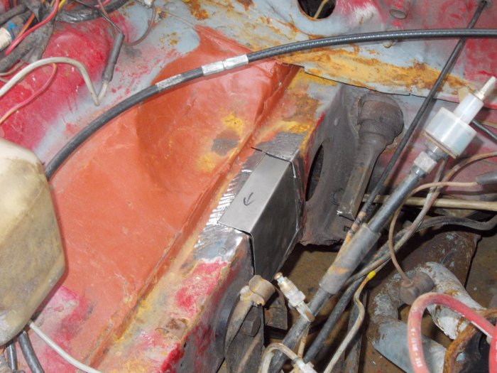

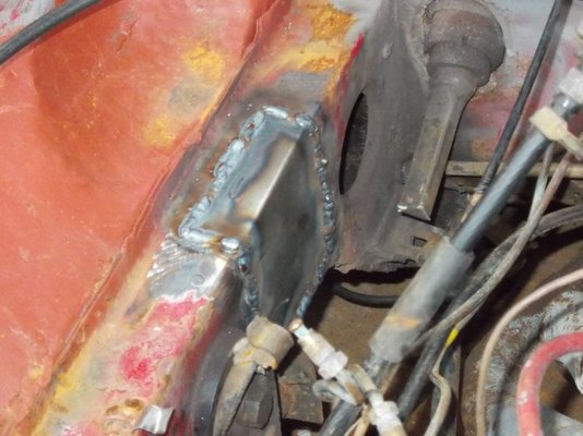

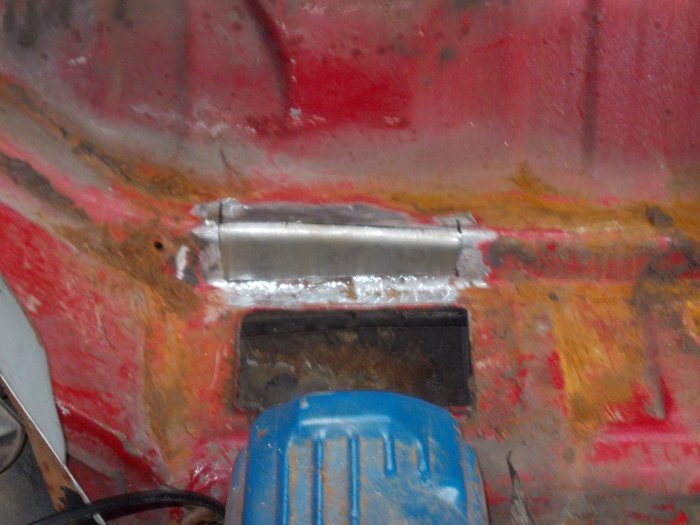

hi all been having trouble with my welder lately (sip) but seems back to normal now thanks to a new relay on the pcb did some test runs to confirm so back on the car chassis rail under the brake servo made the new piece to enable butt welding and welded and roughly ground back will finish the grinding when i paint the engine bay. thanks for looking
Great work, Ian. Very inspiring. Looking forward to more updates. I have loads to fo on my car, but fibd ut hard ti get motivated when it's cold and wet outside.

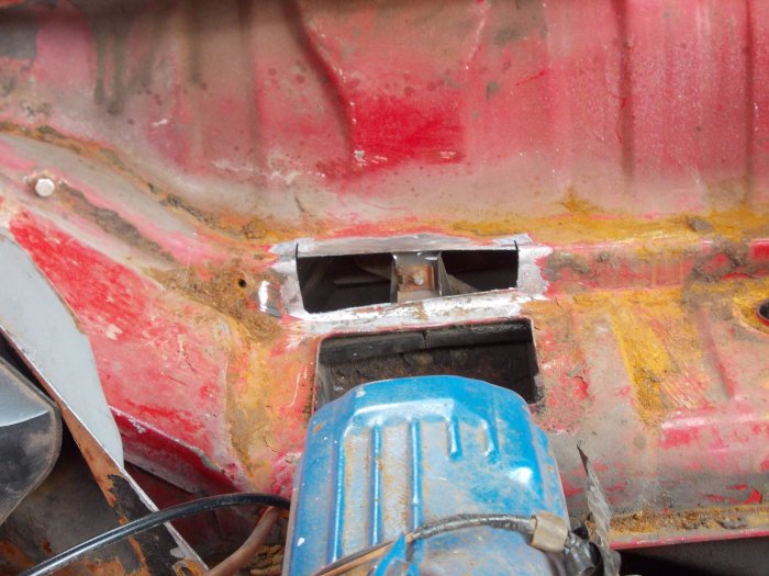

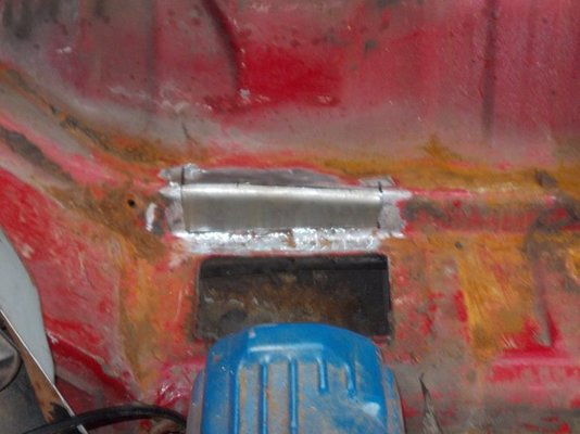

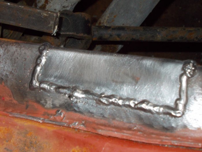

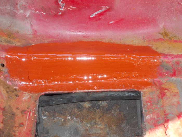

nice weather today with not much wind so decided to repair the rot behind the heater box trimmed a patch for butt welding and painted the inside then lined up and a few tack welds added while adjustments were madethen fully welded a bit at a time to avoid too much heat buildupthen ground back roughly just enough to paint it as the neighbours and their kids were in the garden and didn't want to disturb them too muchfollowed by a coat of bondaprimer to hold it 'til the respray
That is some very impressive welding and fabrication, Ian. I am having trouble getting motivated to work on my car, but your thread inspires me to get stuck in.

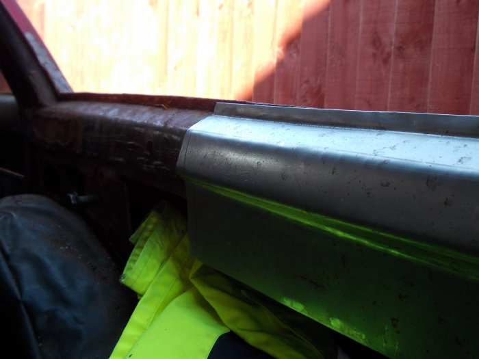

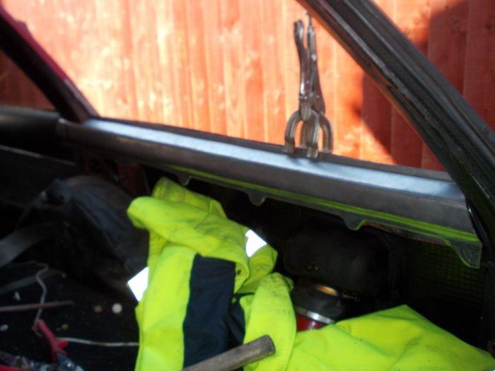

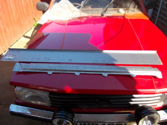

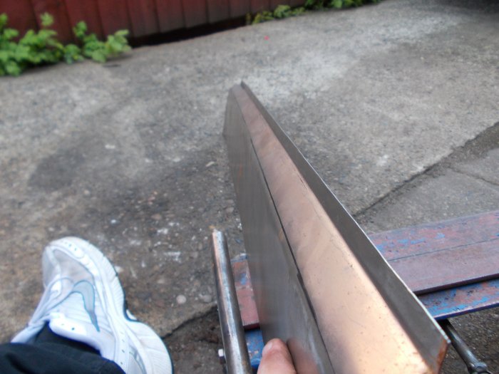

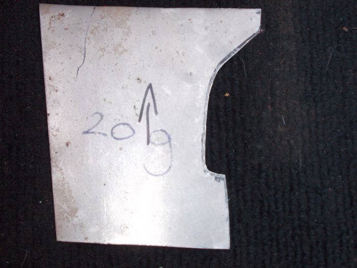

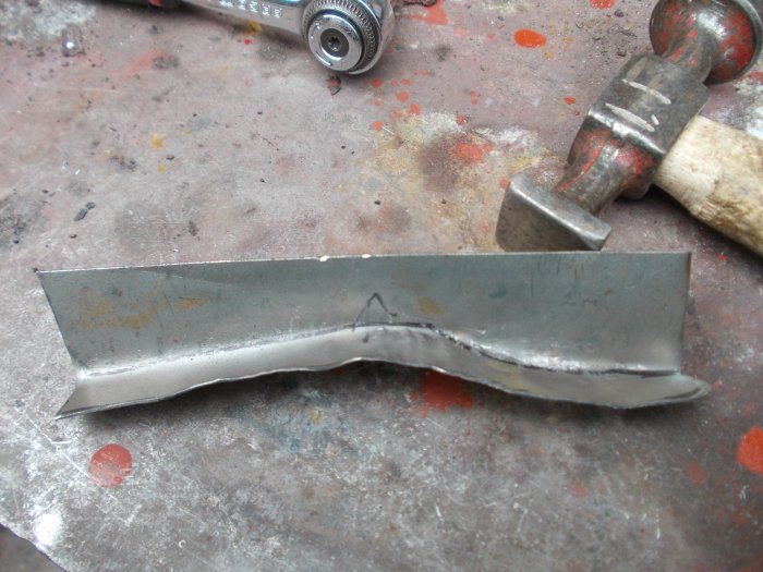

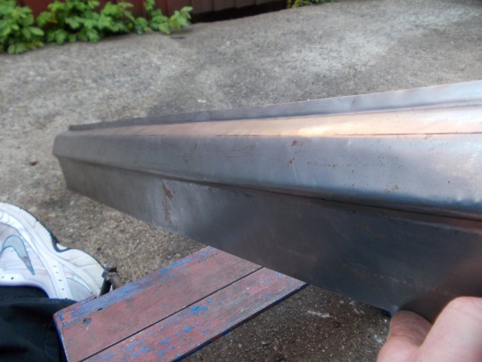

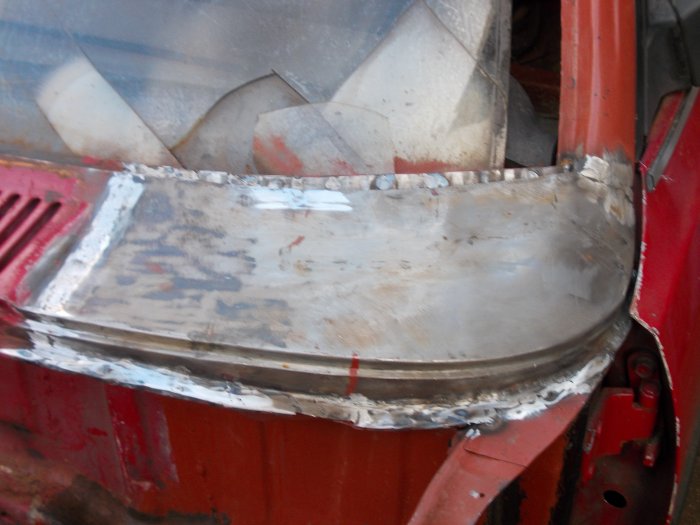

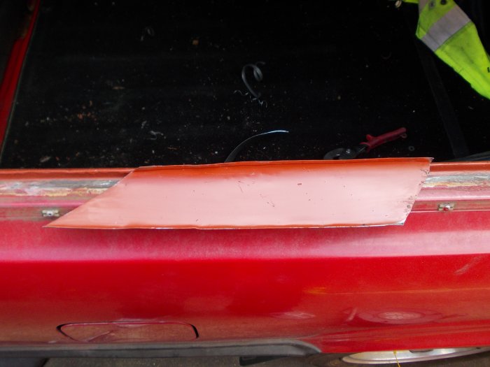

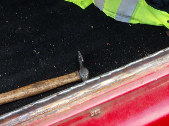

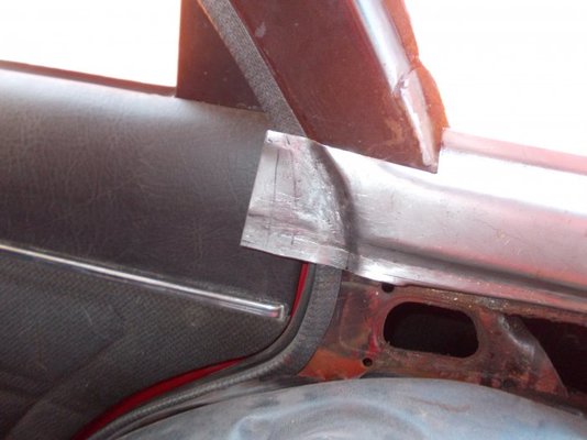

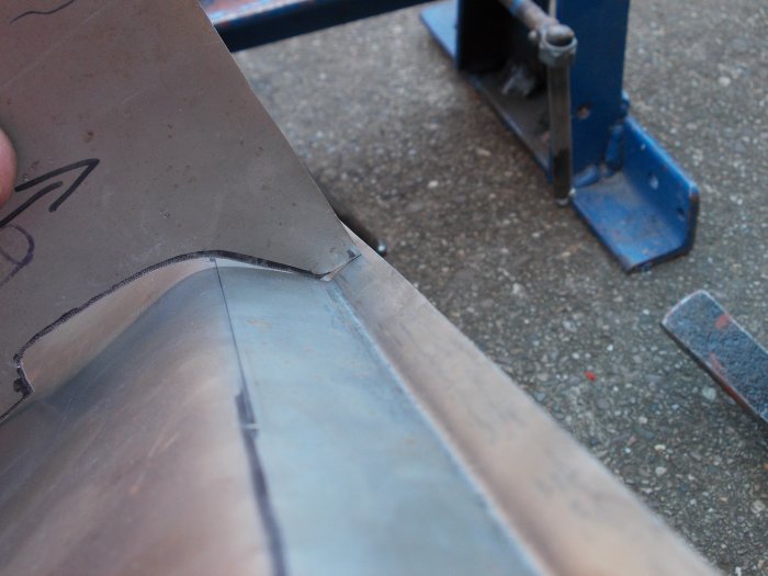

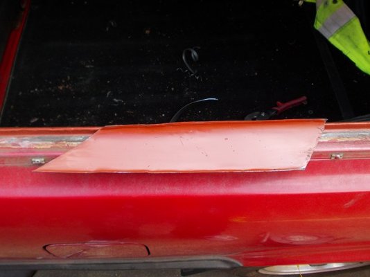

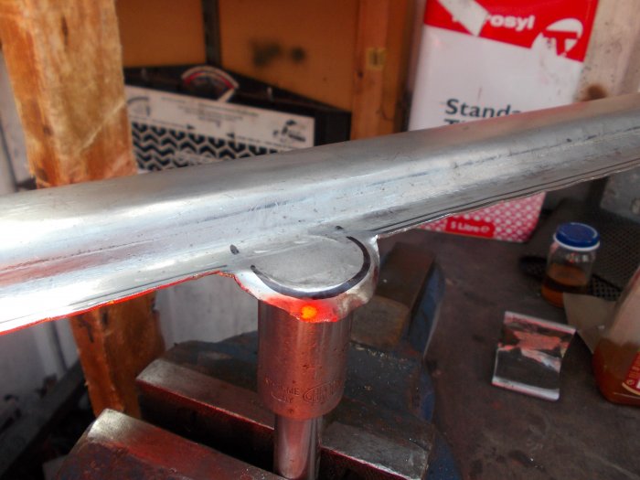

nice weather today so done a bit more,panel below drivers side rear window got a sheet of 48"x6"x1/2" 1mm steel i like this because i have 1 less fold to do (i'm that lazy!) made a template did the first bend check against template then hammered in the bottom fold checking for fit hammering in the tabs another test fit front edge formed not too bad, shame it wont be seen
Top work there i do love fords, your work is inspirational.
Bet that its very difficult to get hold of any panels for your car these days i may start stocking up on sierra panels now as their cheap lol after seeing how much cortina stuff goes for !

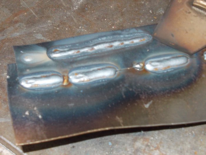

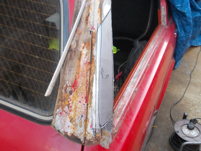

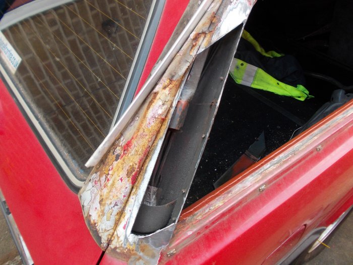

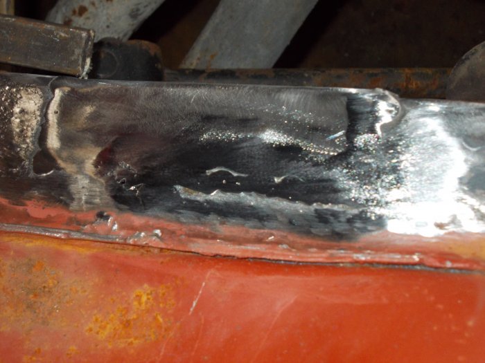

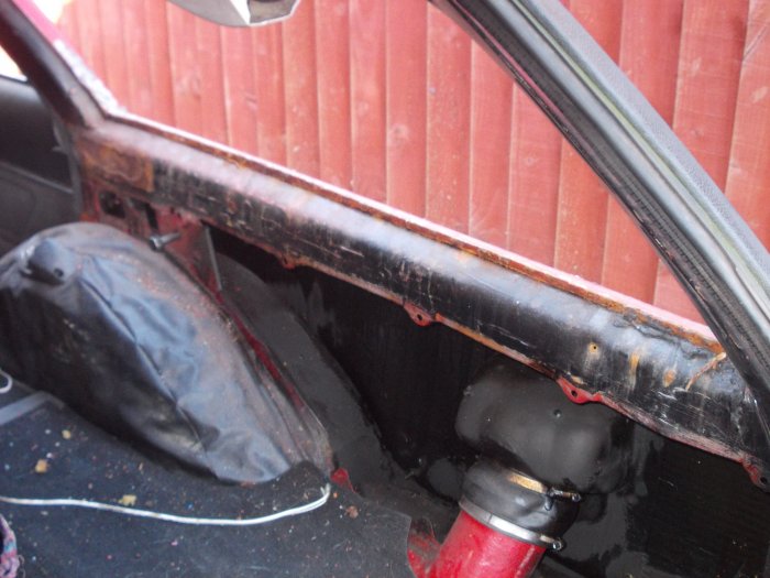

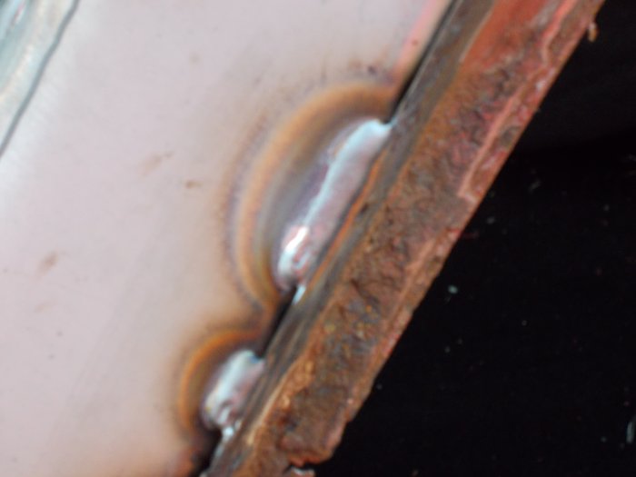

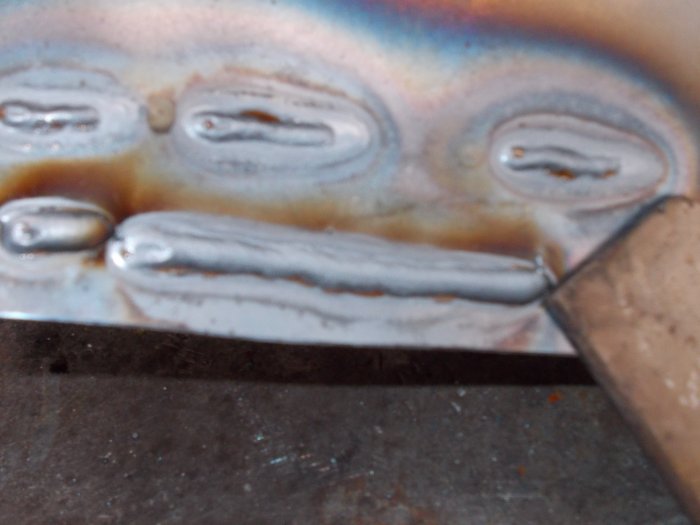

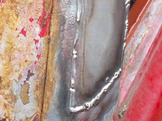

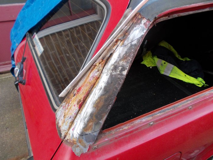

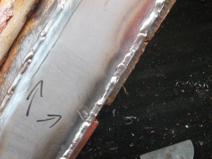

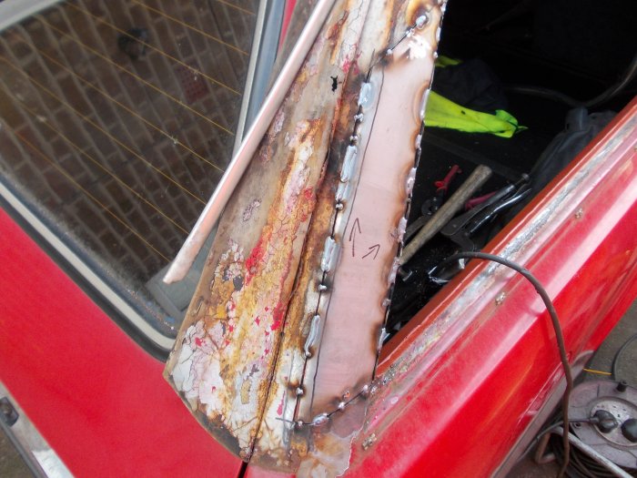

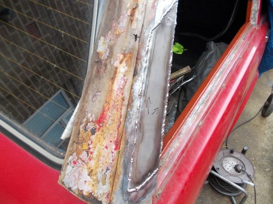

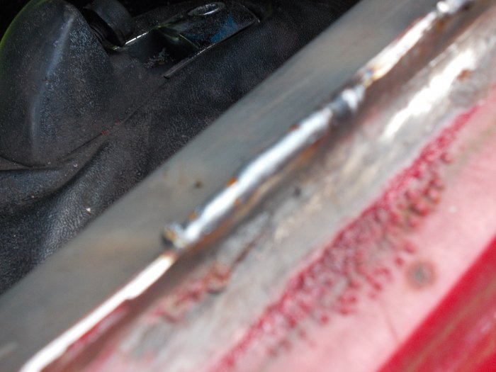

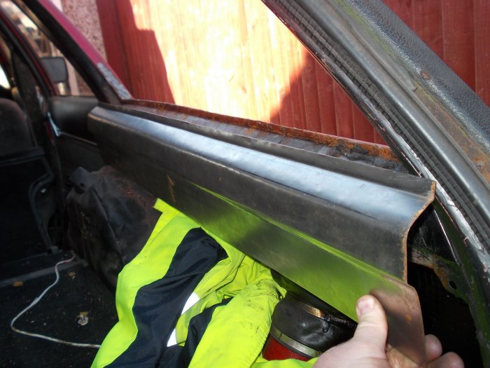

managed to get the panel welded in last week but forgot to post top edge welded a little at a time until complete and inside done as well so todays work was on the roof pillar, too scabby to clean upso cut out repair panel made started welding bit at a time then allow to cool closeup welding completed and wire brushed and a couple of close up shots hope you find my welds acceptable
