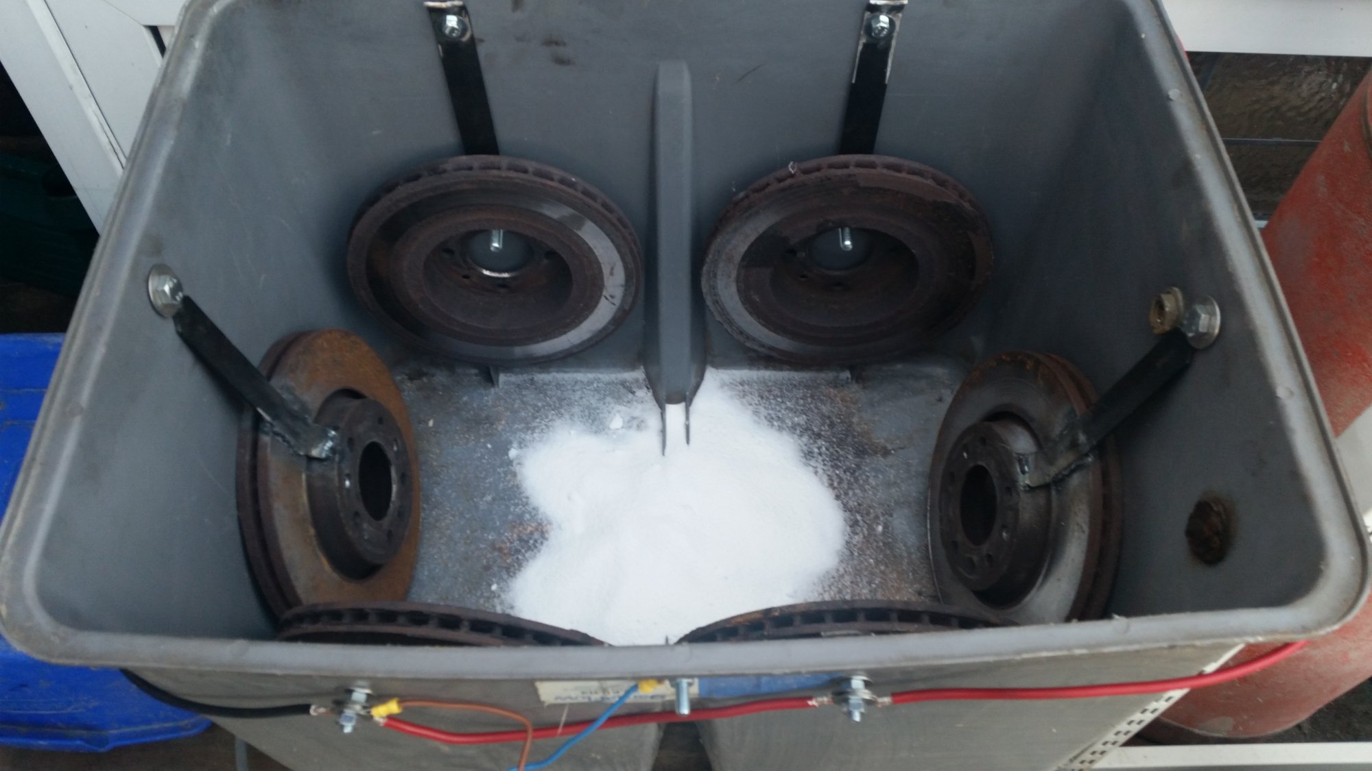

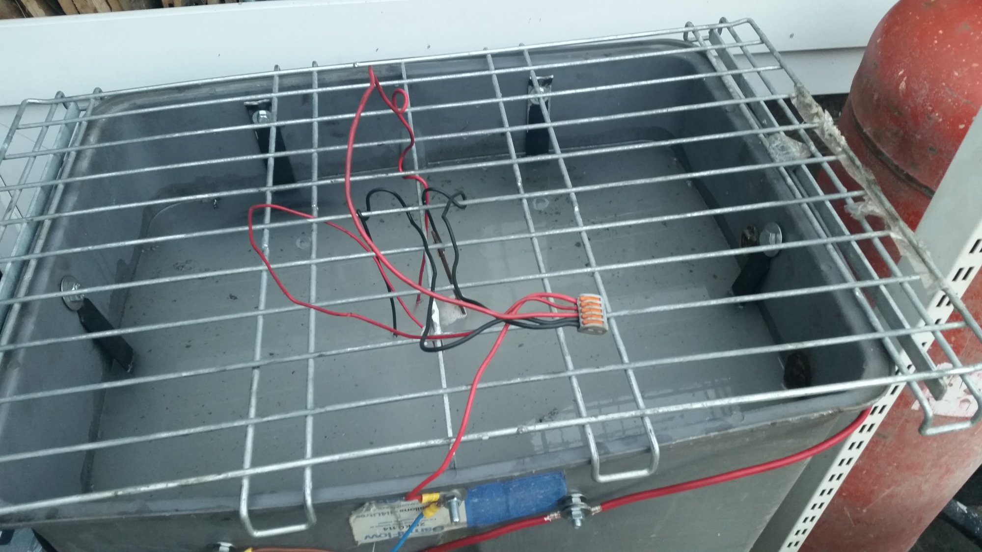

maybe i went ott then with 6 brake discs and 20 odd gallons of water
Put a current limiter in.
a 12v 21 w indicator bulb would limit you to around 2ampsIf you put a 12v bulb in series it will limit the current it can draw.
how does the lamp limit the current then just want to know the science behind that
