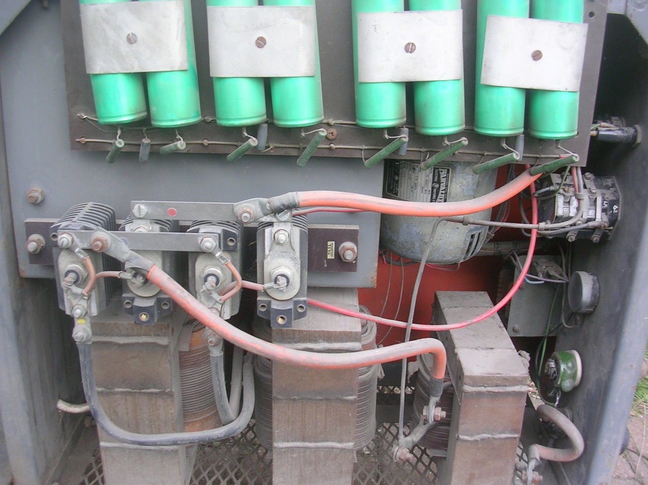

rather ironic for a welder manufacture to use rivets !If all the relays are still in that one, it would be a good solution.... I like the way that the frame is fastened with riveted and bolted corner gusset plates, like a 20's wrought iron bridge.

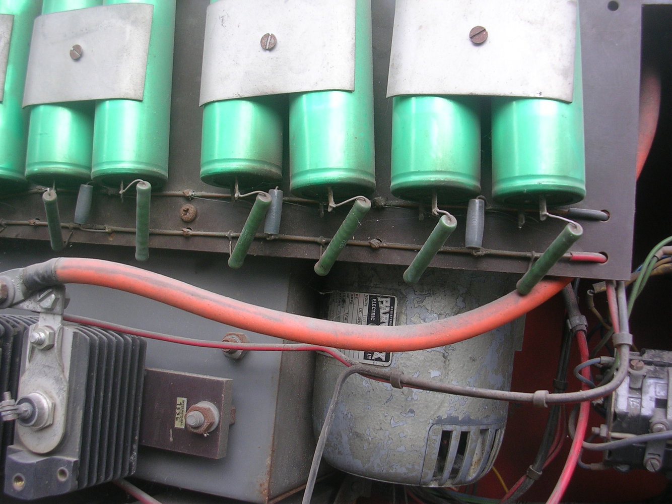

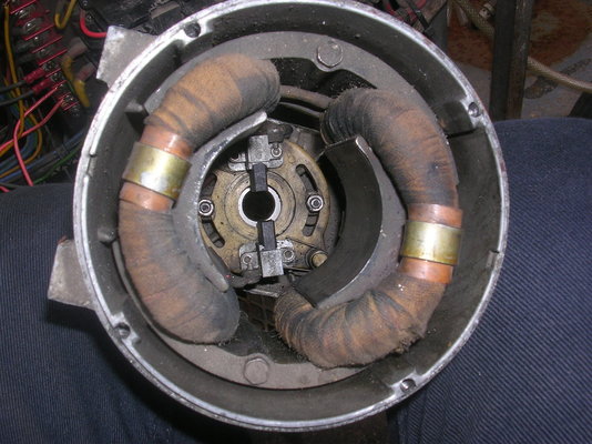

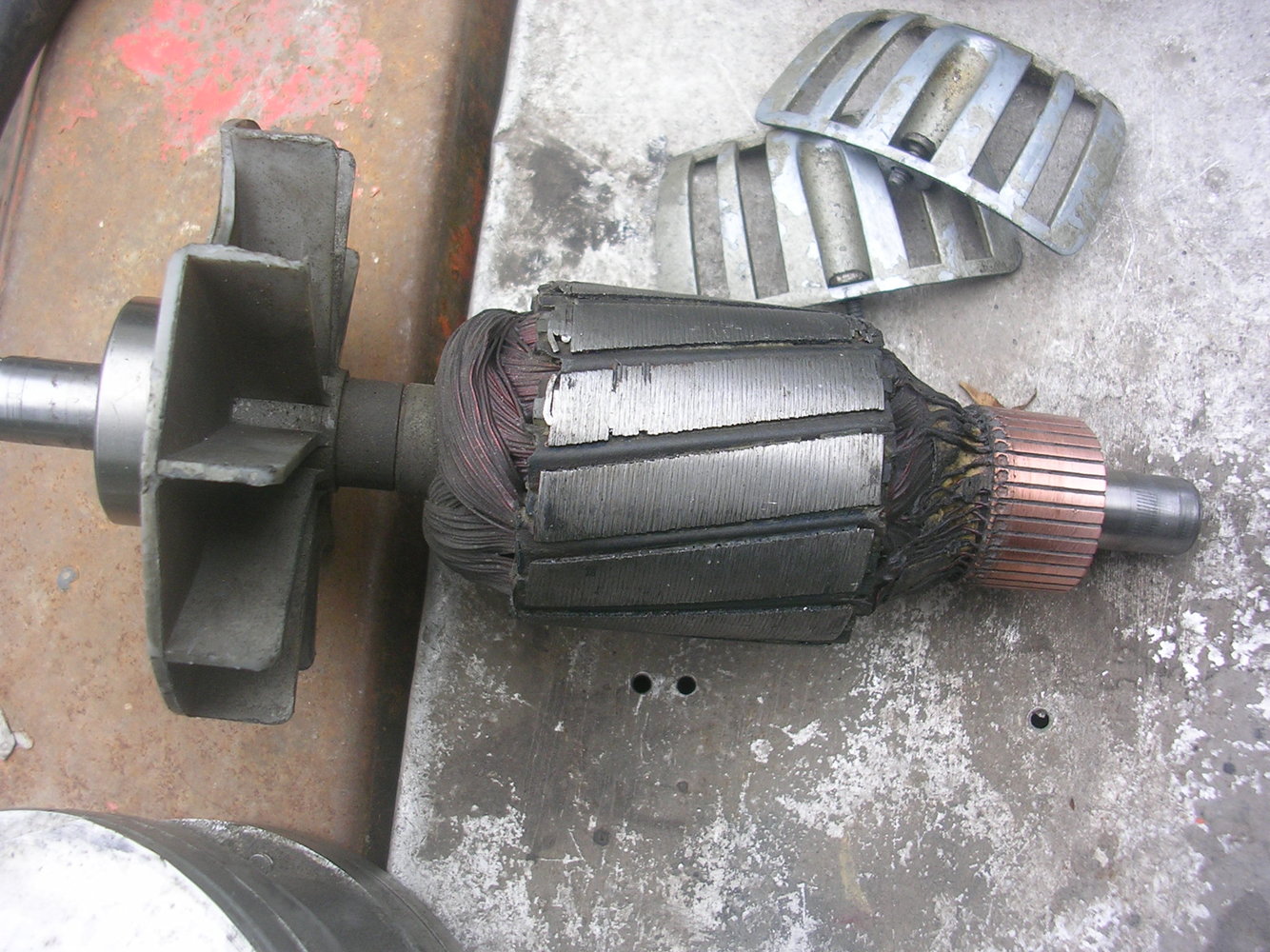

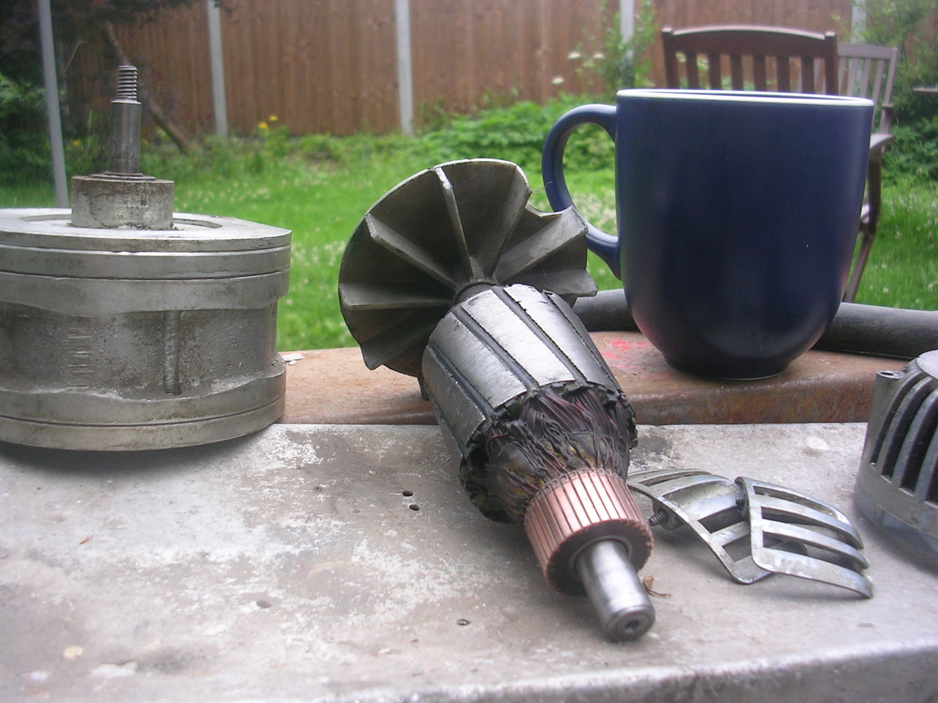

With welding voltage present but no feed motor action, I gave it a 'short circuit' using a MB36 with a worn out tip. It produced a nice, gentle blue arc.
How to test a 110 volt DC shunt wound motor with minimal equipment?
So, I'm at a bit of a quandary now what to do with it, as I don't need / want it, long term:
1. Carry on, without much idea what I'm looking for.
2. Offer it to someone to take over (hint...)
3. Scrap it (....NO !!)
4. Use the awesome massive transformers / diodes / 8 caps to build a FrankenButters, housed in a smaller case, with a smaller Euro wire feeder and a universal control PCB instead of the telephone exchange of aged wire and relays.
