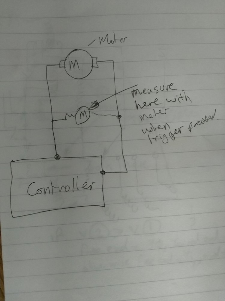

No progress has been made without 110 vdc.Did you get the motor working or is it still the show stopper ?
It should run on much less than that. I've ran brushed 240V AC motors on 12V DC for test purposes. Another alternative is to crank your mig up to maximum volts output, release the wire feed or remove the wire, connect the 110V motor to the torch and earth clamp and press the trigger. You'll get 1/3 of the voltage to the motor and that should be more than enough to spin it up.No progress has been made without 110 vdc.
I did this test tonight and the motor is fine.It should run on much less than that. I've ran brushed 240V AC motors on 12V DC for test purposes. Another alternative is to crank your mig up to maximum volts output, release the wire feed or remove the wire, connect the 110V motor to the torch and earth clamp and press the trigger. You'll get 1/3 of the voltage to the motor and that should be more than enough to spin it up.

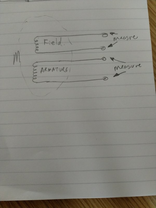

No, put it all together, bolt it back into the chassis - it obviously works because you had it going round . Connect it back up and then measure the voltage across the terminals that you connect it to. I'm assuming that it's a standard DC brushed motor with only two terminals on it. Just want to find out if when the trigger is pressed, you get 110V across it or 0V.Thanks DSR. Are you saying measure the voltage across the field coil and armature?
The first thread that I linked to in post #60 describes the motor as shunt-wound. I think it could be better described as a separately-excited ( sepex ) motor, with speed control by varying the armature current.
That bike is in better condition than most of us hahahahaExcellent idea, thanks! I'll wire up the field and armature in parallel and try that.

If you don't get a voltage on both readings then more investigation is needed. I can't see anything on the circuit or the photos you have supplied that looks remotely like an electronic speed controller. When it was made, power transistors and thyristors etc. were still relatively new and having something to control a 100V motor would have been expensive. I think the motor speed is controlled directly using the speed control potentiometer, it's probably a wire wound high power job so have a look at that at well as checking the voltage.Yes, it's four wires to the field and armature of the shunt wound motor.
I'd also look to make sure the wire feed transformer is giving out 110V AC and trace the 110V through the wire size switch to the pot and then to the motor. Be careful with the wire feed transformer - I think it may be an auto transformer so have mains voltage across the two outer pins and use a centre tap to provide the 110V. Not quite sure what the wire size switch does - it's not too clear on the circuit diagram but when you are measuring the voltages, make sure you measure them with the switch in both positions as well.
It actually looks very simple and there are no mysterious electronics in the way, a good old fashioned rheostat in series with the field coil or the armature will work very well if it can handle the current.
