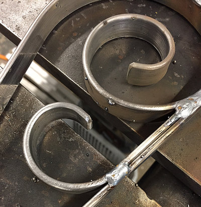

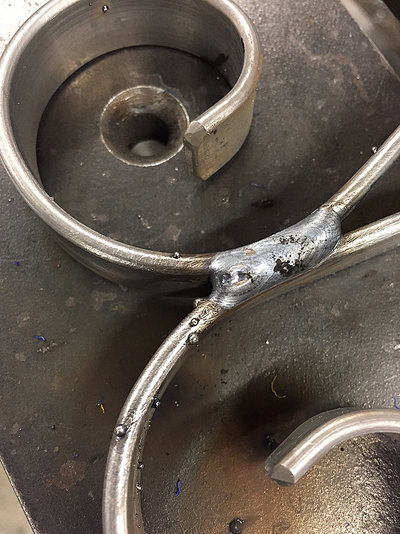

Been suffering some issues for a while - lots of spatter being the most annoying, all of my stuff is ornamental and takes ages to file off the spatter.
I ran out of 0.8mm ER70s Mig wire yesterday, had a roll of 0.6mm SifMig SG2 in the airing cupboard
Took a while to get used to the new parameters and on 3mm steel the wire feed is pretty much maxed out but WOW! what a change in weld - nice smooth beads and zero spatter, not a drop!
I've ordered some 0.8mm SG2 so hopefully that will be as good.
Very odd as i wasn't expecting that, happy though.
There was no rust on the 0.8mm, nice and clean right to the end.
