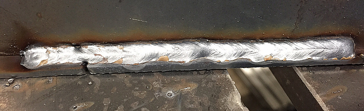

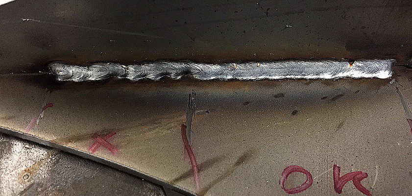

might sound daft but theres no impurities in or on the metal being welded?
could it possibly be cleaner?
Too much wire
Not enough volts
Excessive stick out
Wrong angle
Wrong travel speed
Then you have all the other stuff like, contaminated plate or consumables etc etc
It's really just a process of elimination, sort one thing at a timeA lot then!!!
