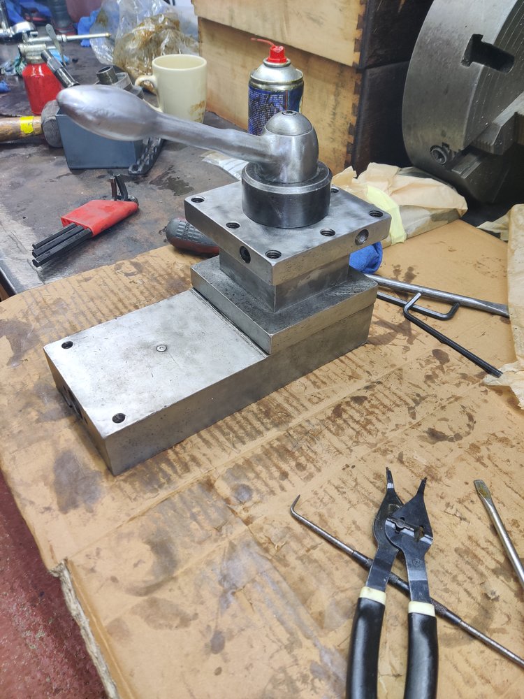

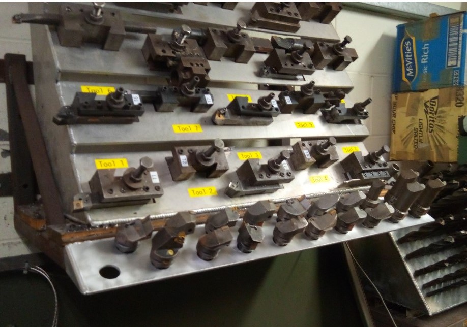

Kurtis only uses inset tooling. All that requires is to set the tool height by some permanent method (grinding the holder or fitting a fixed shim) and he can swap and change at will.
Looks like the previous owner just welded shims to a few of the tools and kept some shims in the boxs of other tools so only mess about with their centre height once that way like you say.
I do agree the QCTP is nice and handy since I have used it on a student before but for the extra cost and butchering of the machine I'm not too fussed at the moment , However not used the lathe for that much yet so..
