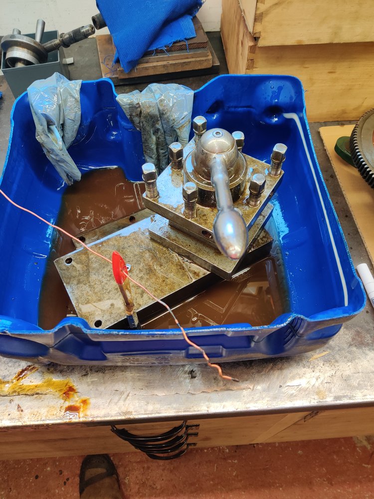

No fun in doing that, half the enjoyment of dismantling things is scrabbling about on your hands and knees with a torch looking for far flung parts.When it comes to disassembling it, have your hands inside a poly bag [clear if possible, like a big roasting bag] in case the 'pingfeckits' make a break for it - that way you've a chance of containing them.....![]()

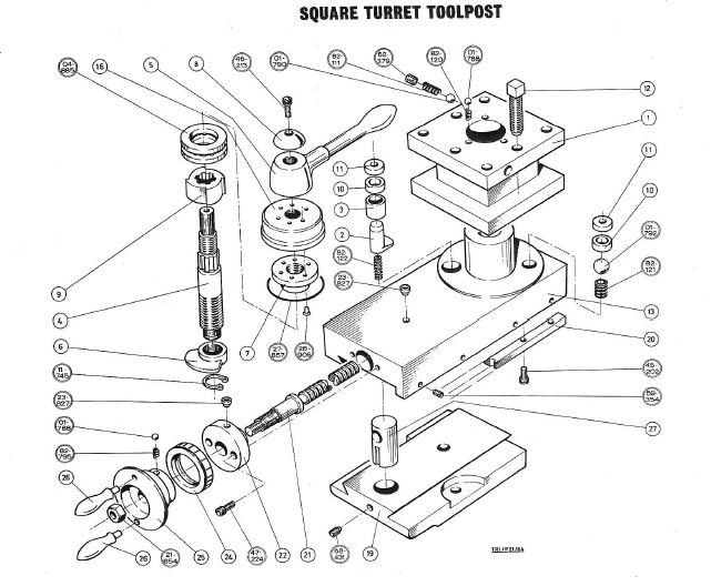

I see , may have a go at it tonight taking plenty of pics as I go for help later even with the diagram, but its easy to sort it later on once the lathe is running so not sure how far I will go with the striping tbh ill seeIt's not as bad as it looks tbh. The worst bit is getting the disk/cam thing (no. 6 I think) and the 4 lugged cam back on in the right place so it locks and unlocks/advances as it should.

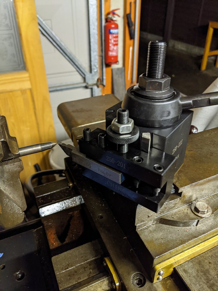

What lathe is that?Nice buy, mines missing the gap and I thought I'd made a mistake in buying it as it's my first but there is no overhang as munkul says. I've stuck a new wedge QCTP on it and will get around to sorting the rubbish paint out at some point in the next decadeView attachment 317269
